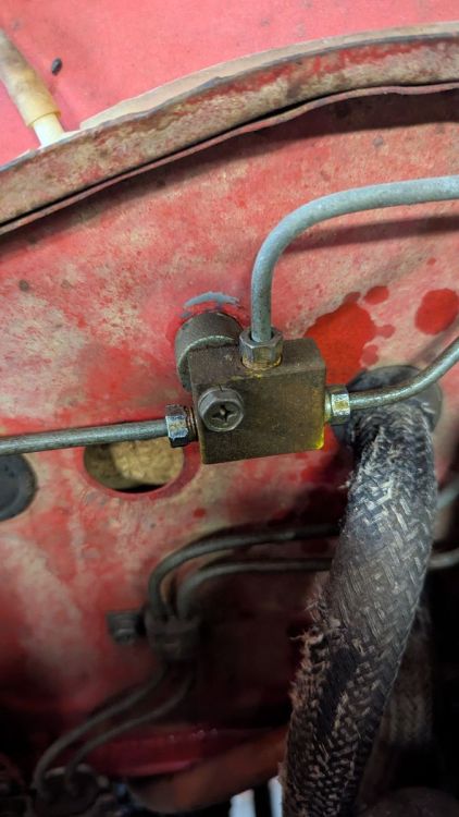

Additional things to consider:
1/  The rear circuit proportioning valve in the master cylinder must be replaced with a disc brake proportioning valve.
2/  Some form of emergency brake must be addressed.
