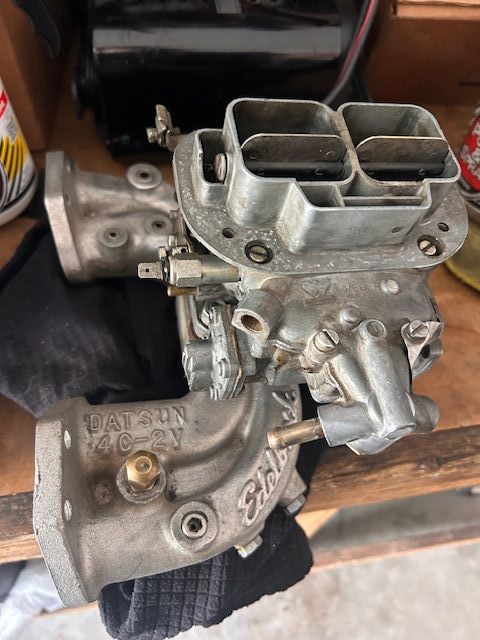

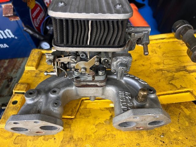

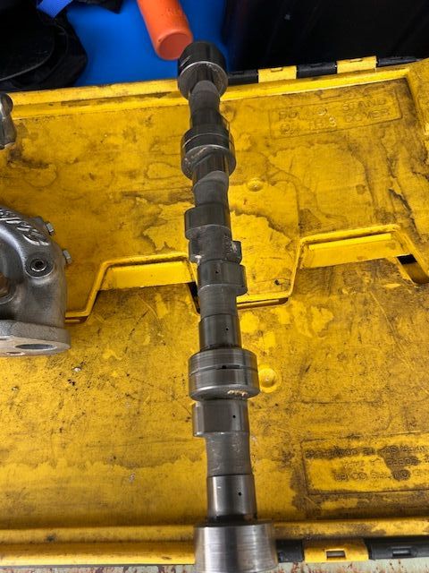

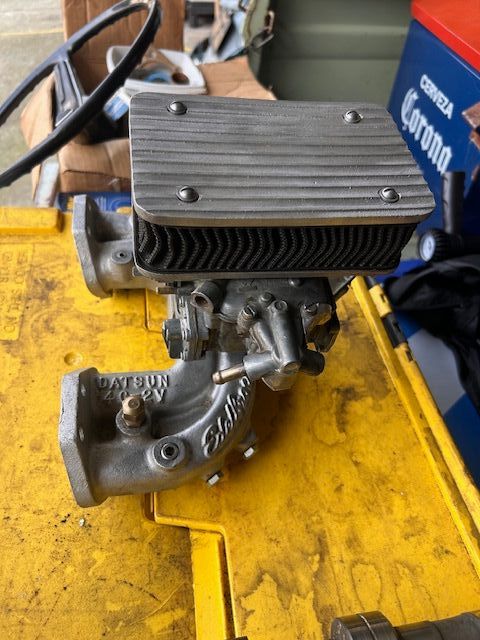

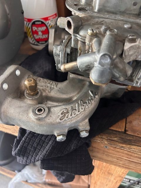

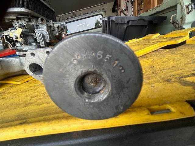

Well, my purchase of a 73 620 has re-ignited my interest in the old Datsuns. I went to my Uhaul storage truck and dug out some totes labelled "Datsun parts". I found my Edelbrock intake with a Weber 32/36 still mounted. I also found a W 53 head complete.I also found a camshaft with M651 stamped on the end. I purchased 2 camshafts years ago with a peanut head which went onto my 68 520 with a Shadbolt 445 grind. I am not sure what thw M651 camshaft is. Does anyone know??? I'm going to put the Edelbrock/Weber on my L16 in my 620, but is this cam a good option???

That's an L20-B cam and it's been reground for more lift. If it was an Isky it would say so. Shadbolt??? Colt? Comp Cams?
Edelbrock, interesting but not likely much better than stock.
Thanks Mike, I knew you would know!! I think the cam in my W53 head is the other Shadbolt I purchased with another one. I'm not hoping for much in horsepower gain, just wanted to use my Edelbrock for it's scarceness. Any idea where I could locate an electronic dizzy with a matchbox?? Thanks for your help.

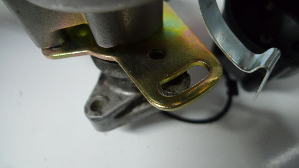

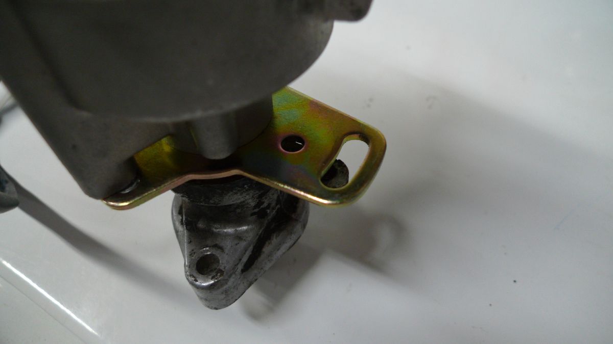

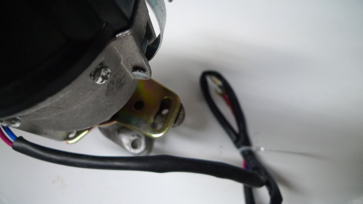

P1000972.thumb.JPG.1ae7112221a5234e1b88a06c948008e2.JPGP1000976.thumb.JPG.44e67f4ca006ca401c1c04d477e90870.JPGP1000971.thumb.JPG.b334822b4edd82172b88fb6652a4a7a1.JPGP1000972.thumb.JPG.7d2ad19828a27ae95bb58f6511d7bb92.JPGthose boursins only really work with a L20 dist mount. and might need to modify to get the TDC correct for the slot to be maybe regroved also.
there was soemobody on here to make universal plates for the L16 and later L18/20 versions to get the plate roight/
also the boursin its doesnt use a L16 or L20 cap. never did find out what cap it usues.
I have one of these as a sapre also.
But I use the point dizzys with the Pertronix and have stayed with them since I have a stack of dizzys to use up
