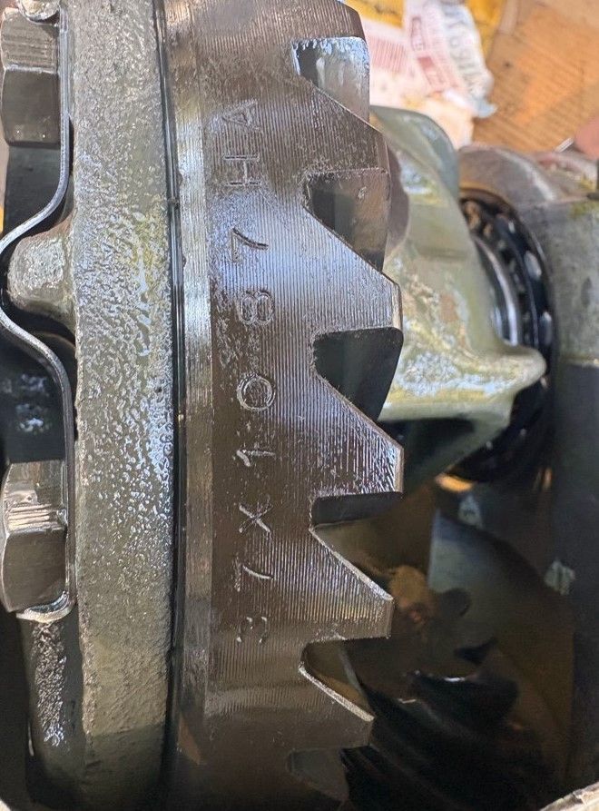

mtngoat Posted Thursday at 01:09 AM Author Report Posted Thursday at 01:09 AM (edited) The second brake adjuster was totally frozen and not enough threads showing to double nut the shaft. Had soaked the shaft in oil over night, did the vise grips trick, failed as usual. Then used a 1/4 socket with the drive end over the square bolt, to a 10mm hex bolt socket, then to 1/2 adapter, then breaker bar. Rounded the square shaft end. Gave up. We undid the adjuster retaining nuts, then used a wood block and kinetic persuader on the drum to simply force it off. Got lucky after a LOT of pounding, we finally got it to shift outwards and then got a bar under the hole in the drum to lever against the end of the axle stub. Thrilled to find the assembly had gear oil in it the entire time, and the gear teeth are perfect, no rust in there anywhere. Very little input backlash. It's pristine. And the cherry on top, it is in indeed the 3.7 ratio I'd hoped for. Now a gasket, and back together it goes. After cleaning up the axle housing. Weirdness: One side had one spacer/shim dealo under the stub retaining plate...the other had two. We paid attention to which side was which. What do those spacers do, exactly? Edited Thursday at 07:35 PM by mtngoat Quote

mtngoat Posted Thursday at 07:24 PM Author Report Posted Thursday at 07:24 PM (edited) Nope, roadster, silly! But the adjusters look identical, and of course, his problem persisted across all my 510s, and my one Z car. That welding a nut on trick is a good one. Edited Thursday at 07:25 PM by mtngoat Quote
