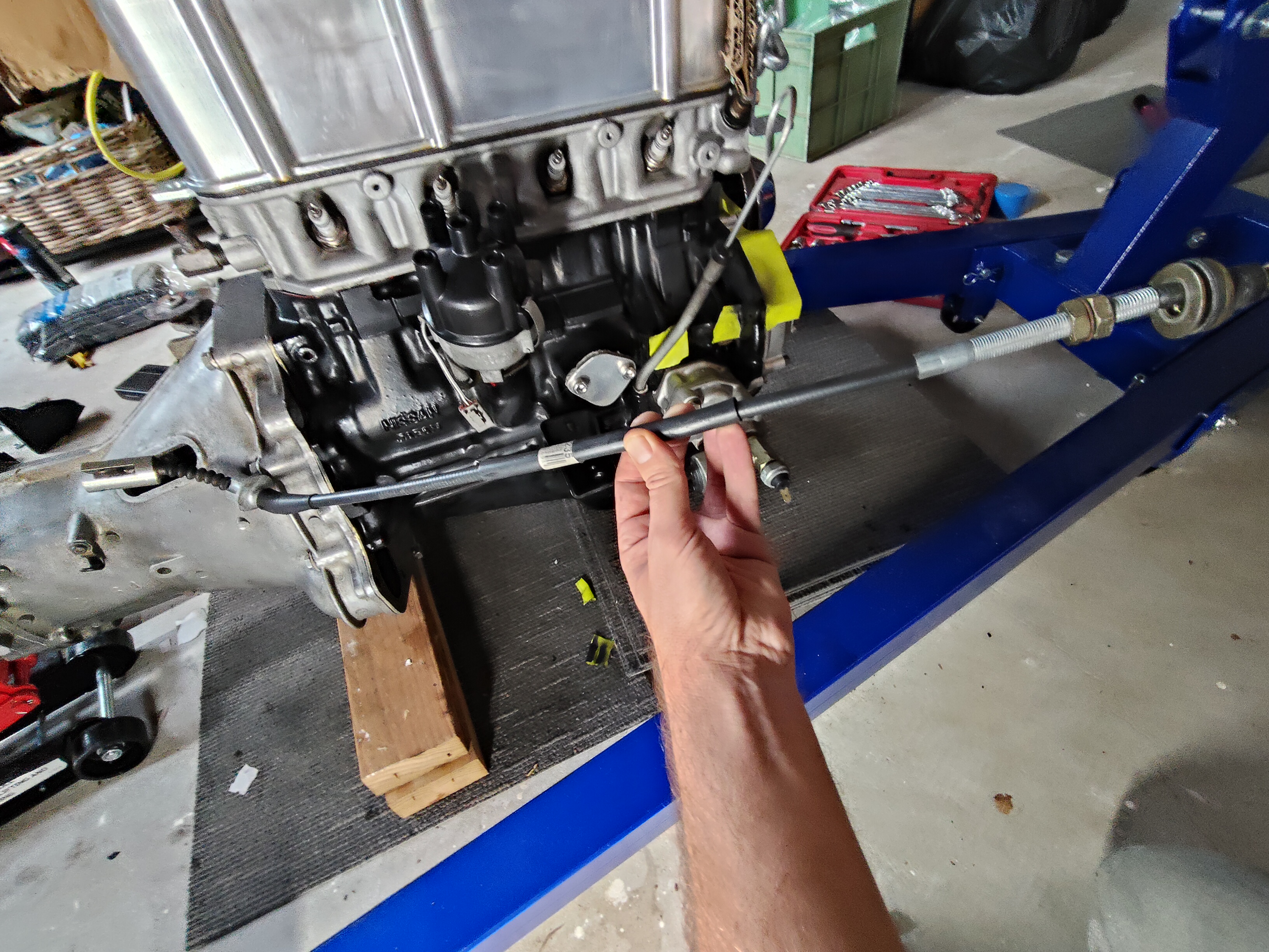

It's just a cable, from the way it hooks onto the clutch fork i assume it can only pull towards the engine?
Looks like from diagrams (below) the clutch fork is in a different position for the cable and therefore the pulling motion is transferred in the opposite direction as the pushing of the hydraulic slave cylinder.

The bearing sits on a 48mm sleeve, the sleeves held onto the clutch fork with a spring (that returns the sleeve). When you pull the fork towards the engine, the whole sleeve and bearing slides towards the clutch. I'm trying to explain something i don't entirely understand sorry.
Which all seems to be working fine, it's just a lot of freeplay and i don't know whats acceptable. I can't buy a longer sleeve, 48mm is what it previously ran and is also the largest sleeve available.
If the clutch arm attaches to the right side and the sleeve and bearing are in the middle, if you pull the left end forward by cable, then yes it would work.
The hydraulic clutch arm is like a see saw. If pushed back by the slave it transmits forward motion to the other end.

Yep, seesaw is a great analogy and exactly how I was imaging it, looks like from site it was a RHD thing only. The cache site loaded more pics today so I pasted another in which shows it on the transmission. Datsun1200.com still seems to be down though.
