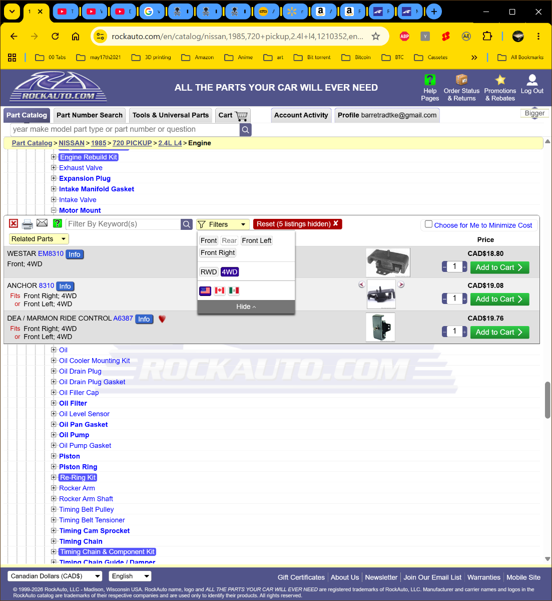

Doomedwalker Posted June 8 Report Share Posted June 8 i just got mine from rockauto... Quote Link to comment
ElliotV Posted June 8 Report Share Posted June 8 1 hour ago, Doomedwalker said: i just got mine from rockauto... Which brand did you buy and did they actually fit? The motor mounts have been a big issue on these trucks. Quote Link to comment
Smoking Joe Posted June 8 Author Report Share Posted June 8 I purchased mine via Summit, I don't recall the brand but I will check and report back. They did not fit but with minor modification I can and will be using them. I will get some pictures and details of what was required to make them fit and post that information for anyone that is curious. 2 Quote Link to comment
Doomedwalker Posted June 8 Report Share Posted June 8 2 hours ago, ElliotV said: Which brand did you buy and did they actually fit? The motor mounts have been a big issue on these trucks. i got Westar, i just 2 of the same one but i did have to shave the pin off one maybe the ones listed for left and right will be a better choice for you? 1 Quote Link to comment
ElliotV Posted June 9 Report Share Posted June 9 If you only had to shave one pin off that's a good deal I think 1 Quote Link to comment
