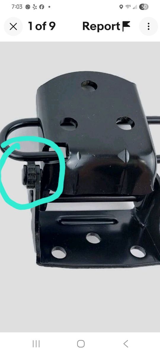

Thomas Perkins Posted May 22 Report Share Posted May 22 (edited) To fix your old hinges.See the star on them that holds the door in place when opened against the bar.To do this without removing them from the vehicle.Open door.Take tension off star by pushing door a little.While the star is not touching the bar.Move the star with a flat head screw driver till the stripped out part of the star is moved and the good part of the star is in place where it will grip the bar to hold it in place when door is opened.I did that with my passenger door long ago and is still doing good.I replaced the Driver side with a Nissan one when they had them in stock about 15 years ago.Dont buy used ones cause more than likely the star is striped out.I seen many used ones on Ebay that were.I do have a brand new set of Nissan ones that I wont part with.The left and right door dont use the same one's.Just the bottom hinges have the stars.Top hinges never go bad. Some stars will dig deep into the bar.Good to put a dab of grease on them to stop from squeaking.WD. dosen't work. I tried it and grease stops the noise.Put on star and other places.You may have to tap the screw driver with a hammer lightly to get star to move.Maybe wedge the door so it stays open and star is not touching the bar.Here is the star circled in the picture.See the bar above the star.Spraying star with WD-40 may help the star move to relocate it.Before I bought the new driver side one.I went cheap and bought some after market new ones and they didn't work.Got lucky back then and Nissan still had them in stock. I sent the after market ones back.I just found these used ones for sale.See the worn out star.It wont hold the door in place when opened. See how the star dug into the bar.Someone is going to get ripped off.lol Edited May 22 by Thomas Perkins Quote Link to comment

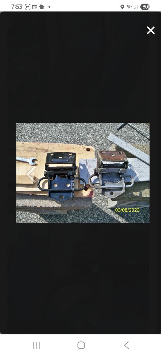

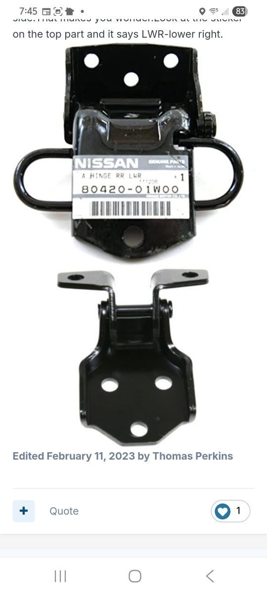

Thomas Perkins Posted May 23 Report Share Posted May 23 The stars on the bottom hinges are the only thing that goes bad on them.That is what keeps the door open when you open it.If they get stripped out,then the door wont stay open.The top one just holds the door to the frame,nothing else.The right hinge only fits the right door.Same as left hinge only fits left door.What are bushings?Post pictures of your's?The black one's in my pictures are exactly as Nissan one's. Quote Link to comment
Thomas Perkins Posted May 23 Report Share Posted May 23 9The stars on the bottom hinges are the only thing that goes bad on them.That is what keeps the door open when you open it.If they get stripped out,then the door wont stay open.The top one just holds the door to the frame,nothing else.The right hinge only fits the right door.Same as left hinge only fits left door.What are bushings?Post pictures of your's?The black one's in my pictures are exactly as Nissan one's. Quote Link to comment
Thomas Perkins Posted May 23 Report Share Posted May 23 (edited) Low and behold .I am wronger than shit.The right and left side fit both sides.I paid alot for my Nissan one's back in 2023.I have it posted on my page here.Not from Trump's Tariffs.The Nissan site just has the right side posted.Because they will fit either side. Edited May 23 by Thomas Perkins Quote Link to comment

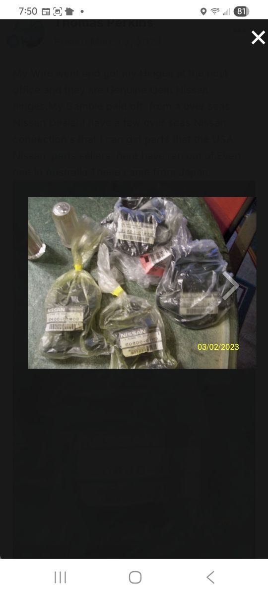

Thomas Perkins Posted May 23 Report Share Posted May 23 (edited) Here is what I paid for the Geniune Nissan 720 door hinges back in 2023.The bottom one's were 40.38 each.The top one'were 27.76 each.No taxes.Shipping was 56.23.Total was 192.51.I bet it is way more now if they still have some in stock. Edited May 23 by Thomas Perkins Quote Link to comment

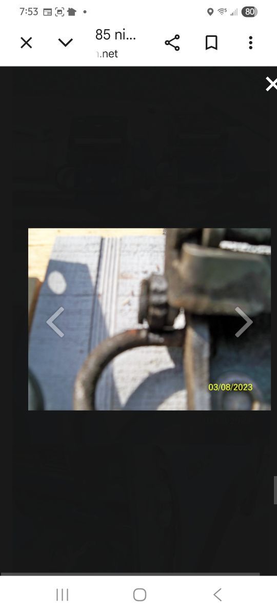

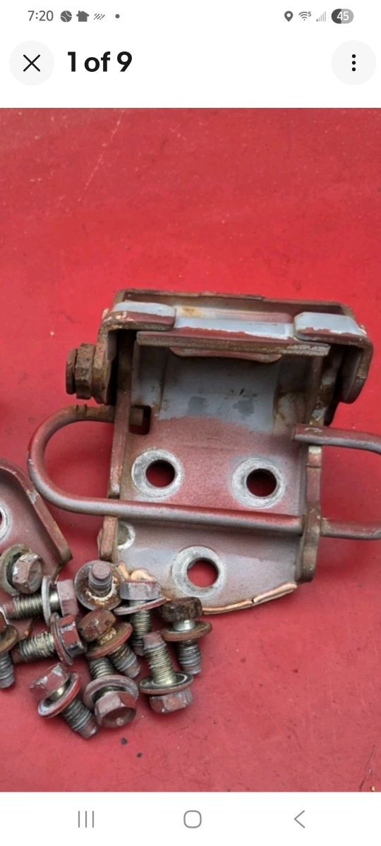

Thomas Perkins Posted May 23 Report Share Posted May 23 (edited) Back when I replaced mine.Look at the stripped out star. Edited May 23 by Thomas Perkins Quote Link to comment
