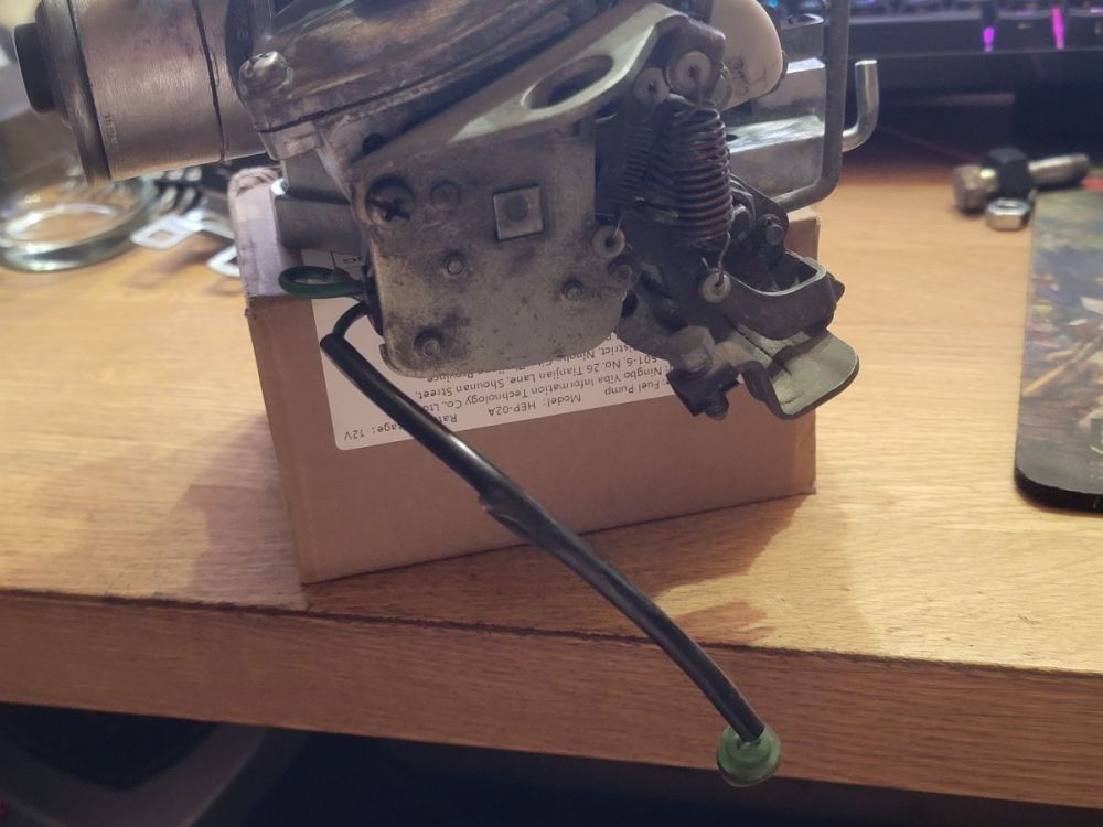

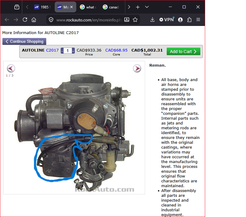

datzenmike Posted May 23 Report Share Posted May 23 Part if the F. I. C. D fast idle control device. It's missing, but mounts in the circular hole and increases idle speed when air conditioner is on Quote Link to comment
Doomedwalker Posted May 23 Author Report Share Posted May 23 12 minutes ago, datzenmike said: Part if the F. I. C. D fast idle control device. It's missing, but mounts in the circular hole and increases idle speed when air conditioner is on OK thanks, My truck doesn't have AC. i have one of those dash-pots came with my Trucks original Carburetor. Quote Link to comment
datzenmike Posted May 23 Report Share Posted May 23 Dash pots prevent sudden abrupt closing of the throttle on automatics which can cause stalling. 1 Quote Link to comment
Doomedwalker Posted May 23 Author Report Share Posted May 23 4 minutes ago, datzenmike said: Dash pots prevent sudden abrupt closing of the throttle on automatics which can cause stalling. yeah the truck used to be automatic. Quote Link to comment

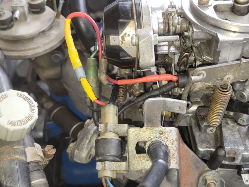

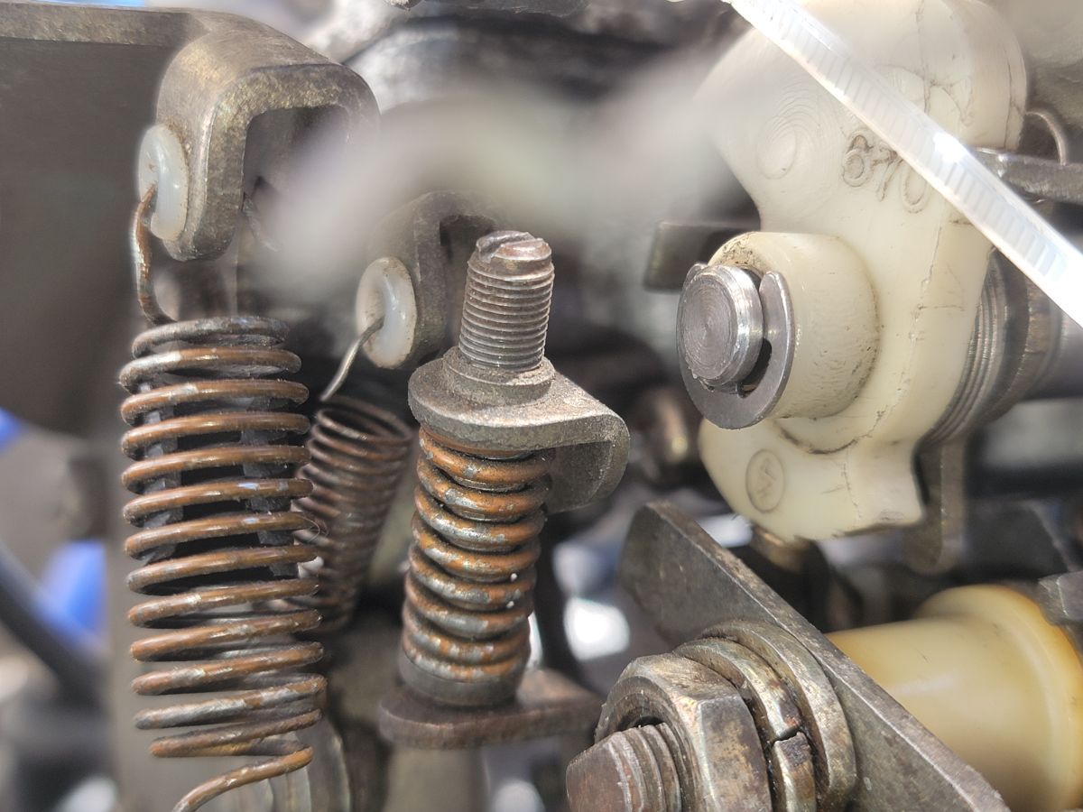

Sephakrid Posted June 2 Report Share Posted June 2 On 5/22/2026 at 12:06 PM, Doomedwalker said: i cannot afford anything much better, than 25 to 50 bucks where i sit financially, https://www.amazon.ca/Shkalacar-Narrowband-Volmeter-Modification-Accessories/dp/B0CND18DC1/ref=zg_bs_g_9163877011_d_sccl_41/139-4532569-6837822?th=1 also do you know what turning this with the big spring on it does? its not the hi idle. I believe that screw is for adjusting when the throttle switch activates. Sometimes after adjusting idle RPM, the throttle switch may activate either too early or not at all. Quote Link to comment
Doomedwalker Posted June 2 Author Report Share Posted June 2 44 minutes ago, Sephakrid said: I believe that screw is for adjusting when the throttle switch activates. Sometimes after adjusting idle RPM, the throttle switch may activate either too early or not at all. i think mike has the right answer, i am pretty sure its useless on my truck as i dont have AC. Quote Link to comment
