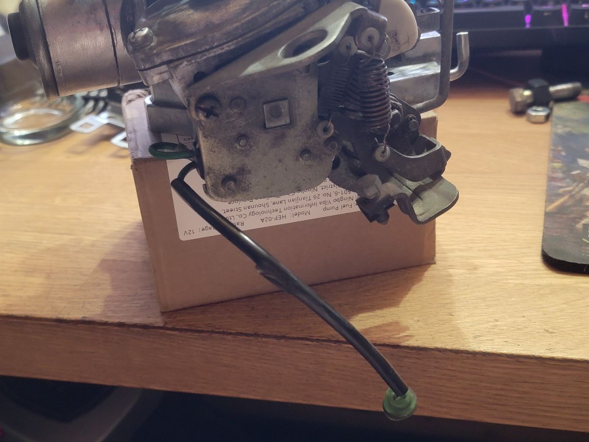

Doomedwalker Posted May 21 Report Share Posted May 21 (edited) there is no Sensor or wire from the harness where one would be so i was wondering if its something this truck would of had with only a 3 wire feedback carb? Edited May 22 by Doomedwalker Quote Link to comment
datzenmike Posted May 21 Report Share Posted May 21 The '3 wire' carburetor is not a feedback carburetor. Feedback or ECC carburetors had a round 6 wire plug, an 02 sensor and an ECU to run the carburetor mounted under the driver's seat. Quote Link to comment
Doomedwalker Posted May 21 Author Report Share Posted May 21 36 minutes ago, datzenmike said: The '3 wire' carburetor is not a feedback carburetor. Feedback or ECC carburetors had a round 6 wire plug, an 02 sensor and an ECU to run the carburetor mounted under the driver's seat. Shoot i thought it was a feedback one, Ok, You would think BC would of required an O2 sensor. Guess ill just get am aftermarket afr gauge and O2 sensor. Quote Link to comment
datzenmike Posted May 22 Report Share Posted May 22 The ECC carburetor was a California emissions requirement. It was likely used in other states that requires emissions testing. Did we get it in Canada? I think so, possibly, maybe an option. It's a half way between carburetor and EFI. The primary jet is actually a solenoid that opens and closes many times a second to meter fuel. Once warmed up the O2 sensor goes into closed loop and adjusts the solenoid to closely maintain a stoichiometric air fuel ratio for low emissions and good mileage. It does not work at idle (obviously) and at full throttle so performance is not affected. Because the solenoid theoretically could cause a severe lean mixture, if there is a failure, the system reverts to a 'limp home' mode and forces an over rich condition to protect the engine. If you had an ECC and your mileage suddenly dropped, this is probably why. Quote Link to comment
Doomedwalker Posted May 22 Author Report Share Posted May 22 1 hour ago, datzenmike said: The ECC carburetor was a California emissions requirement. It was likely used in other states that requires emissions testing. Did we get it in Canada? I think so, possibly, maybe an option. It's a half way between carburetor and EFI. The primary jet is actually a solenoid that opens and closes many times a second to meter fuel. Once warmed up the O2 sensor goes into closed loop and adjusts the solenoid to closely maintain a stoichiometric air fuel ratio for low emissions and good mileage. It does not work at idle (obviously) and at full throttle so performance is not affected. Because the solenoid theoretically could cause a severe lean mixture, if there is a failure, the system reverts to a 'limp home' mode and forces an over rich condition to protect the engine. If you had an ECC and your mileage suddenly dropped, this is probably why. Yes i got in canada i am from alberta, the engine and transmission are from my uncles old 85 used to be from Chiliwack BC, i have in Alberta. I dont know if it had an ecc, but there was a computer under the drivers seat, its different than the computer that used to be in it from before the manual swap. There is no oem place for a O2 sensor. Quote Link to comment

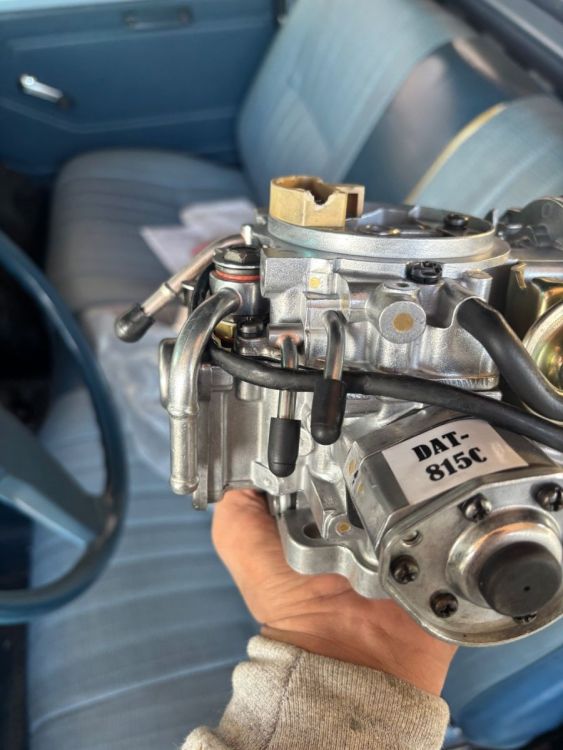

datzenmike Posted May 22 Report Share Posted May 22 I doubt if the engine harness was swapped so probably stock carburetor. ECC carburetor. Note round connector and 6 wires. There is a small harness of wires to the solenoid at the front under that light plastic thing... Here are the wires involved... 1 Quote Link to comment

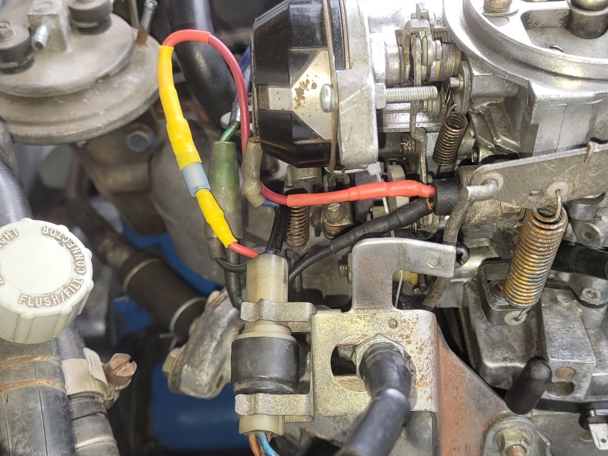

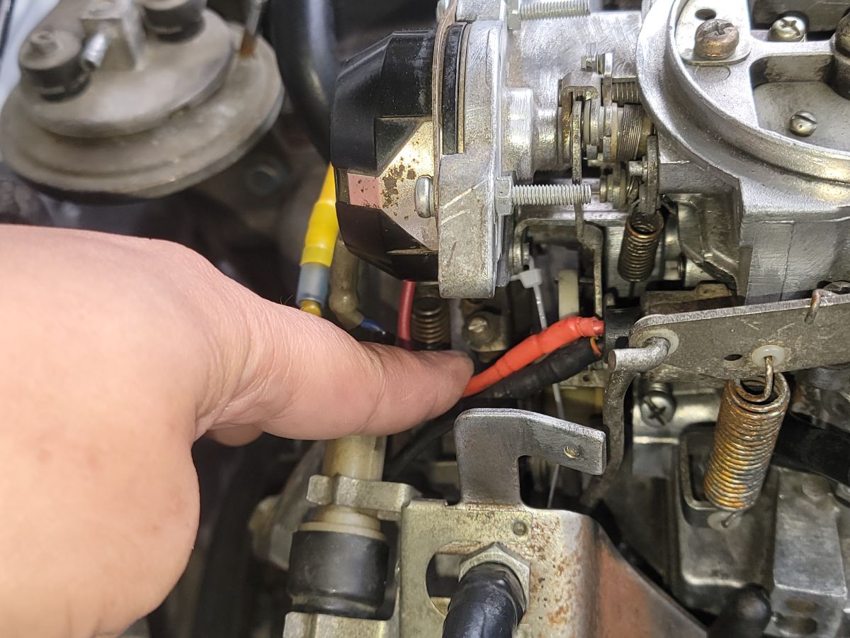

datzenmike Posted May 22 Report Share Posted May 22 Left is stock exhaust. Right has the O2 sensor with green wire in it. Three wires... choke and power and ground for the idle cut solenoid. 1 Quote Link to comment

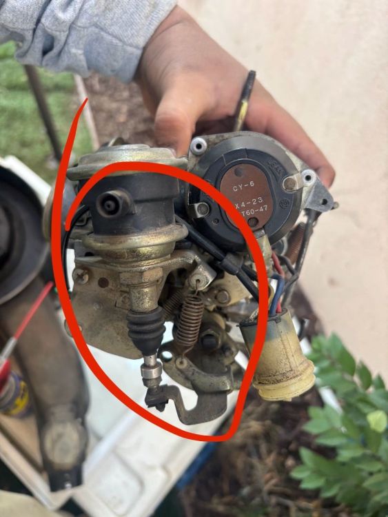

Doomedwalker Posted May 23 Author Report Share Posted May 23 2 hours ago, datzenmike said: Left is stock exhaust. Right has the O2 sensor with green wire in it. Three wires... choke and power and ground for the idle cut solenoid. yeah i got the first one. what does the part i circled in blue do? Quote Link to comment
