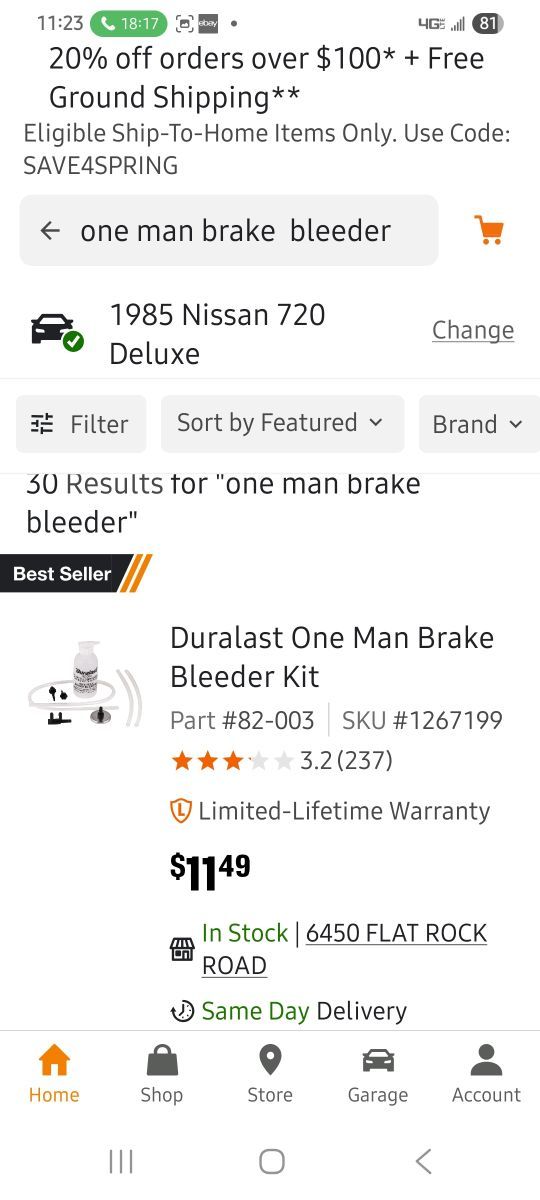

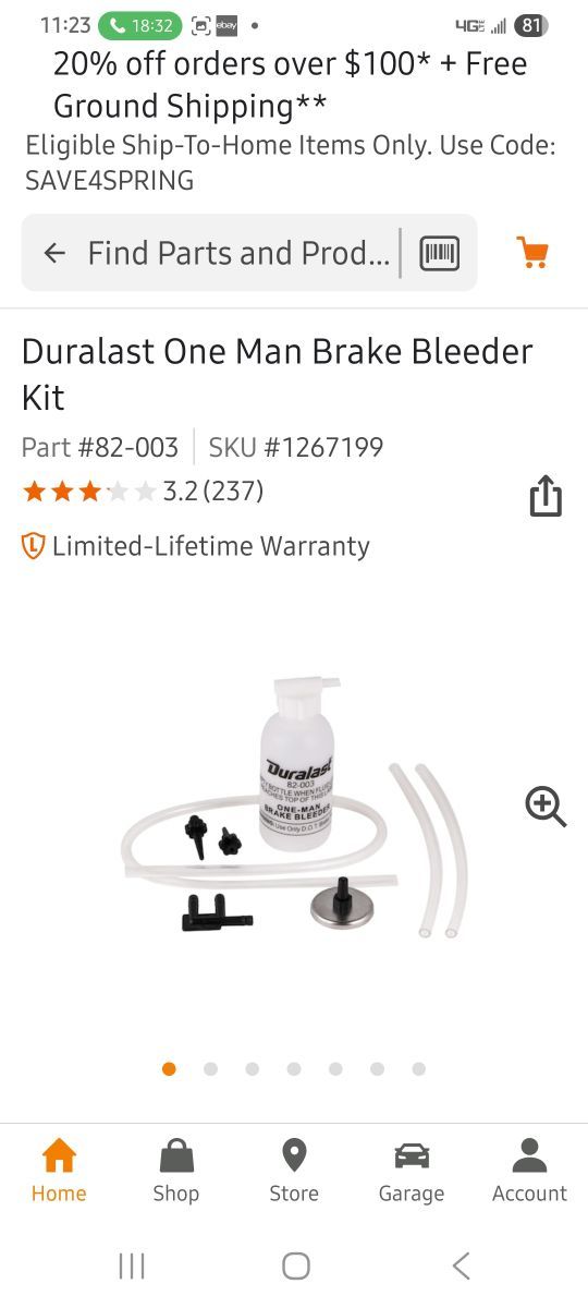

I use a one man bleeder kit from Auto Zone.Air cant get back in it using it.Great for slave cylinder too.I dont use the black pieces.I just put the hose over the fittings.The little container has a magnet on it.Cant go wrong with this?Has a lifetime warranty
