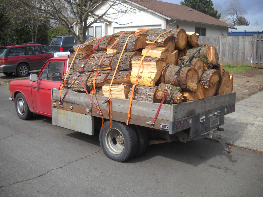

wayno Posted May 11 Report Share Posted May 11 (edited) Everything depends on what gearing the C200 dually axle has, most of the dually axles I have seen have 4.37 gears(I had these gears for several years), but I changed to 4.62 gears in my work truck with a LZ23 engine, I use 5th gear all the time, my rolling weight was 6000lbs+, the truck weighed 3900lbs empty, the trailer with all my equipment weighed more than 2000lbs, when I did a pressure washing job and filled my flatbed with wet moss I was over 8000lbs of rolling weight, wet moss weighs a lot. Sometimes I did not move that fast and had to drop gears on hills, but I used that truck for years that way, I even had air bags I filled when I went for firewood. The C200 dually axle is capable of having 4 different gear ratios, 4,8, 4.6, 4.3, and 4.1, the C200 axles in the 4wd trucks and dually axles had all them gears between them, I learned this from the Nissan parts guy in Portland OR. Keep in mind that brake stuff is getting harder to find now for the dually axle, I bought the last two dually axle drums in the USA several years ago, the parts guy called me one day and told me a second dually axle drum arrived, he seemed surprised. Edited May 11 by wayno 1 Quote Link to comment
