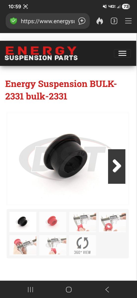

Try looking at energy suspension for universal fit... and look it up by size...

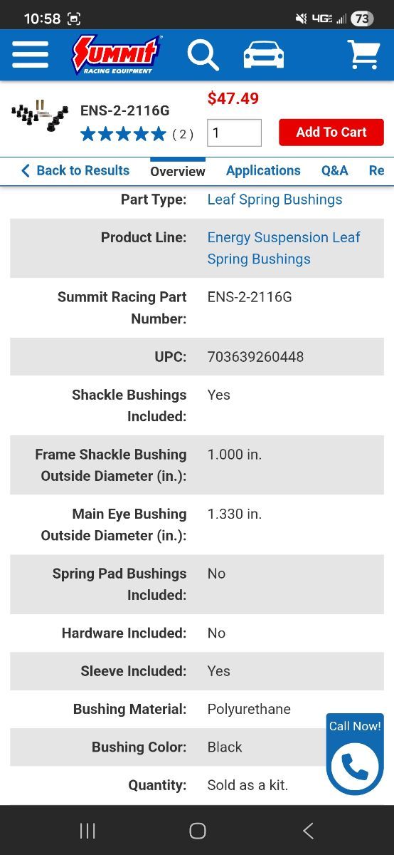

By the number i think it says on your caliper it looks like 1.325/1.330..

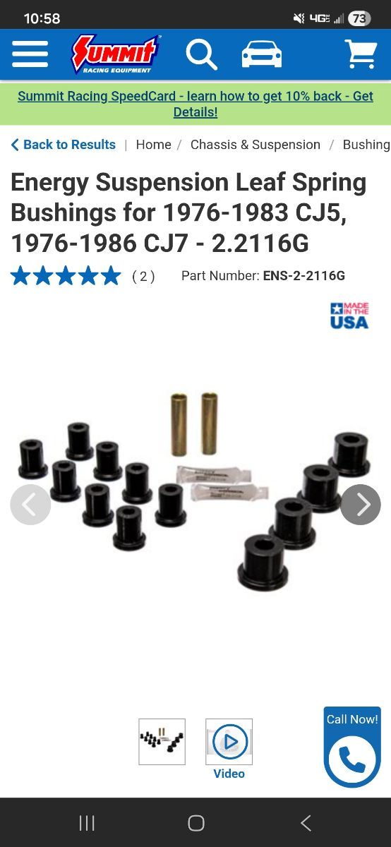

I found jeep ones at 1.330...
You'd only be using half the kit....
Screenshot_20260430_105822_DuckDuckGo.thumb.jpg.60064107abc16552cc16d563a1611c5b.jpgScreenshot_20260430_105835_DuckDuckGo.thumb.jpg.48bfbd66601eefa737605e7ba1463936.jpg
not sure the bolt size if these would work...
Also the universal ones from energy suspension...
These are 1.325 od....
Same deal witht the bolt... might need to get sleeve to adapt the inner size to the bolt...

Thanks for the help! I'll look into the jeep bushings. I think also I saw someone say that the 720 rear bushings are the same size as the 78/79 rears. I'll probably just go with the jeep stuff to be safe
