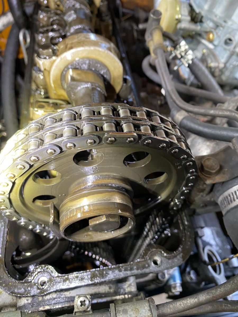

Mitchell Posted May 17 Author Report Share Posted May 17 (edited) Here are the timing verification photos, It runs, starts easily but won't rev still. Checking with a timing light, While idling at 750 rpm, I don't have enough adjustment on the distributor to advance the timing it's limited to about 5 degrees ATDC with the the plate bolt loosened and clocked all the way. Before I drop the pump, would changing the cam pulley to position number 1 or 3 help? I removed the distributor bolt and temporarily clamped the base to gain a little more advance but still not enough but does improve a little. I also tried clocking the wires both directions, still not enough adjustment. Cam looks correct, at 10 degrees static timing, pulley aligns with 2 on mark with both valves closed...? Distributor drive looks correct, small side left at 11:25...? Timing Mark on pulley at about 10 degrees, photo is a little blurred but mark is in silver paint area about in the middle...? Distributor Rotor facing rearward on number 1... Edited May 17 by Mitchell Quote Link to comment

datzenmike Posted May 17 Report Share Posted May 17 The mark on the pulley must be aligned with the ZERO on the timing scale. It's important to turn the pulley clockwise up to and stop on the ZERO. If you over shoot back up 1/4 turn and do again. You must NOT back up to the line to set TDC, it must be only clockwise. If you reverse to TDC you will intruduce chain slack Now look at the notch on back of the cam sprocket and the horizontal line behind it. Notch should be just below the line and possibly slightly to the right. If so the cam is properly timed. If at TDC the rotor direction doesn't really matter much as long as the rotor tip is under one of the wires on the cap. This wire now becomes #1 and the others are counter clockwise #3 #4 and #2. Timing is 12 0 BEFORE TDC NOT 5 0 AFTER!!!!!!!!! Quote Link to comment

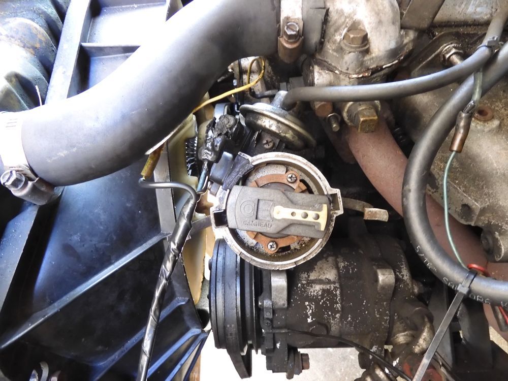

Mitchell Posted May 17 Author Report Share Posted May 17 (edited) Thank you all for replying. This is the original distributor and pedestal that is just like the 3rd one on the right in the photo that came with the truck and has over 100 thousand miles that I've put on it. I've never changed the pedestal. I did send another L20b matchbox of unknown condition to be rebuilt by Jeff at Advanced. I bought it from AbcUsedParts Recyclers but did not receive the pedestal with it though. The accelerator pump does work with the new carb. The photo of the Cam is with both the intake and exhaust cams in the up position as shown more clearly in wayno's photo, at 10 and 2. I use a starter trigger button on the starter to position the crank pulley and so it only turns the crank clockwise and when I overshoot I just go around twice to get it right. I'll take another set of pics with the crank pulley exactly on 0. This is a closeup of where the crank pulley was... Edited May 17 by Mitchell Quote Link to comment

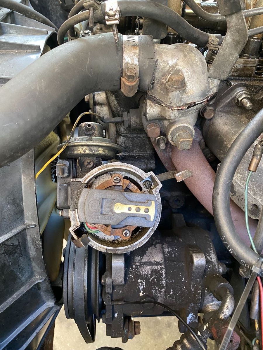

Mitchell Posted May 18 Author Report Share Posted May 18 (edited) Finally SOLVED!!! Here are the timing photos at 0 degrees... Crankshaft Pulley Position >>> Camshaft Timing Gear Alignment Position >>> Camshaft 10 and 2 Position >>> Distributor Drive Position >>> Distributor Rotor Position >>> So after checking the timing, had the same result with the original distributor having a low rev maximum. So I went ahead and installed the newly rebuilt distributor I received today from Jeff at Advanced Distributors and It started right up and NOW runs better than before all this occurred on April 13th. Timing is now at 15 degrees BTDC. So apparently a weak accelerator pump combined with a faulty distributor were the causes. Thanks to all who helped solve both of these problems! Edited May 18 by Mitchell 1 Quote Link to comment
