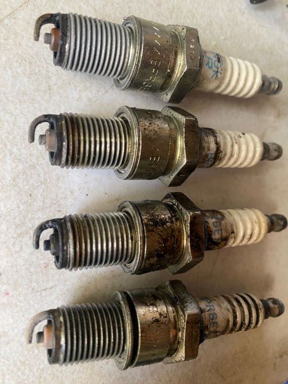

Mitchell Posted May 3 Author Report Share Posted May 3 (edited) Sorry for no updates, I've had a few things come up all at once and couldn't work on it. Today, checked valve lash and found number 4, exhaust was too tight, but all others measured fine as well as all rockers, all look normal. Went ahead and put a fresh set of plugs in and tried it and had the best result so far, it fired 2-3 cylinders and not again. Definitely getting gas into the carb and to the plugs. Checked the spark again and it still looks weak, more orangish and never bluish as I think it should be and fires spark that to me appears unevenly meaning one firing fatter than other weaker smaller firings that follow, then randomly another fatter firing and repeats inconsistently. I had also added an extra ground from the matchbox distributor body to the cylinder head, with no change. So I purchased a points dizzy remanufactured from rock auto and I'm going to try the ignitor II setup since I've got a new flamethrower 0.6 coil spare on hand that I'll use with it. Edited May 3 by Mitchell Quote Link to comment

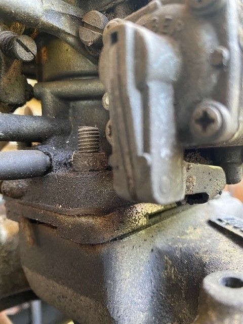

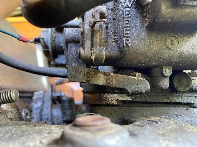

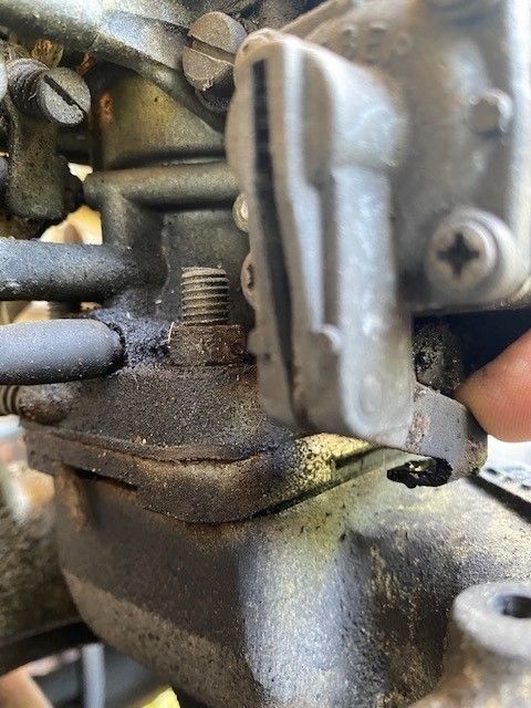

Mitchell Posted May 7 Author Report Share Posted May 7 (edited) Good morning, The carburetor linkage is operating correctly, primary butterfly opens for the first half of applying throttle and at about 3/4 throttle the secondary butterfly engages and opens gradually. I cranked the engine about a dozen times and then checked for the squirt of fuel into the primary and could only see fuel dribble into the primary and almost nothing, only an occasional drip of fuel into the secondary at full throttle position. After testing for squirt, checked if it still runs and it started right up on only a half crank. Stills idles okay, smoothly at about 1000 rpm for as long as needed, but will not rev past 2100 rpm if I hold down the throttle too far the engine won't stall but will pop, possibly from too much air and not enough fuel? Tried pumping the pedal while it's running to see if I could get some more fuel to gain rpm but won't pass 2100. After the 5 minutes of 1000 rpm running I checked for squirt again and no change other than the electric choke operates as it should and remained open with the engine warmed up. The new carb is supposed to get here Monday... Edited May 7 by Mitchell Quote Link to comment
banzai510(hainz) Posted May 7 Report Share Posted May 7 (edited) 6 hours ago, Mitchell said: The carburetor linkage is operating correctly, primary butterfly opens for the first half of applying throttle and at about 3/4 throttle the secondary butterfly engages and opens gradually. this is normal 6 hours ago, Mitchell said: checked for the squirt of fuel into the primary and could only see fuel dribble Its should squirt/SHOOT a steam of gas when the linkage is cycled(like giving it gas). read carefully. IF NO gas squirting then this is a proplem. whchi should have been caust on 1 st page.. LOOK at the accell pump diaphrame. r look at the level and you can see it push the diaphrame. you can remove the diaphrame and check or check for lever movement which you did not anwser back if you check this 6 hours ago, Mitchell said: not rev past 2100 rpm if I hold down the throttle too far the engine won't stall but will pop, possibly from too much air and not enough fuel? make sure the 2nd barrel doesnt open. there is a spring that keeps this shut untill the mechanism open it. there is a spring that make sure its closed untill the mechinism opens it. If spring is gone it wont rev up and bogs it down with too much air cause not sucking gas thru the jets Now I willl repaeat did you see if the accel pump arm inside the accel pump diaphram is stuck or not??????? since im not a MIND READER. I told know if this the orginal distributor then put in 180 off and or another dist with mount with a different matchbos with the 15 offset mount. Make sure the motor when timed can go from 0- 25 deg BTDC. IF this is hard cranked one way to get the timing to say 7-10 then maybe this can be a issue you running out of time. I usually see this if the oil pump is off a tooth. it will run but run out of time This is a EZ . and dont think you need a NEW carb. just fix the accel pump issue. maybe as last resort could be clogged main jet at bottom of bowl. But you can ck the fuel filter if its bad. Edited May 7 by banzai510(hainz) Quote Link to comment
banzai510(hainz) Posted May 7 Report Share Posted May 7 look at number 34. you see a slot in the accel pump. this can get stuck in the push in mode. https://images.search.yahoo.com/search/images;_ylt=Awr.1Zua7PxpKgIAbe5XNyoA;_ylu=Y29sbwNncTEEcG9zAzEEdnRpZAMEc2VjA3Nj?fp=1&p=weber+carburetor+32%2F36+diagram&fr=yfp-t&th=474&tw=474&imgurl=https%3A%2F%2Fwww.carburetion.com%2FWeber%2Fblowups%2F3236dgva.jpg&rurl=https%3A%2F%2Fwww.carburetion.com%2Fdiags%2F3236DGVDiaginfo.asp&size=76KB&name=Weber+32%2F36+DGV+Diagram&oid=5&h=600&w=600&turl=https%3A%2F%2Ftse1.mm.bing.net%2Fth%2Fid%2FOIP.aANS5gr9dcv_i6Mrku8zKwHaHa%3Fpid%3DApi&tt=Weber+32%2F36+DGV+Diagram&sigr=ZWOYnF2VBEhB&sigit=khXRvPswtHXB&sigi=Y6NJpldXuLSL&sign=E_0.jnFoWYHn&sigt=E_0.jnFoWYHn Quote Link to comment
datzenmike Posted May 7 Report Share Posted May 7 The squirt from the accelerator pump is only there to help transition from idle circuit to primary circuit. If you drive off slow enough you don't even need it. It does not stop you from revving up. Quote Link to comment
