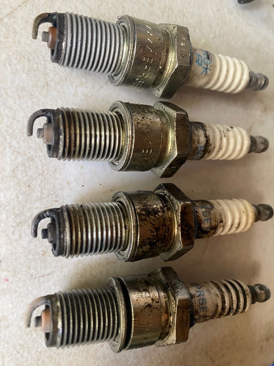

Mitchell Posted April 21 Author Report Share Posted April 21 (edited) Hey Mike, thanks so much for responding. I didn’t clean them up but they looked dried up from yesterday, in the photo 1 is on the bottom and is the only plug that looks good… I’m glad to hear it’s unlikely that the chain jumped. Edited April 21 by Mitchell Wrong photo Quote Link to comment
banzai510(hainz) Posted April 21 Report Share Posted April 21 (edited) weird how #1 is 165. #1 looks cleaner hope it isnt sucking any water. I air out the plugs. Pull the valve cover off and turn so cam lobes are up and make sure the rockers wiggle. you sure you gotr spark? Gas squirting in the carb? Choke not stuck open idle jet clean? Edited April 21 by banzai510(hainz) Quote Link to comment
Mitchell Posted April 21 Author Report Share Posted April 21 it is strange, but it matches with the best burn colored plug so might be that my gauge read the 1st cylinder on the high side from not being used in a while Quote Link to comment
