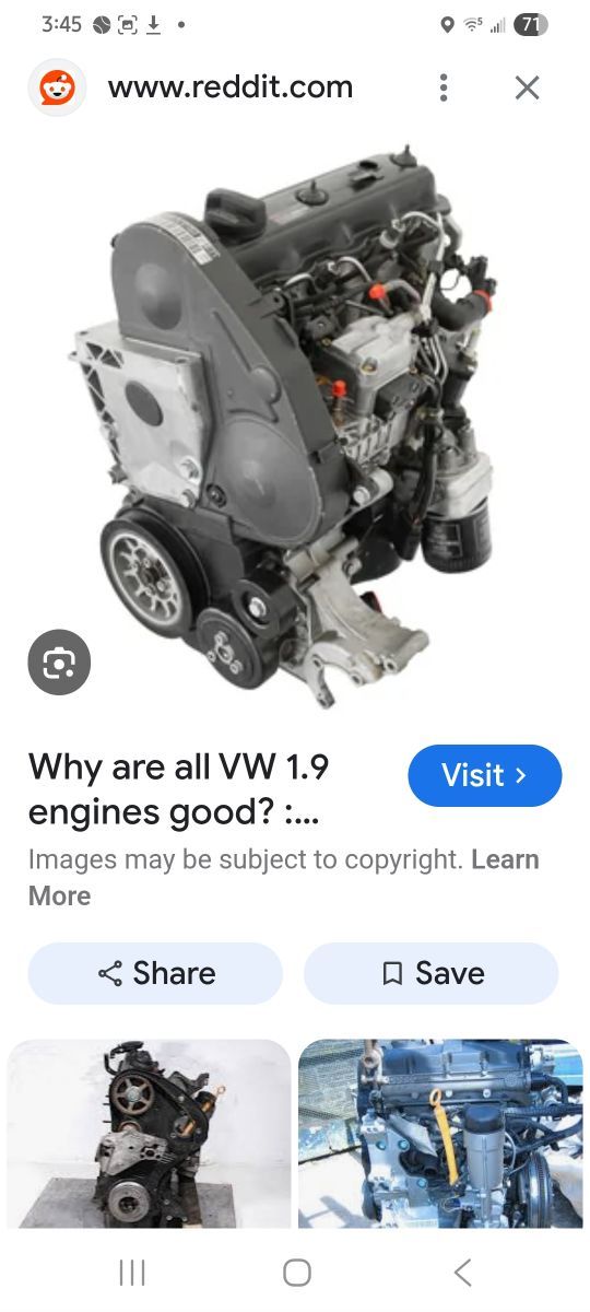

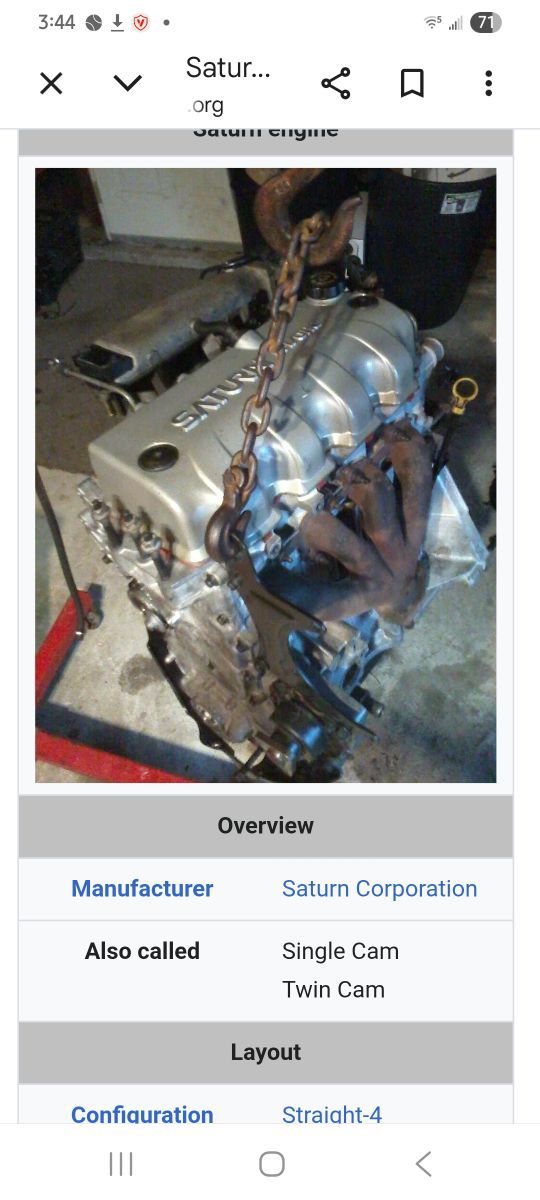

Thomas Perkins Posted May 3 Report Share Posted May 3 The 1.9L I4 (inline-four) engine refers primarily to two distinct, highly regarded powerplants: the legendary Volkswagen 1.9 TDI diesel known for extreme longevity (300k+ miles), and the Saturn 1.9L gasoline engine used in S-Series cars (1991–2002). These engines are known for efficiency, with the VW diesel commonly used in Golf/Jetta models. Quote Link to comment
Thomas Perkins Posted May 3 Report Share Posted May 3 So you may be in a vw bug.Kewl.Saturns are kewl too. Quote Link to comment

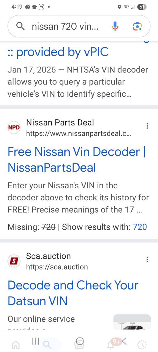

Thomas Perkins Posted May 3 Report Share Posted May 3 (edited) Nissan 720 VIN decoder.This site will tell you your engine size and year..Just went there on mine.That is all they tell you and they wont money to do more. Edited May 3 by Thomas Perkins Quote Link to comment
datzenmike Posted May 3 Report Share Posted May 3 If the second letter on the MODEL line was an F that would be the Z20(s) engine, and that was only on the mileage Option truck. Quote Link to comment
Thomas Perkins Posted May 3 Report Share Posted May 3 Just went to Nissan psrsdela.com and they tell you if it is a5x4 or 2wd and how many doors. Quote Link to comment

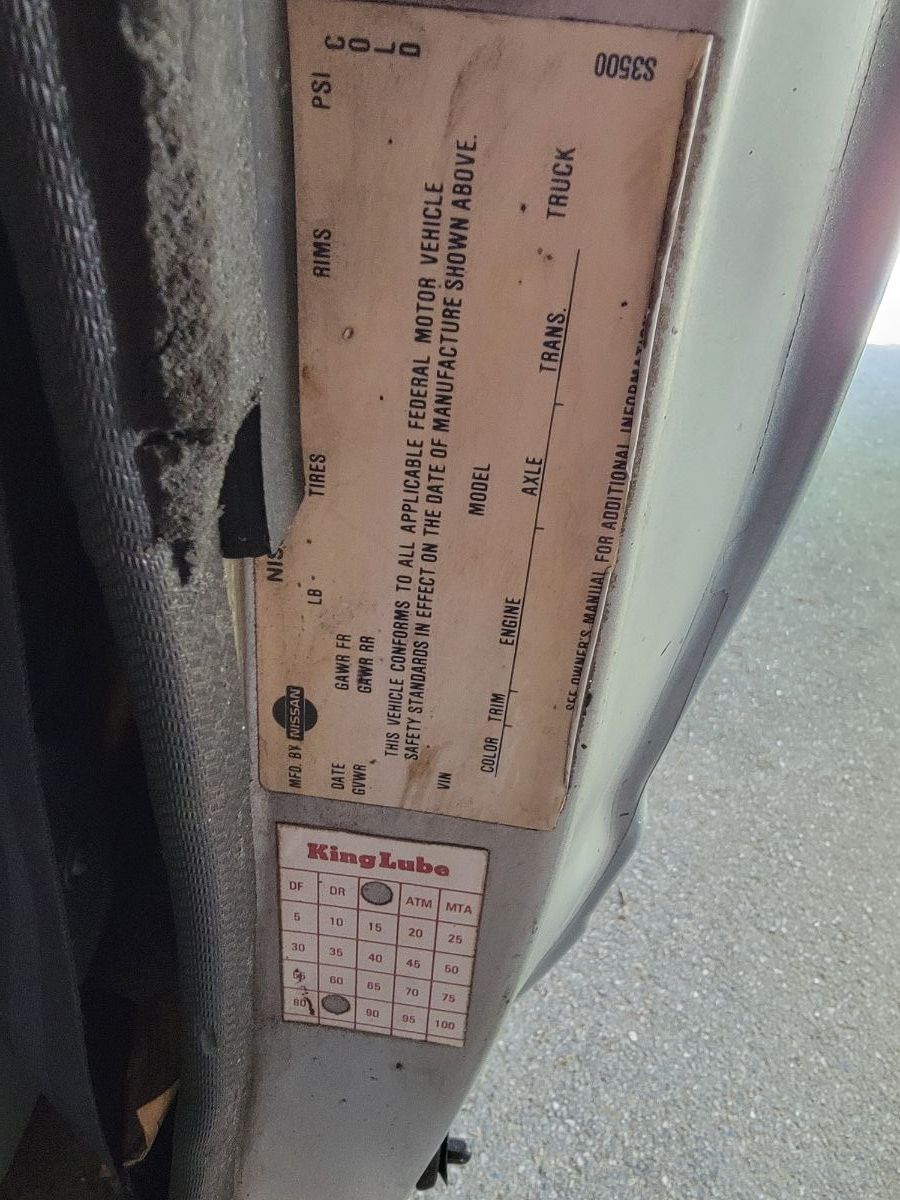

Thomas Perkins Posted May 3 Report Share Posted May 3 Mike.Mine had the paper one on my door and it is gone.I think the metal plates were from Japan made Nissans and paper one's made in Tennessee like mine. Quote Link to comment
Thomas Perkins Posted May 3 Report Share Posted May 3 Paper vs. Metal: Yes, some Nissan 720s used a paper or foil-like sticker/decal for their identification plates, specifically on the door jamb.Metal Data Plate: Trucks also feature a stamped metal data plate located on the passenger side inner fender in the engine bay. Quote Link to comment
Thomas Perkins Posted May 3 Report Share Posted May 3 2. The Metal Chassis Stamp (On the Frame)Because the paper tags often degraded or were lost, Nissan always permanently stamped the VIN into the chassis.Location: Passenger-side frame rail.Specific Spot: Look on the very top of the frame rail, just forward of the engine mount. Use a wire brush if it is covered by dirt or rust.3. The Dashboard Tag Quote Link to comment
Thomas Perkins Posted May 3 Report Share Posted May 3 (edited) Here is mine.All the writing is gone.Even has the king lube sticker from the year it was made in 85.It had all the ink on it when I got it in 94.All gone now.Just like Auto Zone's receipts.The ink on them disappears.Best now to take pictures of them.Oriellys is bad out erasing there computers and telling you your warranty is no good cause they have no record on it.They tried it on me but I had the receipt. I even have a lifetime warranty on my Rancho 5000 shocks I bought from them over 20 years ago. Edited May 3 by Thomas Perkins Quote Link to comment

Blue720 Posted May 4 Author Report Share Posted May 4 Failed. The one I was provided is a bigger part, won't even bolt in. Went to a parts store out there and they came up with the same thing, but it's clearly not the right one. All of his x-refs weren't even close. My sticker in the door jam says JN6ND06Y manufactured 3/84 Quote Link to comment

datzenmike Posted May 4 Report Share Posted May 4 8 minutes ago, Blue720 said: Failed. The one I was provided is a bigger part, won't even bolt in. Went to a parts store out there and they came up with the same thing, but it's clearly not the right one. All of his x-refs weren't even close. My sticker in the door jam says JN6ND06Y manufactured 3/84 10th VIN digit would be an E for '84 model year Quote Link to comment
Blue720 Posted May 4 Author Report Share Posted May 4 5 minutes ago, datzenmike said: 10th VIN digit would be an E for '84 model year not sure where the rest of the VIN is. The sticker only shows those 8 digits. Took a picture of it, but don't know how to post it Quote Link to comment
datzenmike Posted May 4 Report Share Posted May 4 Isn't the VIN on top of dash, driver's side close to the glass??? Quote Link to comment
Blue720 Posted May 5 Author Report Share Posted May 5 33 minutes ago, datzenmike said: Isn't the VIN on top of dash, driver's side close to the glass??? I didn't see it there, so I looked in the door jam and found a sticker. I should have grabbed the registration, but I didn't Quote Link to comment
