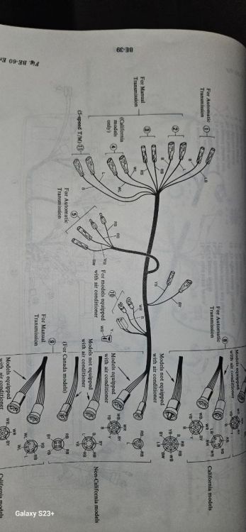

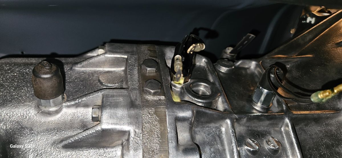

lil Hustler 620 Posted March 15 Report Share Posted March 15 Good morning all, I was wondering if anybody knew what order (names) of these switches are.Starting from the front of the transmission to the rear. The switch without wires would be the backside of the 5 speed. Quote Link to comment

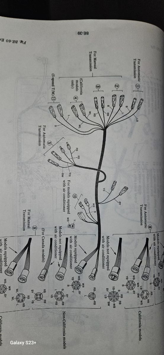

lil Hustler 620 Posted March 15 Author Report Share Posted March 15 I have this diagram but I'm not sure what order they go in from front to back. Quote Link to comment
datzenmike Posted March 15 Report Share Posted March 15 Left (rear) to right... 5th, 4th, reverse. 4th can also be caller top gear as well as 5th, which is over drive. 4th and 5th are used by the emissions system. There should be a neutral switch just forward of the shifter. This is used by the fuel shut off system to know if you are in gear to operate or if in neutral to shut it off. Quote Link to comment
