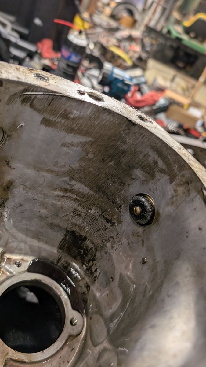

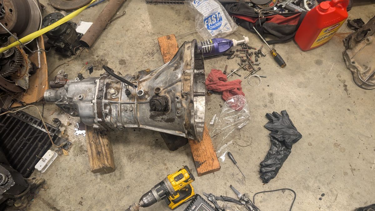

ElliotV Posted April 7 Author Report Share Posted April 7 11 hours ago, NC85ST said: Did you find that transmission at the bottom of a lake?! That’s incredible! Even looks like someone had it open before. 8 hours ago, Draker said: I don't think this one is saveable based on the look of that gear. Not even sure how that much shit gets into a transmission. Well I did come to the conclusion that it was driven into a lake and sat there so yes the truck was probably found in the bottom of a lake. I'm just going to rebuild the one in my truck and if it's got the small countershaft bearing then I do have a good front case on that long case trans that I can put on it. I'm tempted to use the Japanese bearings in the long shaft trans too because they look to be in very good shape but we will see how they feel and look upon closer inspection vs the rebuild kit. Quote Link to comment

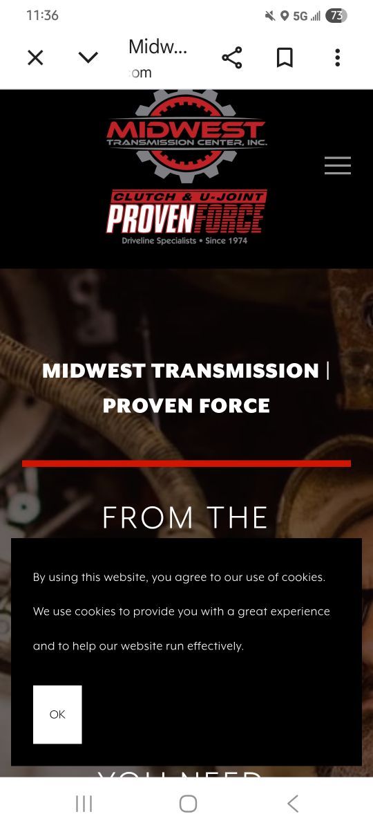

Thomas Perkins Posted April 8 Report Share Posted April 8 (edited) If you got the money,get a Midwest Transmission.I had a transmission shop put one in mine with a new yoke back in 2017.Still doing good. Edited April 8 by Thomas Perkins 1 Quote Link to comment

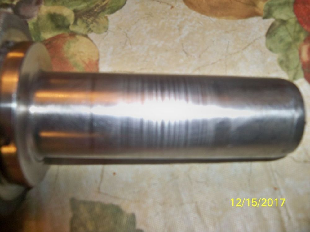

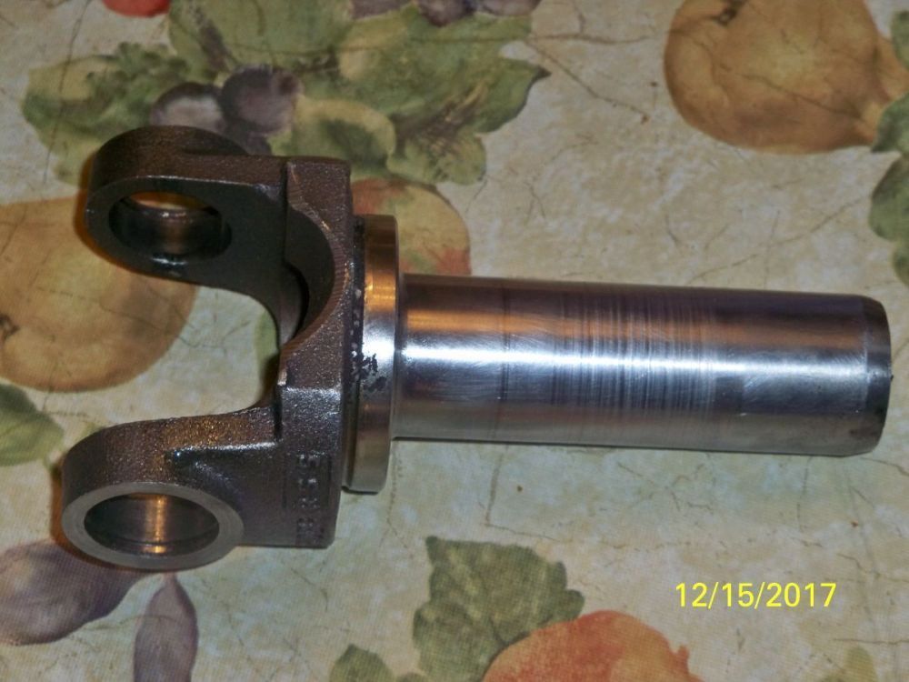

Thomas Perkins Posted April 9 Report Share Posted April 9 (edited) My driver side rear emergency brake cable rusted out and that side kept locking up.I took the little black plug out on the inner brake plate and turned the aduster and it released the tension .Finally I realized it was a bad cable.At the time Nissan had one in stock.It was 75 dollars. Probably from the wheel cylinder leaking on it. That also cracked the brake shoes.Caused it to get hot.Also ruined the brake hubs.Also most transmission shops do not rebuild transmisdions.They replace with remanufactured one's.I also had a bad yoke that was causing it to shake.It was hard to pin point what was wrong.You would think bad u-joints.So it was good that I took it and let the pros do it.Been 9 years since it was replaced.Here is the bad yoke.See the grooves.He found a brand New Nissan one local for 135 dollars. Edited April 9 by Thomas Perkins Quote Link to comment

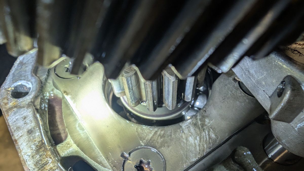

ElliotV Posted April 11 Author Report Share Posted April 11 Got the trans out today, ended up being the center countershaft bearing. This transmission has made in japan bearings and has probably never been rebuilt. I would assume the oil that I drained out when I bought the truck at 155k 2.5yrs ago and honestly it probably got changed whenever the clutch was last changed so who knows how many miles was on it and the when the previous clutch was done was when it got replaced. Quote Link to comment
datzenmike Posted April 11 Report Share Posted April 11 Once that bearing tears itself apart the entire countershaft is not properly supported and flexes under load away from the main shaft. I took a 5 speed out and drained it and balls fell out. I should have stopped right there. The unsupported countershaft flexed so much it fatigue cracked and split off right at the adapter plate. Only thing left of the counter bearing was the inner race. Quote Link to comment
ElliotV Posted April 11 Author Report Share Posted April 11 Yeah I'm lucky that it didn't drop all the bearings and snap the shaft, I've got all the bearings off now and it's just a matter of putting it all back together with new syncros and the new bearings. 1 Quote Link to comment

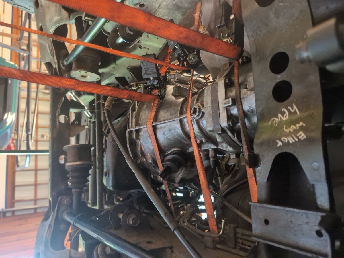

bottomwatcher Posted April 14 Report Share Posted April 14 Genius move with the rachet straps. Quote Link to comment

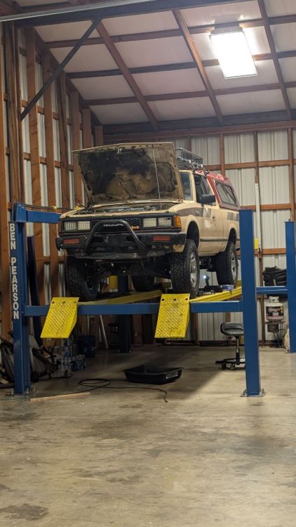

ElliotV Posted April 16 Author Report Share Posted April 16 On 4/14/2026 at 3:34 PM, bottomwatcher said: Genius move with the rachet straps. Thanks lol, makes it easier to move around and mess with some before you put the crossmember and rear mount in and you can make sure you aren't twisting the engine mounts. Quote Link to comment
