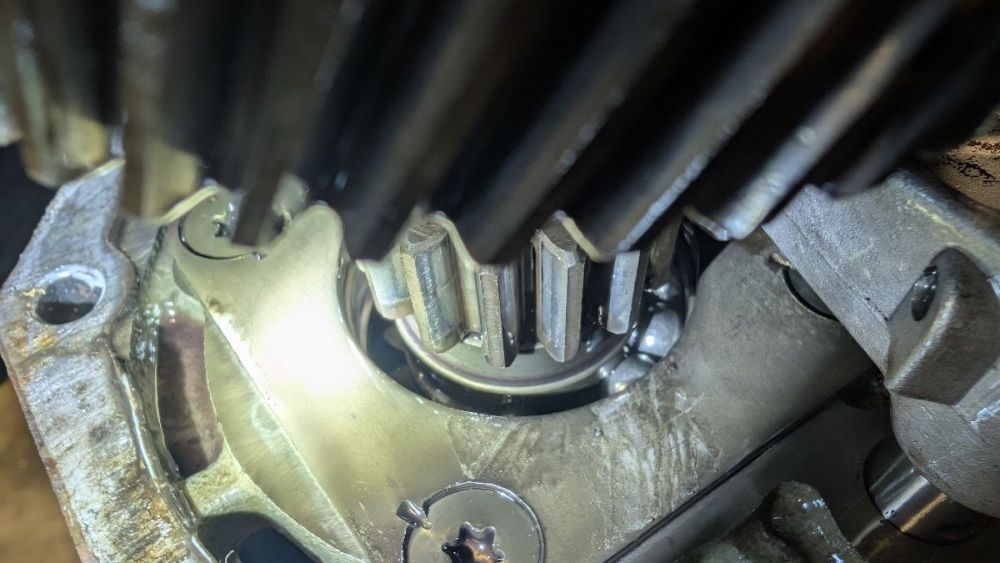

ElliotV Posted March 10 Report Share Posted March 10 So my throw out bearing or something is starting to make a little noise very randomly while I'm driving and I know for a fact my transmission could use a rebuild because I've pulled chunks of bearing cage out(transmission still makes no noise other than this new one). So my plan is to pull the transmission and do a clutch and rebuild it in a weekend with one of my friends. My plan is to drop it from underneath even though I know everyone says to pull it out through the top with the engine if I pull the engine I will have the truck apart for two weeks doing stuff to the engine and other things like the ac since I have to pull the radiator to remove the engine. My friend and I looked at it and if we remove the transmission crossmember and the front diff(which we can remove with out pulling the front crossmember that the front of the diff bolts too). If we remove that we should be able to slide the transmission back and then tilt it down and go forwards. My question is does anyone have any tips for rebuilding the transmission and should I try to do a rear main when I have it out? It doesn't leak right now but if I'm in there is that something that can be done. Quote Link to comment
ElliotV Posted March 10 Author Report Share Posted March 10 Also does anyone know where I can get a 5th gear syncro? The kit on rockauto looks to only have 4 Quote Link to comment
datzenmike Posted March 10 Report Share Posted March 10 Throw out bearings are only under load when the clutch pedal is being used. While driving the throw out bearing is just along for the ride. Must be something else. Likely the bearing cage is from the front counter bearing coming apart. What year? the '83 or '86??? '83 56mm bearing........ 32219-E9000 '85 62mm bearing........ 32219-V5201 5th synchro................... 32604-E9801 used after '79 on 720, '81-'84 Maxima and 300zx, S12 200sx till mid '86 and Hardbody and Pathfinder till around '90. Quote Link to comment

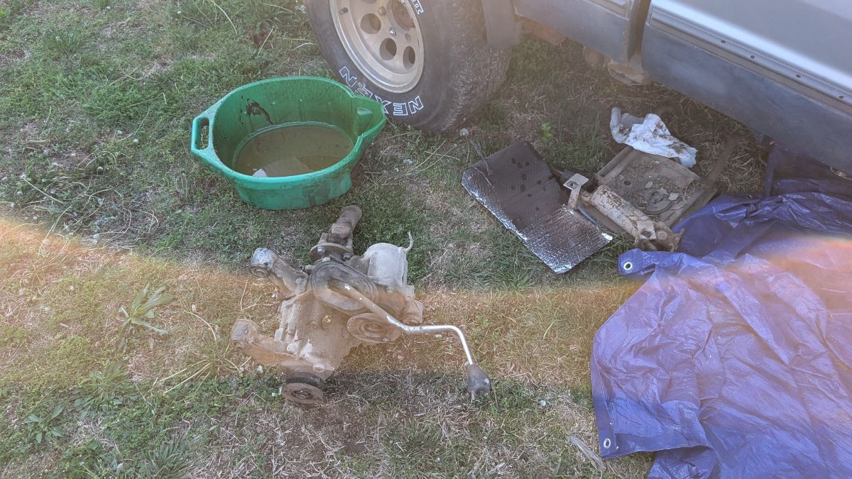

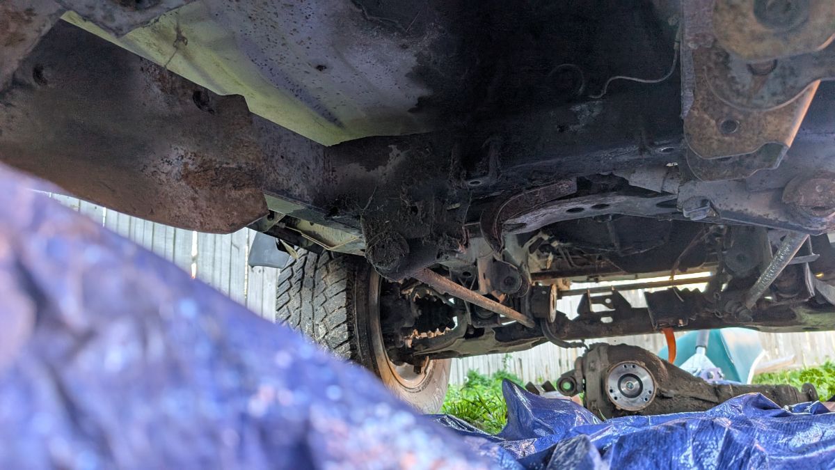

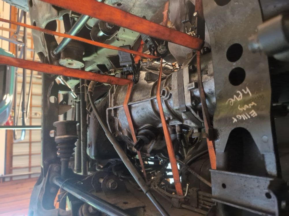

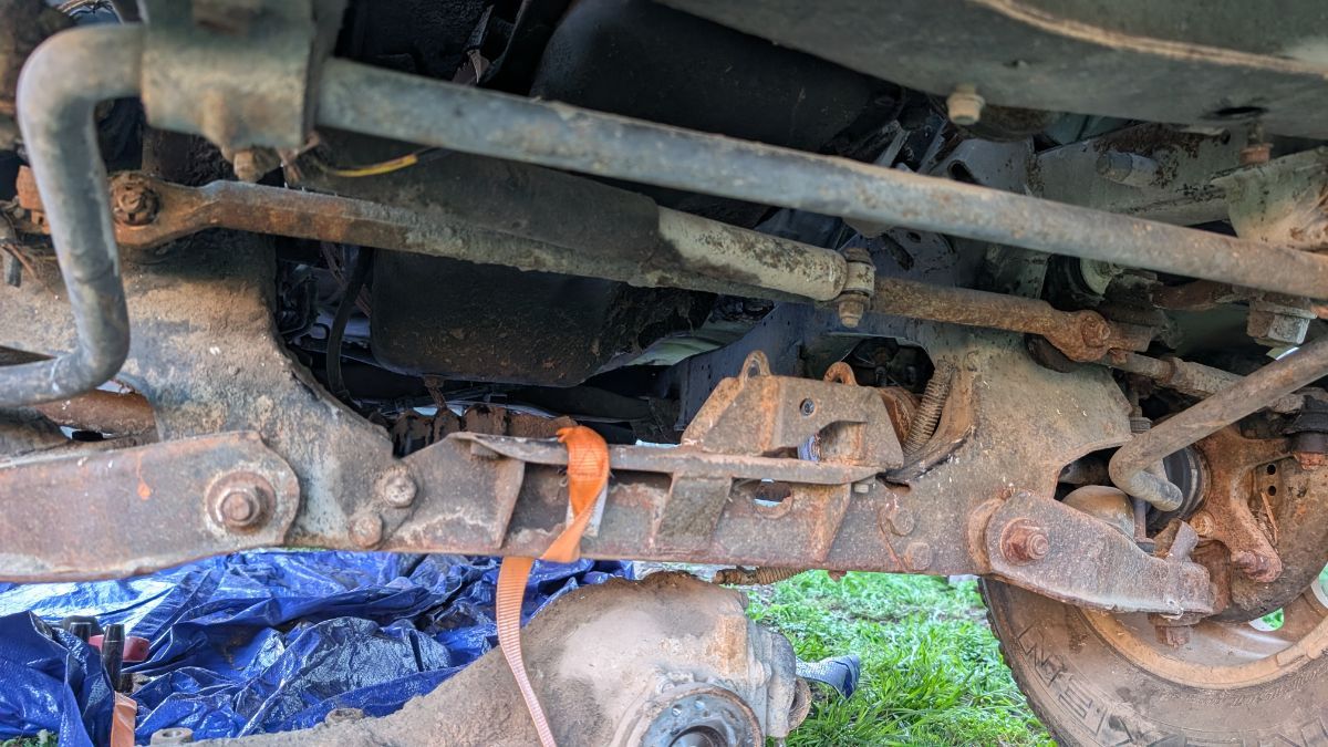

Seven Two Oh No Posted March 11 Report Share Posted March 11 @ElliotV I can confirm that you can pull the trans from the bottom in the 85 4x4, but it will fight you. I did it multiple times and did not need to jack up the truck sitting on a set of 235/75/15s. I removed the front cross member and just let the diff rotate down so the rear flange was resting on the ground, but you'd have a lot more room to maneuver the trans if you removed the diff it entirely. Removing the trans is a matter of angling and rotating as you wrestle it down. Note that when you reinstall the front cross member, the mounting pin holes may not line up so you'll need to wedge something behind the outboard side of the cross member to force the holes into alignment. Let me know if you hit this snag and I can show you how I dealt with it. For the rebuild, there's a good write up in the old Dime Quarterly with step by step instructions on rebuilding - check out Vol. 11 Issues 2 and 3 here: https://drive.google.com/drive/folders/1vg5gUButsNeoYHv737nzCO32lgiMwh_a. There's also series of videos on Youtube showing the complete disassembly and reassembly of a 71B that helped during my first rebuild. First video is here, and you can find the rest on that page - https://www.youtube.com/watch?v=eTdf7ncLy0A. This was the rebuild kit I used last time for my 85 - https://transpartswarehouse.com/bk133ws-nissan-truck-trans-fs5w71c-2wd-5-sp-transmission-rebuild-kit-84-6-86.html. Quote Link to comment
Austin Posted March 11 Report Share Posted March 11 23 minutes ago, Seven Two Oh No said: @ElliotV I can confirm that you can pull the trans from the bottom in the 85 4x4, but it will fight you. I did it multiple times and did not need to jack up the truck sitting on a set of 235/75/15s. I removed the front cross member and just let the diff rotate down so the rear flange was resting on the ground, but you'd have a lot more room to maneuver the trans if you removed the diff it entirely. Removing the trans is a matter of angling and rotating as you wrestle it down. Note that when you reinstall the front cross member, the mounting pin holes may not line up so you'll need to wedge something behind the outboard side of the cross member to force the holes into alignment. Let me know if you hit this snag and I can show you how I dealt with it. For the rebuild, there's a good write up in the old Dime Quarterly with step by step instructions on rebuilding - check out Vol. 11 Issues 2 and 3 here: https://drive.google.com/drive/folders/1vg5gUButsNeoYHv737nzCO32lgiMwh_a. There's also series of videos on Youtube showing the complete disassembly and reassembly of a 71B that helped during my first rebuild. First video is here, and you can find the rest on that page - https://www.youtube.com/watch?v=eTdf7ncLy0A. This was the rebuild kit I used last time for my 85 - https://transpartswarehouse.com/bk133ws-nissan-truck-trans-fs5w71c-2wd-5-sp-transmission-rebuild-kit-84-6-86.html. Great info, THANKS! Quote Link to comment
ElliotV Posted March 13 Author Report Share Posted March 13 @Seven Two Oh No ok I'll probably still keep some extra u joints in the truck for the my trip to Moab since all of them are the same size u joint. My buddy has a car lift that we can use and I think between the two of us we can just lower it out of the truck. Quote Link to comment

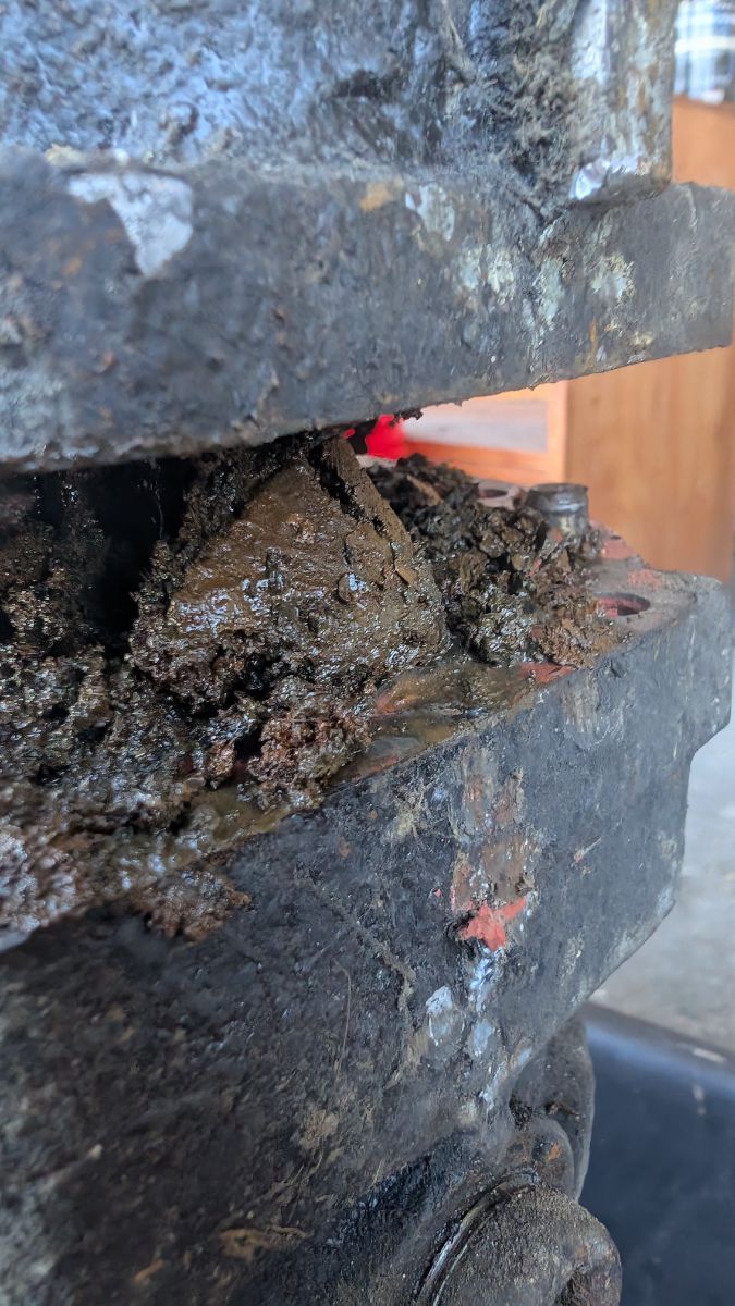

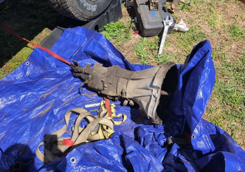

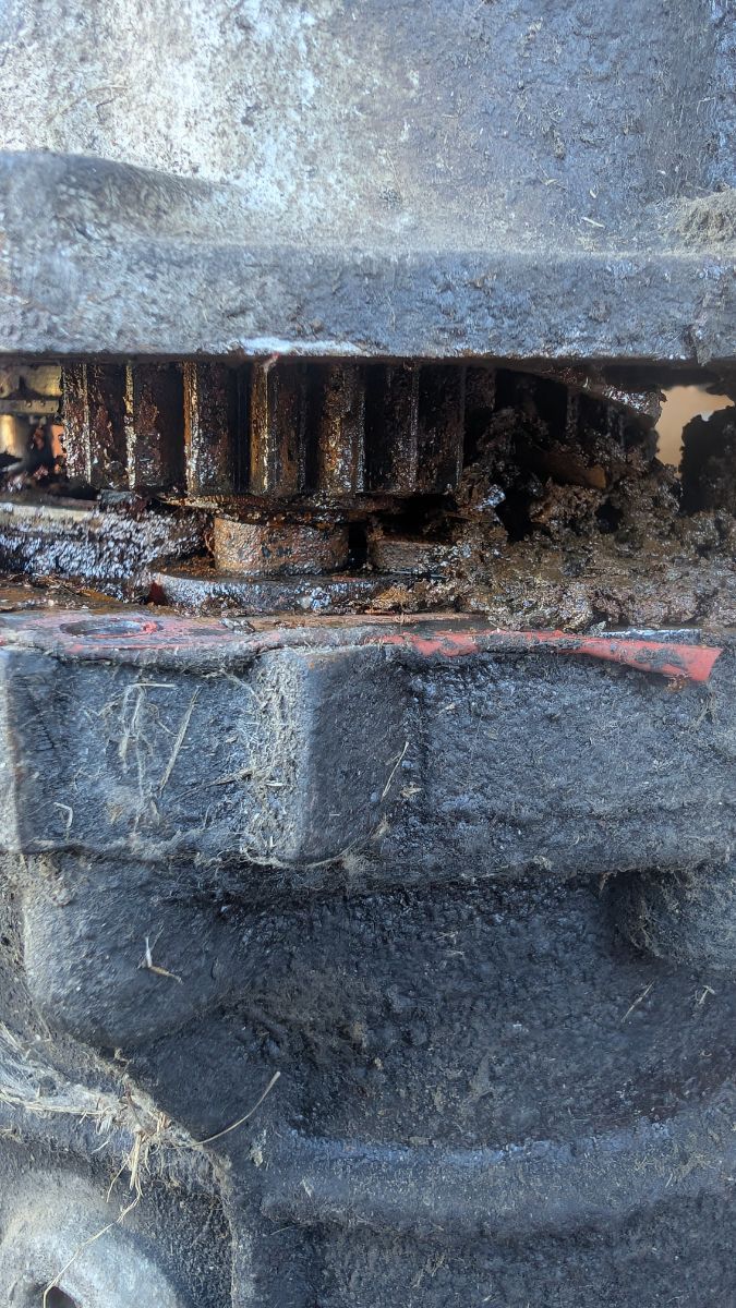

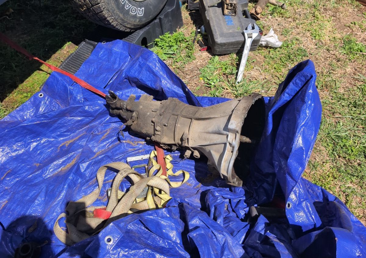

ElliotV Posted April 5 Author Report Share Posted April 5 Well I ended up deciding to pull the trans out of one of my trucks. I'm pretty sure the reason this truck was parked is because someone drove it into a lake. There's weird like algae everywhere and sand in a bunch of weird places and I was told it was parked because the computer went bad for the efi and it's sitting on the floor of the truck with a bunch of water damage. Transmission was also full of water so we will see what it looks like when I finish getting it out and apart. Ended up working on it from about 1 till 7 today with a hour and a half long dinner so I don't think this is too bad considering how much all the bolts fought me and I ended up having to drop the transfer case since I couldn't rotate the intermediate shaft. 1 Quote Link to comment
ElliotV Posted April 5 Author Report Share Posted April 5 Well got it out. Apparently even though this is a 86 truck it has the small countershaft bearing. 1 Quote Link to comment

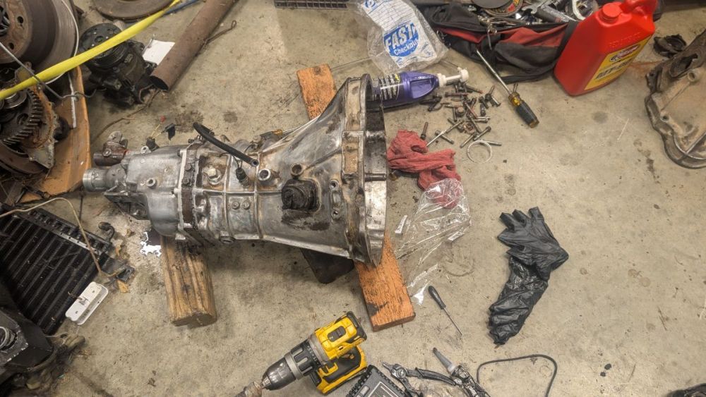

ElliotV Posted April 5 Author Report Share Posted April 5 Well I pulled apart a spare long trans I had and the 5th gear is broke. But it has the large countershaft bearing. Issue is that the short trans I have is not willing to come apart and is completely full of sand and rust. Anyone think it's worth trying to get apart still or should I just try to do the one in my truck in a weekend? Quote Link to comment
NC85ST Posted April 6 Report Share Posted April 6 Did you find that transmission at the bottom of a lake?! That’s incredible! Even looks like someone had it open before. 1 Quote Link to comment
Draker Posted April 6 Report Share Posted April 6 18 hours ago, ElliotV said: Well I pulled apart a spare long trans I had and the 5th gear is broke. But it has the large countershaft bearing. Issue is that the short trans I have is not willing to come apart and is completely full of sand and rust. Anyone think it's worth trying to get apart still or should I just try to do the one in my truck in a weekend? I don't think this one is saveable based on the look of that gear. Not even sure how that much shit gets into a transmission. Quote Link to comment
DwayneOxford Posted April 6 Report Share Posted April 6 21 hours ago, ElliotV said: Well I pulled apart a spare long trans I had and the 5th gear is broke. But it has the large countershaft bearing. Issue is that the short trans I have is not willing to come apart and is completely full of sand and rust. Anyone think it's worth trying to get apart still or should I just try to do the one in my truck in a weekend? I'd just put a new one in the one in your truck. 1 Quote Link to comment
