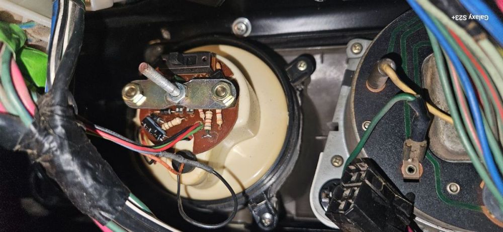

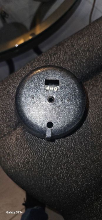

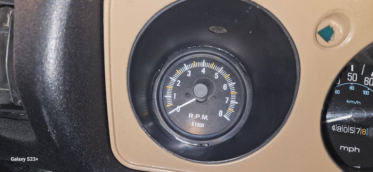

lil Hustler 620 Posted March 4 Report Share Posted March 4 Hey guys, has anybody ever seen this tach? I'm thinking it was pulled out of something and fabricated to fit. I'm trying to figure out the wiring. Quote Link to comment
Draker Posted Wednesday at 04:24 PM Report Share Posted Wednesday at 04:24 PM Never seen it. But it’s definitely aftermarket. Looks good there though. Nicely fit. 1 Quote Link to comment
LeviGideon Posted Wednesday at 05:41 PM Report Share Posted Wednesday at 05:41 PM looks autometer-ish. Off the tach it's usually green to coil neg, black ground, red switched 12v, and then there's usually a wire for dash lights. Quote Link to comment
datzenmike Posted Wednesday at 06:25 PM Report Share Posted Wednesday at 06:25 PM If a brand name it probably would say so. I looked on Google image and Amazon for tachometers and did not find an exact match. Similar ones ranged from $11 to just over $30. Quote Link to comment
