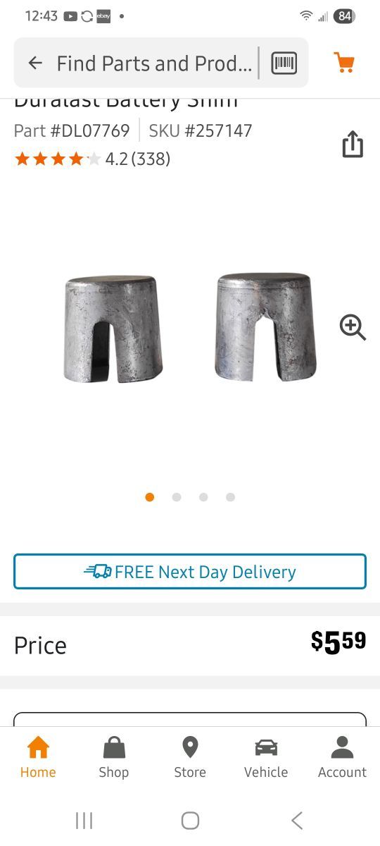

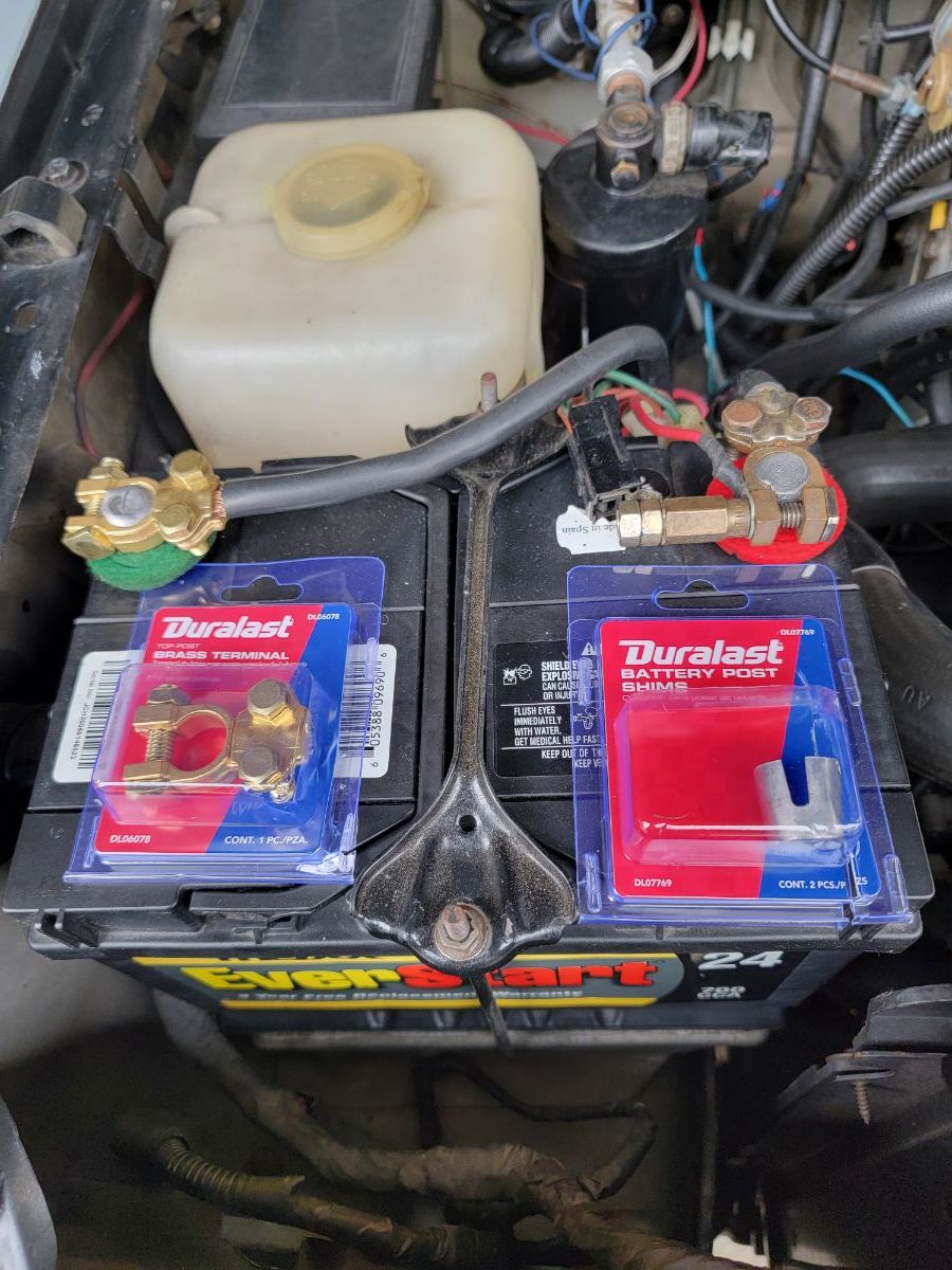

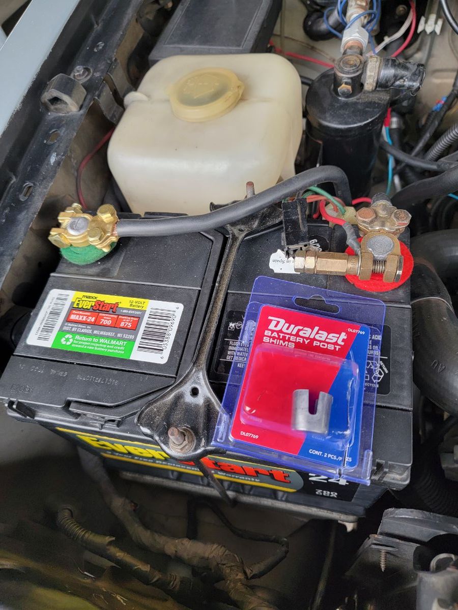

Happy Tuesday ya'll.Yesterday I was showing someone my fusible link connectors I use.I took the link off the positive side to show and could not get the negative cable off.I had it so tight that it dug into the post.So I removed the battery from truck and cut the bolt off the cable with my dremel tool.So I went to Auto Zone and bought some post shims and a cable.First time ever using them .They are a super tight fit.Battery is almost 4 years old.Still good.

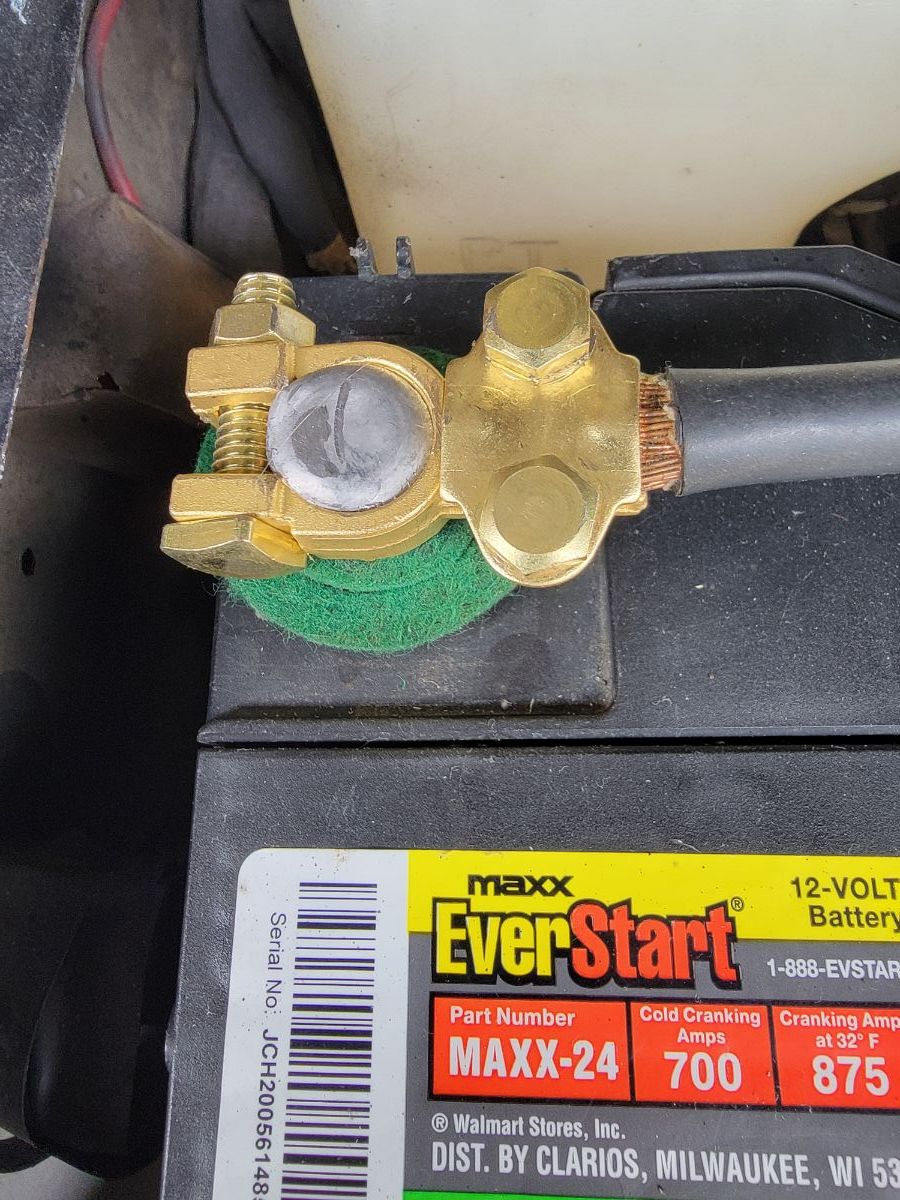

Now sense the negative post has a shim on it.I will loosen both 11 mm bolts and remove the cable to disconnect power from battery than taking the terminal off.

As we know the negative post is smaller.But all battery cables are the same size which means you have to about tighten it way more than the positive one.Sometimes you run out of room.

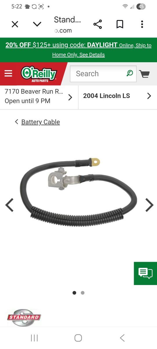

When you buy a 2 pack.They are both the same size.Then you end up tightening the negative all the way then it is not any good when you take it off a few times.One size does not fit all.I bought a stock negative one for my wifes lincoln ls and it fits perfect.Both are made to fit just one side.Her positive one will only fit the positive side.Here is what her's looks like.Here positive one is original and the one in the picture is a Ford motor craft brand that I recently bought and put on.I will get one and put on my battery when this one dies.It fits the negative side perfect.
