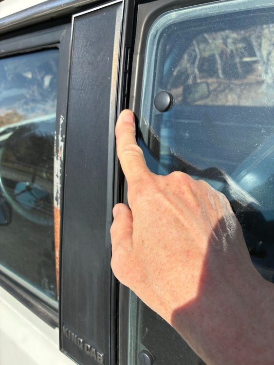

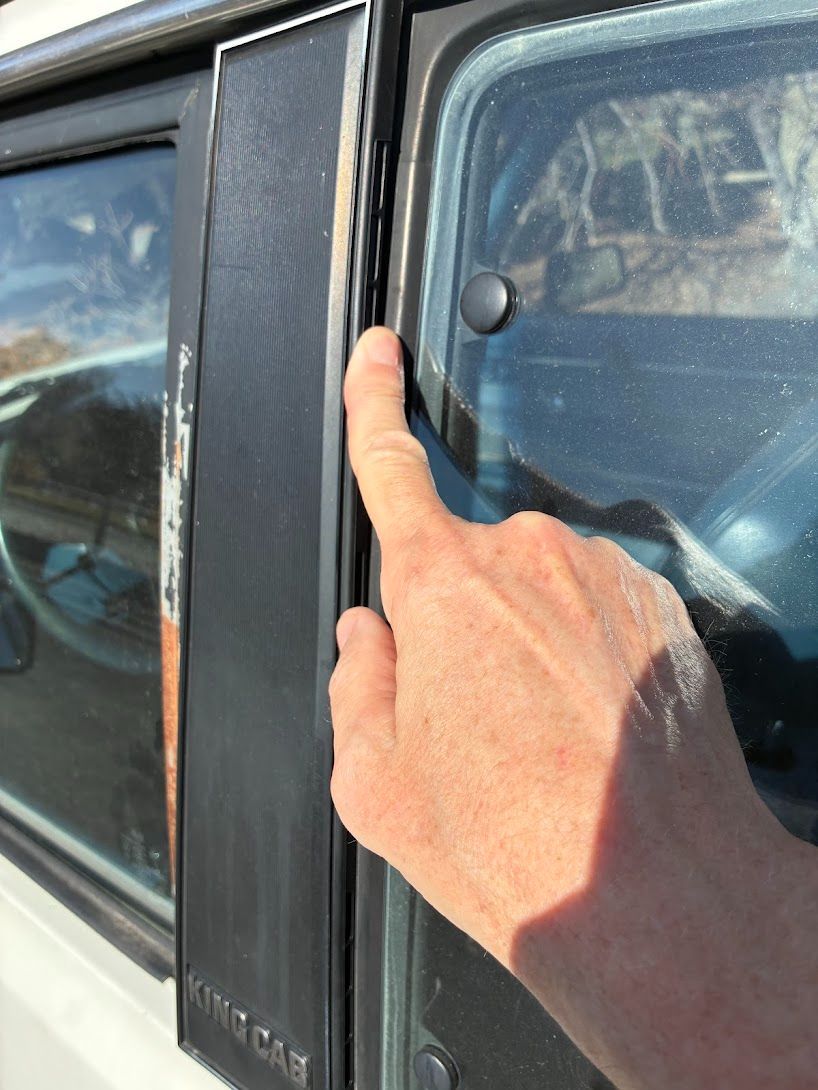

PineClone Posted March 2 Report Share Posted March 2 (edited) All of a sudden this thing started rattling in my ear today. It is tightly attached at the bottom, but the top half of the right side (where i'm pointing) is loose. Passenger side panel seems to be attached similarly, but isn't quite as loose. Any pointers? I'm about to pop it off and see if i can come up with any ideas, but don't want to break it. Thanks. Edited March 2 by PineClone cleaning up Quote Link to comment
datzenmike Posted March 3 Report Share Posted March 3 I think they just push on so place some felt or thin carpet in there and pop back on. Quote Link to comment

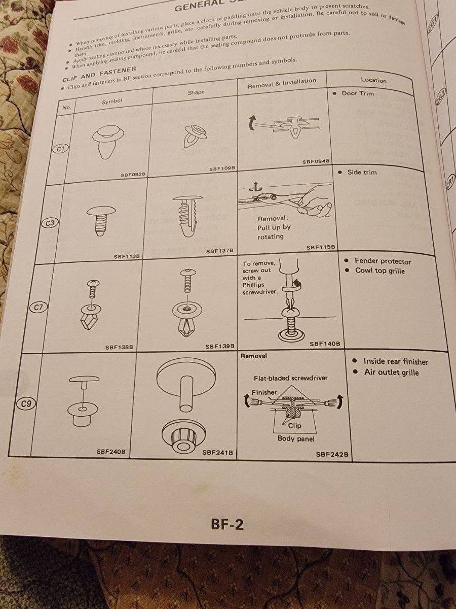

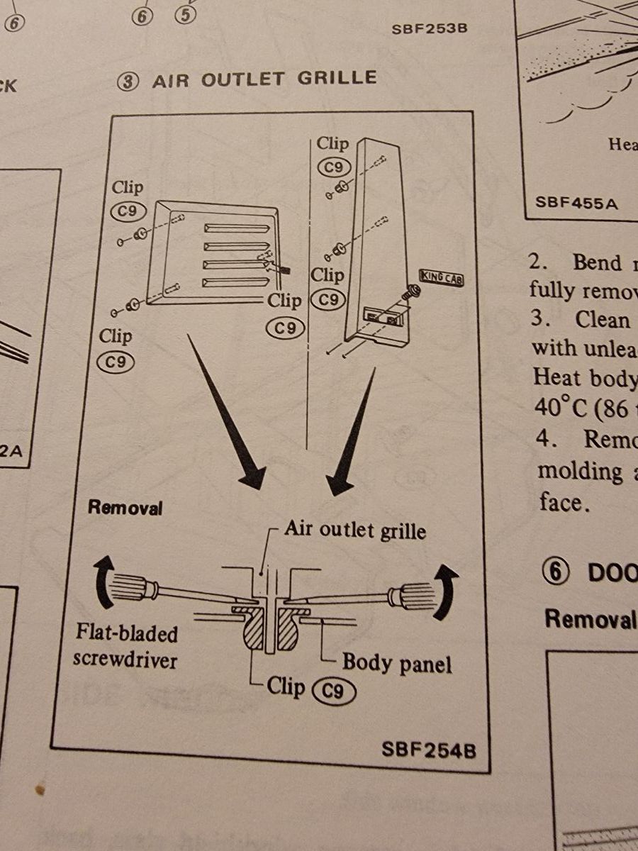

Thomas Perkins Posted March 4 Report Share Posted March 4 (edited) They have clips in them.Here is a picture from my 85 Nissan FSM Service Manual.It shows how to remove with 2 flat head screw drivers.I will look and see if Nissan still has clips for sale.Here are the clips from my book.C-9 are the clips. Edited March 4 by Thomas Perkins 1 Quote Link to comment

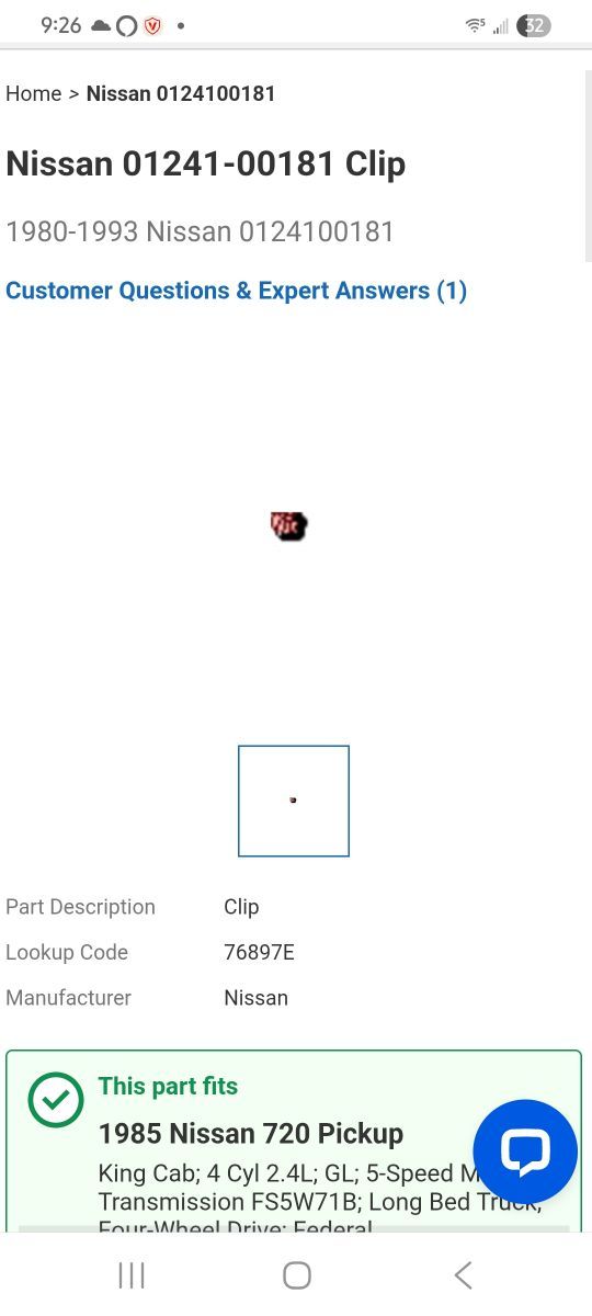

Thomas Perkins Posted March 4 Report Share Posted March 4 (edited) Here is the part number for the clips.It is showing that Nissan still sells them.Call your local Nissan Dealer.You should get free shipping from them.Says 2.37 each.2 per side. Edited March 4 by Thomas Perkins 1 Quote Link to comment
NC85ST Posted Wednesday at 07:37 PM Report Share Posted Wednesday at 07:37 PM It looks like it has 1 or 2 screws under the King Cab badge also. 1 Quote Link to comment

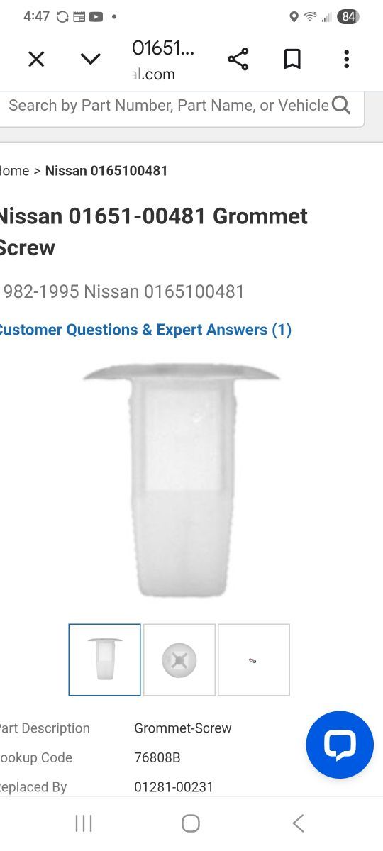

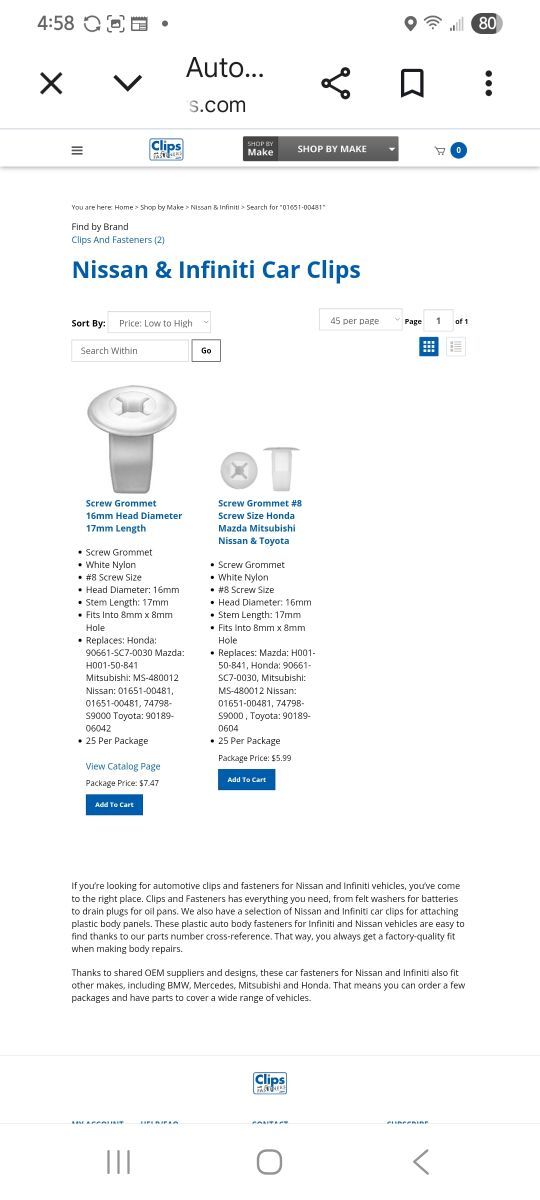

Thomas Perkins Posted Wednesday at 09:48 PM Report Share Posted Wednesday at 09:48 PM (edited) Them screws go into these grommets.I have a bunch of these.They are for sale everywhere. Edited Wednesday at 10:02 PM by Thomas Perkins Quote Link to comment
