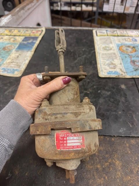

GRJones Posted February 15 Report Posted February 15 Hi wondering if there's a source for this seal and or rod. Thanks. Quote

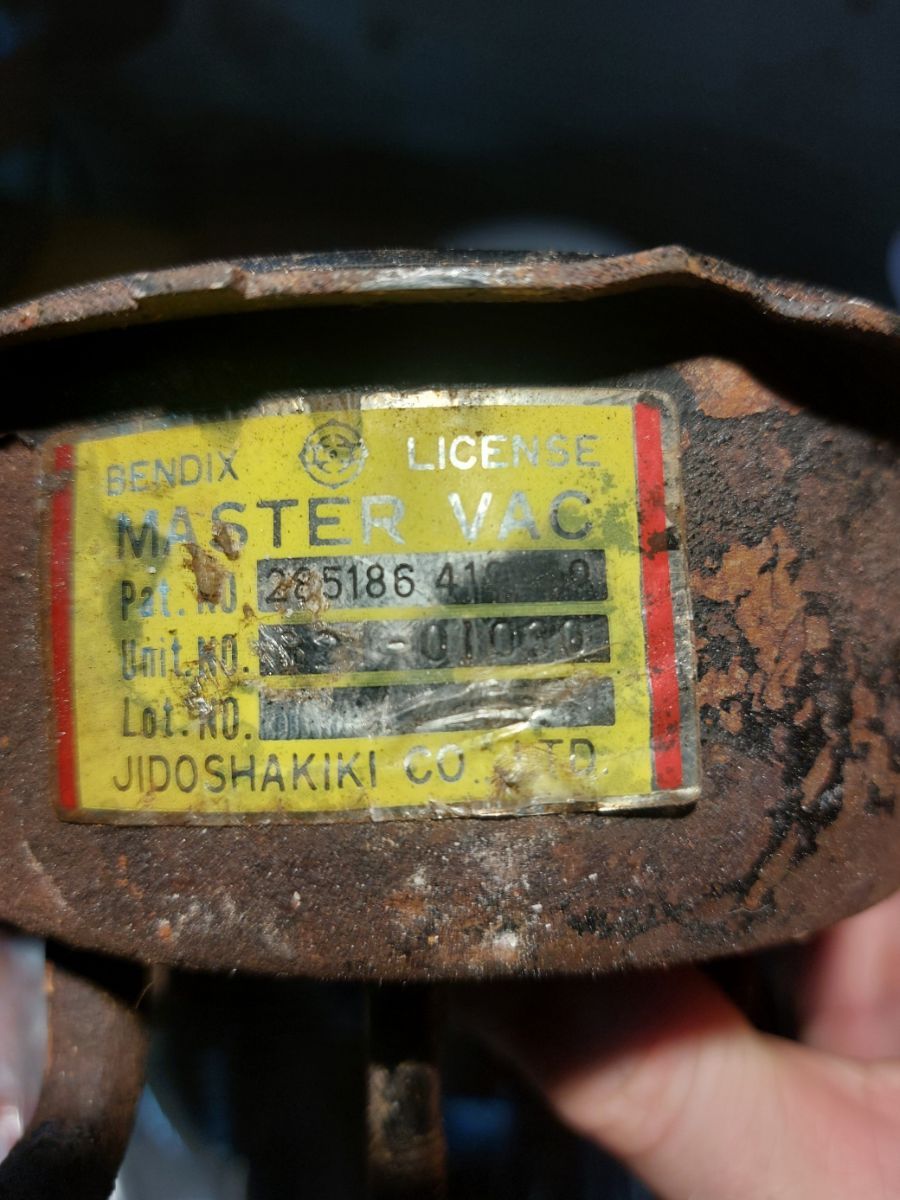

datzenmike Posted February 15 Report Posted February 15 Not from Nissan. The 620 Master Vac comes as an assembly. 1 Quote

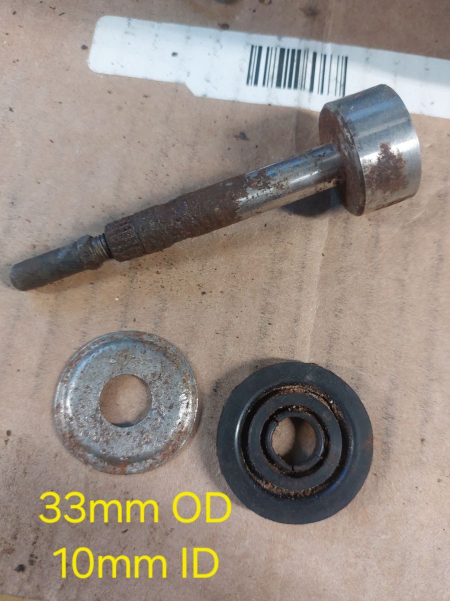

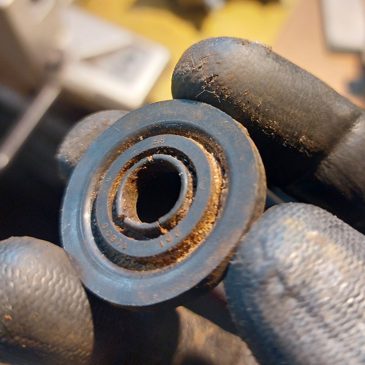

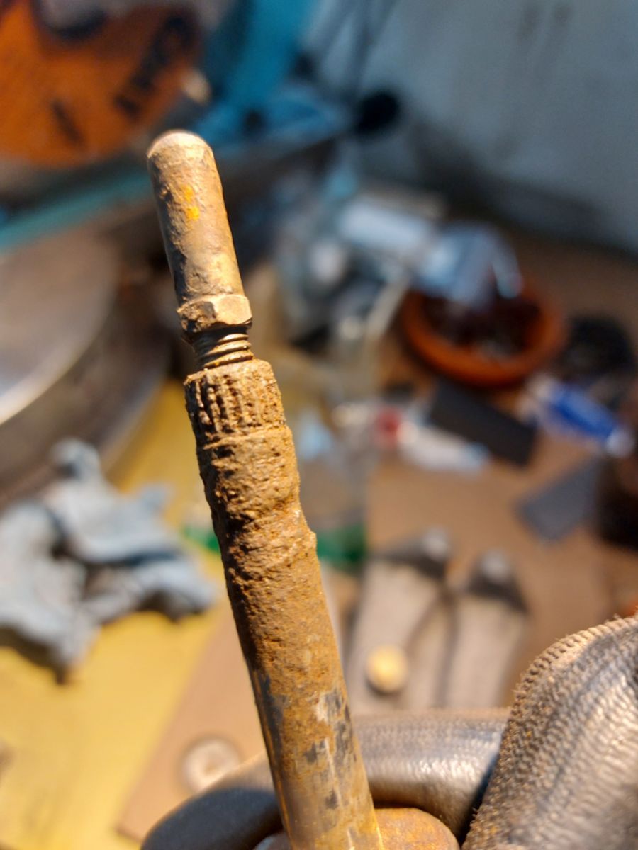

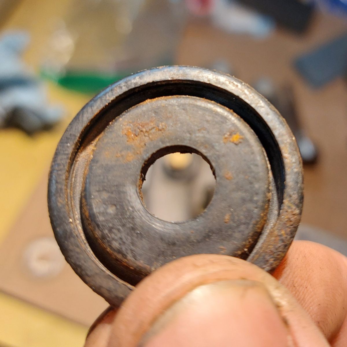

GRJones Posted February 20 Author Report Posted February 20 Here is the damage with mine. Everything else is in good shape. 3 cracks in the push rod seal. I could make my own possibly? rigid piece of rubber? Solid on backside I could jbweld the rod Quote
datzenmike Posted February 20 Report Posted February 20 What are the numbers on the seal? 10800??? Is this it?... https://www.amazon.ca/Brake-Booster-Seal-46185-SE0-003-Compatible/dp/B0FH2N61Z7?source=ps-sl-shoppingads-lpcontext&ref_=fplfs&psc=1&smid=A39PTXDE7CH91U https://www.ebay.com/itm/375927577220 Quote
GRJones Posted February 20 Author Report Posted February 20 3 numbers 58 221 and 10600. It's 33mm OD and 10mm ID Quote
datzenmike Posted February 21 Report Posted February 21 https://www.amazon.ca/s?k=Nissan+brake+booster+seal+replacement&crid=493HQWN88HCV&sprefix=nissan+brake+booster+seal+replacement%2Caps%2C191&ref=nb_sb_noss For only $12 pick one and try it. Quote
