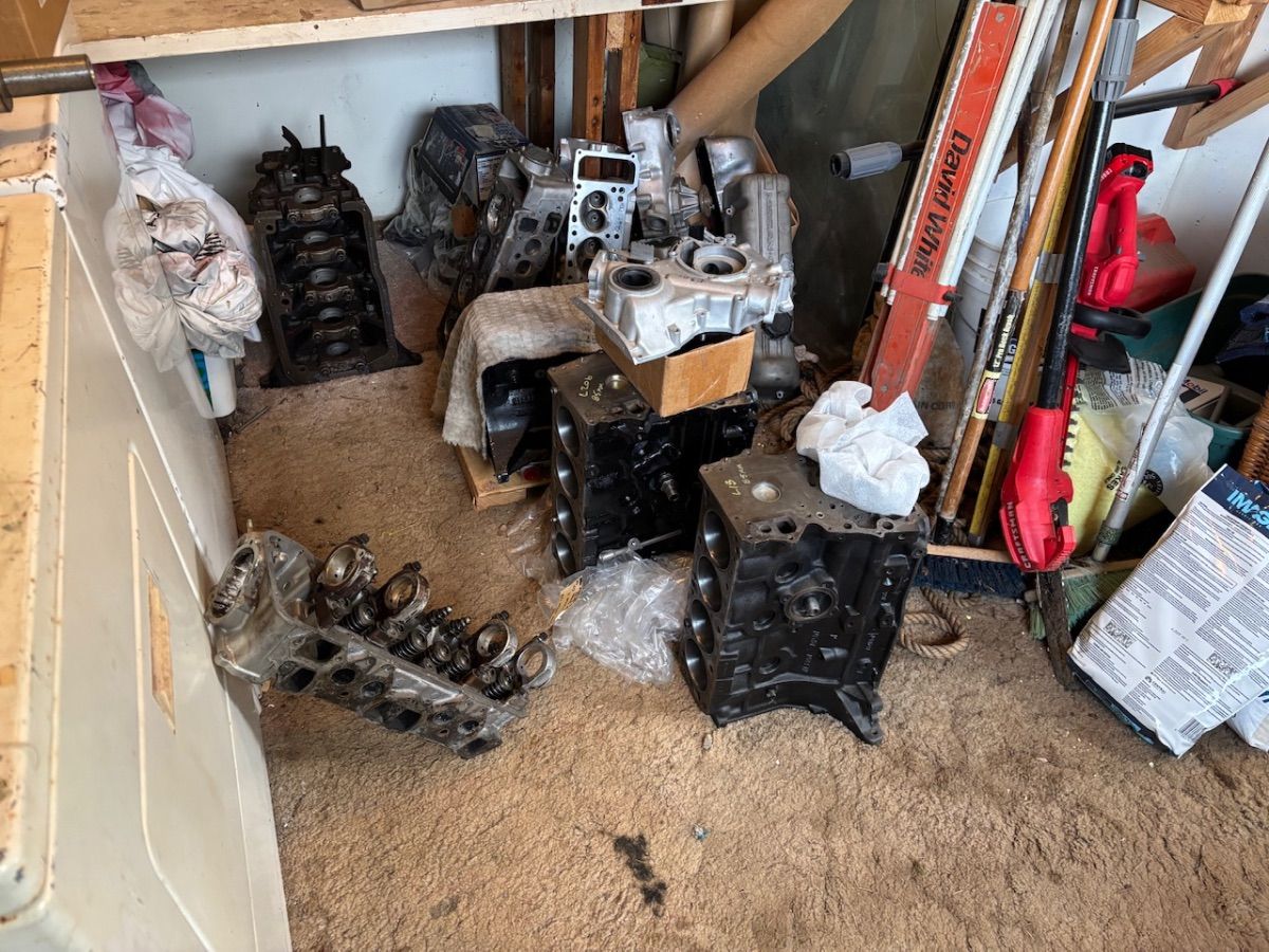

Slow Loris Posted March 4 Report Share Posted March 4 11 hours ago, ScaryPony said: let me know if you do start parting with your stock. I’m starting a foster home for Datsun engines. I been sayin that to hainz for a little while now he still ain’t sold anything! But may the lord bless you for hoarding some Datsun stuff, it wont pay dividends in cash money but certainly will in eternal admiration and lowball offers from fellow handsome enthusiasts! Hallelujah! 1 Quote Link to comment
banzai510(hainz) Posted March 4 Report Share Posted March 4 key is if one lives close by. I dont go to post office or UPS/FedEX. Quote Link to comment

ScaryPony Posted March 5 Author Report Share Posted March 5 (edited) On 3/3/2026 at 7:06 PM, Slow Loris said: But may the lord bless you for hoarding some Datsun stuff, it wont pay dividends in cash money but certainly will in eternal admiration and lowball offers from fellow handsome enthusiasts! Hallelujah! Yes I’m certainly doing the lord’s work. Only I turn water into race gas. Edited March 5 by ScaryPony 1 Quote Link to comment
ScaryPony Posted March 5 Author Report Share Posted March 5 9 hours ago, banzai510(hainz) said: key is if one lives close by. I dont go to post office or UPS/FedEX. Have wheels. Will travel for Datsun parts. What’s in your stash? 1 Quote Link to comment
iceman510 Posted March 5 Report Share Posted March 5 About the same. Incidentally, if you end up with a spare L18 crank, I might be interested. Especially if you stumble across a six-bolt version. Quote Link to comment
ScaryPony Posted March 5 Author Report Share Posted March 5 2 hours ago, iceman510 said: About the same. Incidentally, if you end up with a spare L18 crank, I might be interested. Especially if you stumble across a six-bolt version. You got it. I have a lead on a some parts way out in the boonies. I’ll keep you posted. Quote Link to comment
banzai510(hainz) Posted March 5 Report Share Posted March 5 (edited) 5 hours ago, ScaryPony said: I have a lead on a some parts way out in the boonies. Is it Paulo?????????? He'lll want a million dollars then you comeback later is another 1ft down in the earth with a fallen tree over it Edited March 5 by banzai510(hainz) 1 Quote Link to comment

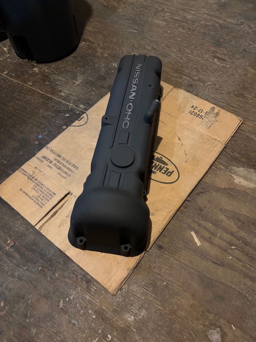

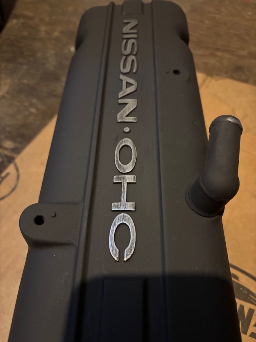

ScaryPony Posted March 6 Author Report Share Posted March 6 Fresh out of the first bake this morning. I scuffed the lettering with 80 grit before I shot it to give the high temp some grooves to sit in. Sanded it back with 180 so it wouldn’t take much away. I think it looks rugged 2 Quote Link to comment

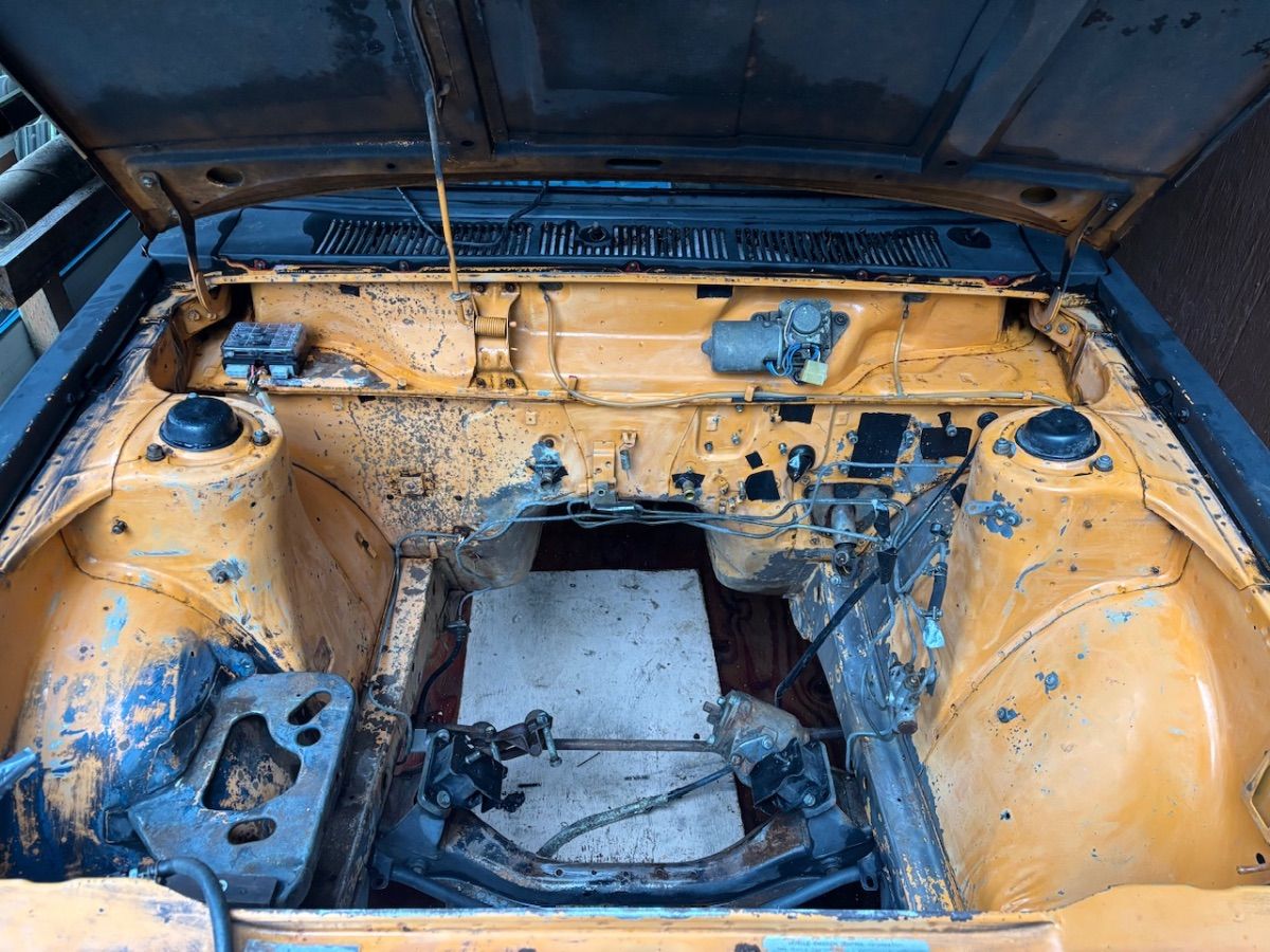

ScaryPony Posted March 9 Author Report Share Posted March 9 Just about finished prep today, pulled the lines right after this photo to finish scuffing and grinding. Just waiting for things to warm up now. Still want to jump in there one more time with the engine out and finally get at the rest of the joints I haven’t replaced/refurbished yet. Not going back to metal everywhere, just the spots compromised by 50 years of battery-acid or brake-fluid. Only two components remain. The fuse box is rust-welded to the body. And does anyone want to tell me what the trick is for getting the wiper motor assembly off? I tried shouting at it and now I’m out of ideas. Quote Link to comment
Rustbin Posted March 9 Report Share Posted March 9 Do you mean taking off the little clip? I think you just place a screwdriver between it and the end of the shaft then slide it sideways, I think. If you haven't already, clean out the center cowl drain with a thin flexible thing, maybe a bicycle spoke will work to pull the debris out. For rusted bolts I douse in penetrating oil several times over days or weeks and if they still don't come I bust then off then drill the center with ever larger bits till I can pry the remaining shards out of the threads with an awl, and chase the threads with a tap. Quote Link to comment
ScaryPony Posted March 10 Author Report Share Posted March 10 21 hours ago, Rustbin said: Do you mean taking off the little clip? I think you just place a screwdriver between it and the end of the shaft then slide it sideways, I think. If you haven't already, clean out the center cowl drain with a thin flexible thing, maybe a bicycle spoke will work to pull the debris out. For rusted bolts I douse in penetrating oil several times over days or weeks and if they still don't come I bust then off then drill the center with ever larger bits till I can pry the remaining shards out of the threads with an awl, and chase the threads with a tap. Thanks I couldn’t figure out the clip situation (or didn’t try very hard). I’ll look at it when I get back in there. I didn’t even know there was a cowl drain. Thanks again! I’ll give that a spray. Is that the only drain for the cowl or just one of? 1 Quote Link to comment
Rustbin Posted March 10 Report Share Posted March 10 1 hour ago, ScaryPony said: Is that the only drain for the cowl or just one of? There are also two downspouts that exit behind the front tires, one on either side behind the dash as well as the central one. Quote Link to comment
