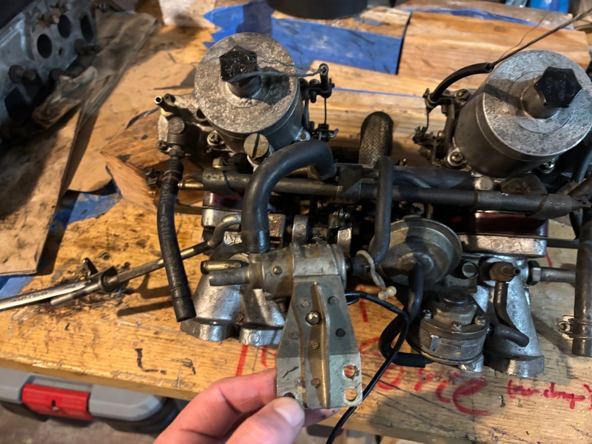

ScaryPony Posted February 18 Author Report Share Posted February 18 So last night I took a little time to start cleaning the SU. I did some reading also and just thought I would share. Someone can correct me but I believe the small pump-like thing in my hand is a fuel shutoff? Haven’t quite figured out how fuel flows through this setup. Ztherapy does have parts and even recommended a needle size for this application. Now I know I can replace I will disassemble and report more. Quote Link to comment

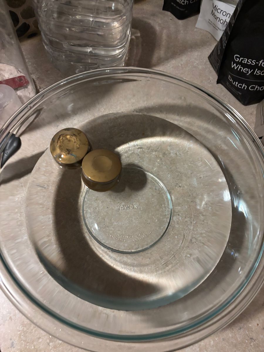

ScaryPony Posted February 20 Author Report Share Posted February 20 I checked my floats from the SU. They float. Quote Link to comment

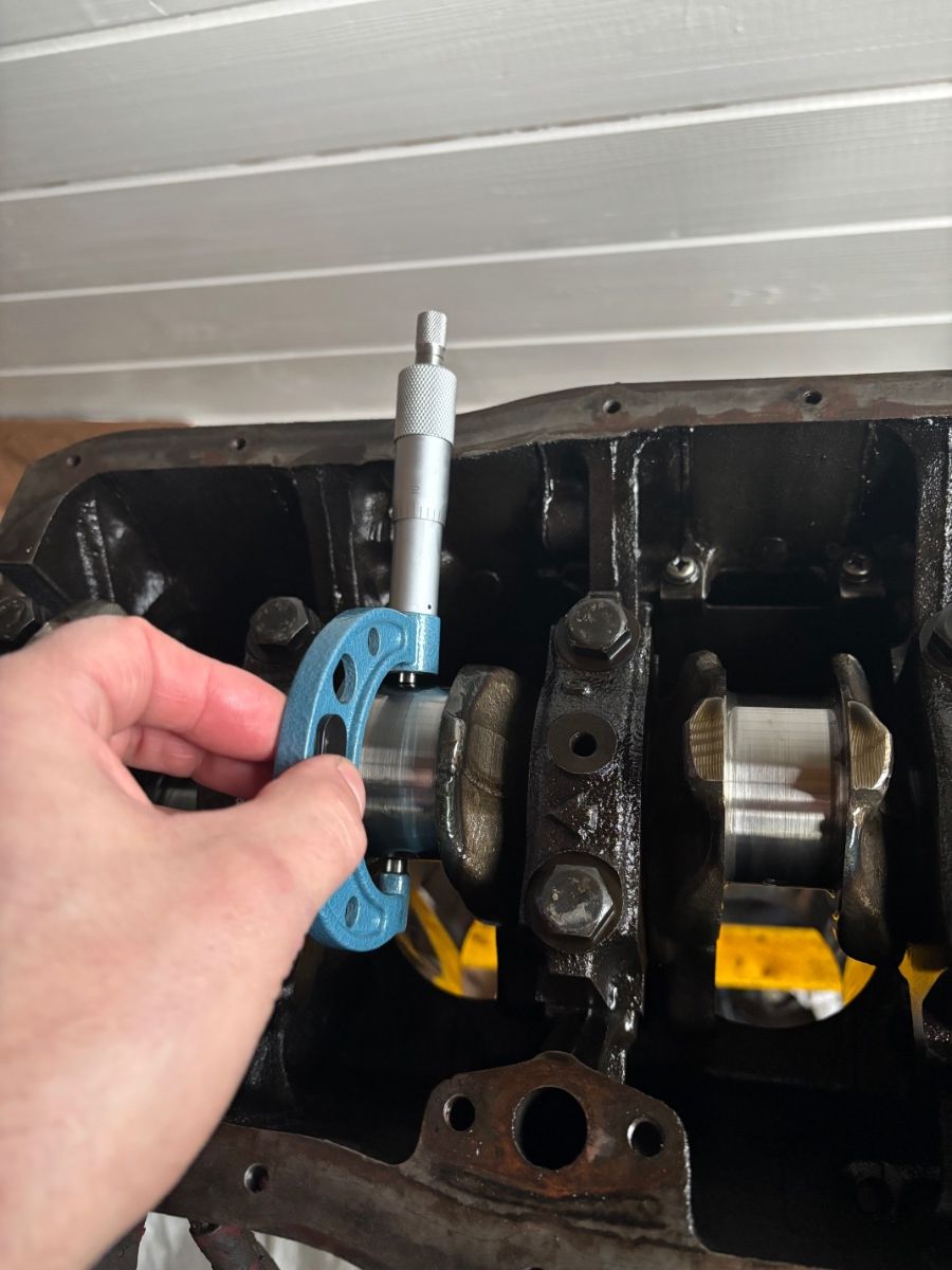

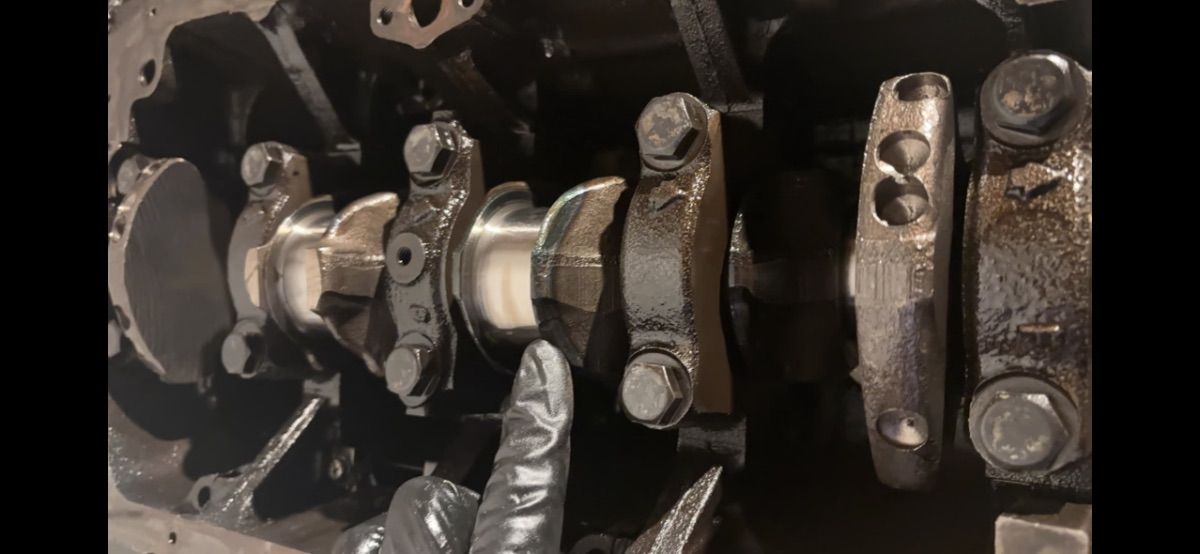

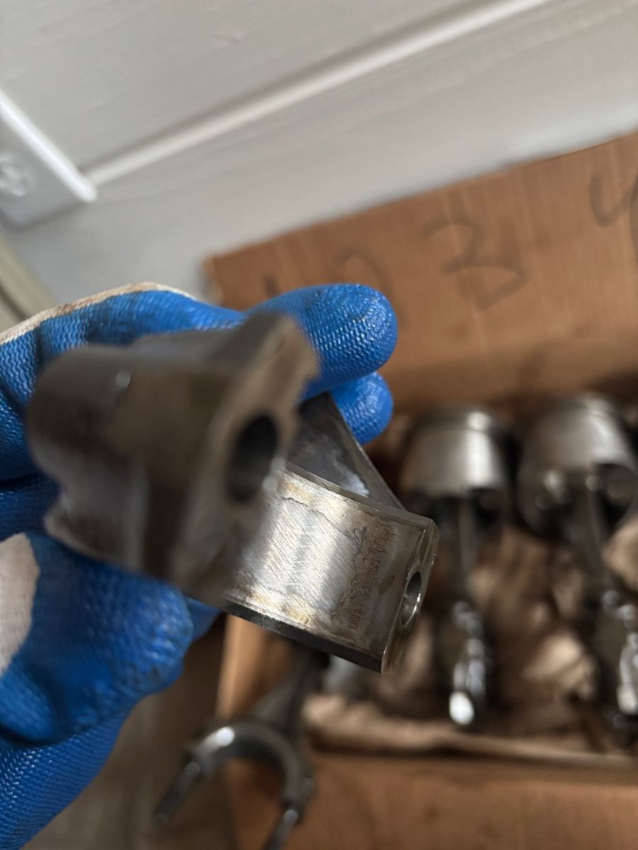

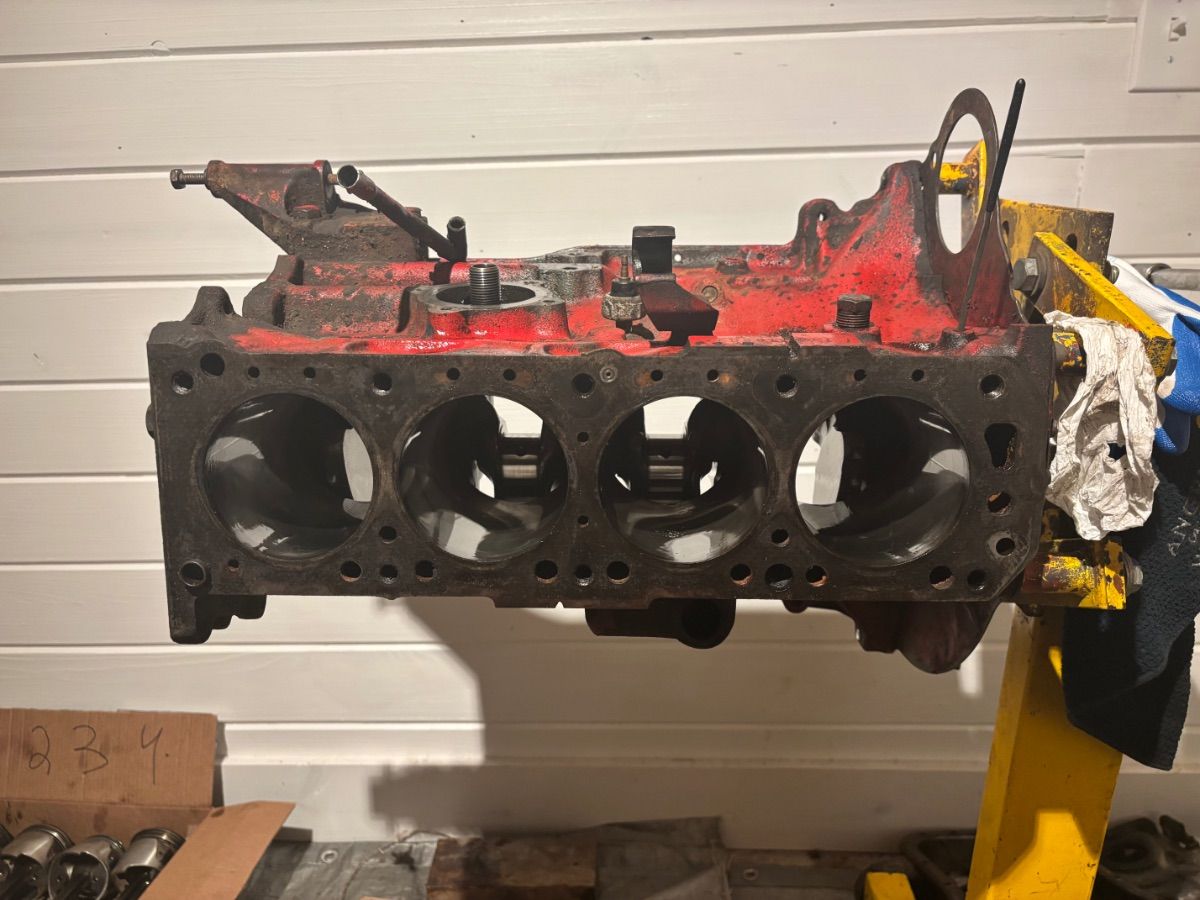

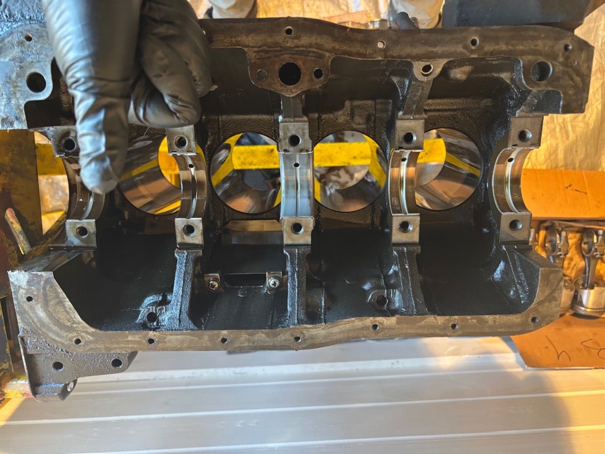

ScaryPony Posted February 23 Author Report Share Posted February 23 Made good progress this weekend. Looks like a good rebuildable L16. Little bluing on cheeks but pretty sure it’s normal. Even checked side-play before pulling the pistons and it’s within range. Rotating surfaces all looked good at first inspection. In other news. Got a line on both L18 and L20 blocks/cranks. Going to rebuild this motor still but don’t (yet) know what will go back in the wagon. Seems like the path is to refresh the W53, get the block paired to a set of flat tops, get it on the road. Then I can build a “real” motor as I have time. You guys have been great for bouncing ideas. Tell me what you think. Quote Link to comment

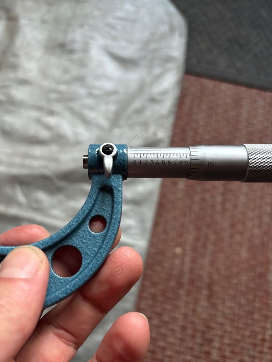

datzenmike Posted February 23 Report Share Posted February 23 Blue is from high heat, (550-600F) usually a spun rod bearing, rod would be really blue but replaced. I would check the journal diameter it may have been turned and an over size bearing used. Better check them all. The stock rod journal diameter for an L16 is 1.9670 to 1.9675 If 1.947 it's turned down 0.5mm Look at the old bearing shells it will say if over size. Quote Link to comment
ScaryPony Posted February 24 Author Report Share Posted February 24 Seems right on your numbers unless I’m reading my micrometer wrong Also, the original Nissan markings are there on the rod. Could the blueing be part of a heat treating process in the original MFG? Quote Link to comment
datzenmike Posted February 24 Report Share Posted February 24 1 hour ago, ScaryPony said: Could the blueing be part of a heat treating process in the original MFG? They are heat treated after forging but then they would all be blue. Quote Link to comment

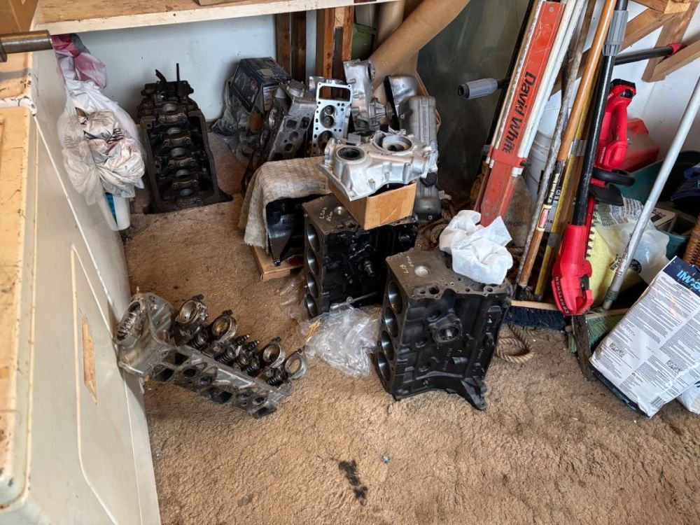

ScaryPony Posted February 26 Author Report Share Posted February 26 My daily was briefly a 3-motor. Well, 2.5 maybe. L18 block ready for refresh. Bought from a guy down in Seattle who has been racing Datsuns for decades. Thanks dude. 1 Quote Link to comment
banzai510(hainz) Posted February 26 Report Share Posted February 26 (edited) hope he didnt charge much. One day soon Im going to get rid of my stuff. I got a L18 with like 50Kmiles on there on a stand. I took my Block to Autosport Seattle back in the day guy named Terri I think was the main machinist Edited February 26 by banzai510(hainz) Quote Link to comment

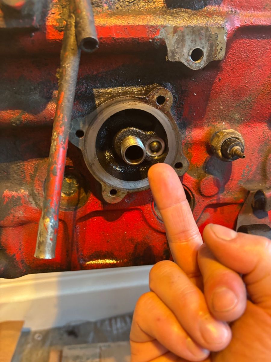

DARIN 510 Posted February 27 Report Share Posted February 27 On 2/12/2026 at 8:41 PM, datzenmike said: I'm not convinced that engine is an L18. I see three things that are sort of odd. What are the three things so we all know? Quote Link to comment
ScaryPony Posted March 2 Author Report Share Posted March 2 Good Q: mike answered earlier, let me look it up. Quote Link to comment
ScaryPony Posted March 2 Author Report Share Posted March 2 On 2/13/2026 at 11:51 AM, datzenmike said: 1/ the block vent is not in the usual L16/18 place on the side of the block. Exiting vertically is what L20Bs do. 2/ it has a '79-'83 thermostat cover but could have been swapped. 3/ Has the later L20B 'fuel rail' between pump and carburetor. Again could have been swapped. Check the block ID behind the dip stick handle. There it is! There is another difference between my l16 block and my l18 block also. My l16 has no freeze plug at the front of the block. Not sure if this applies to all l16 or not but I’m sure someone will. Quote Link to comment

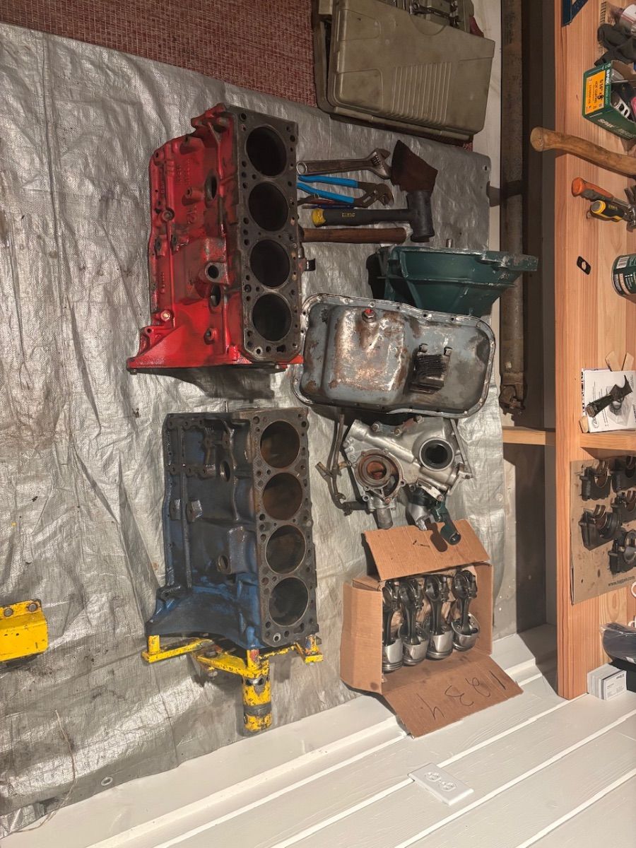

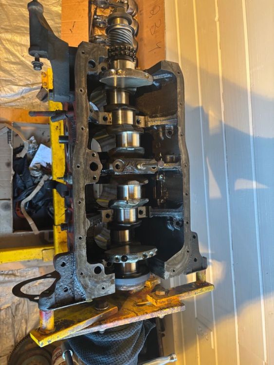

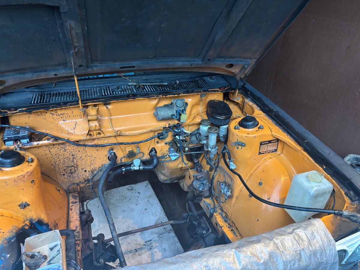

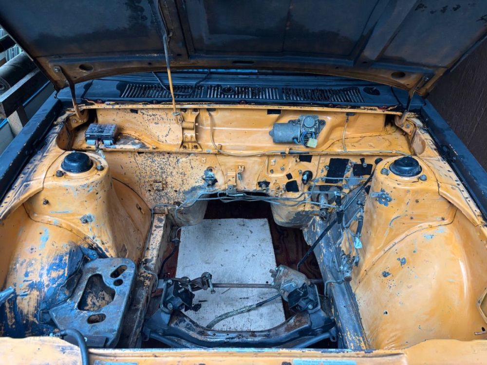

ScaryPony Posted March 2 Author Report Share Posted March 2 (edited) On 2/23/2026 at 6:58 PM, datzenmike said: They are heat treated after forging but then they would all be blue. Confirmed. All cheeks are blued. What’s the word on the oil pressure relief valve? Replacement part? Leave it alone? I heard from a reputable source that often race guys plugged it, not sure if that makes sense in a road car? Both motors are stripped now. Pressure washed, dried. Picked up an l18 crank over the weekend. Rods and flat tops coming soon. Once those are here, over to the machinist. also I gave the engine bay some love. Needs more before the motor goes back in but it’s a start. Will take closer look at bearing surfaces but fit was still tiiiight. Spun free. Didn’t notice any immediate major wear or grooving. Edited March 2 by ScaryPony Quote Link to comment
