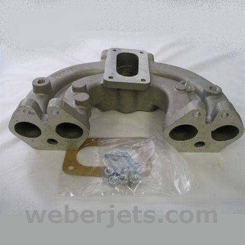

Carl Handratty Posted February 18 Author Report Posted February 18 Need to post on the parts wanted and see if any one has a 99002.825 Datsun L Series Weber Downdraft Manifold available? I'd love to run one on this engine. I think I wanna try my hand at EFI like a few others on the site and this seems to be a good option for the flange attachment and just overall air performance. Top End Performance says they're backordered everywhere because of a foundry issue. Quote
datzenmike Posted February 19 Report Posted February 19 Pretty sure they are no longer made, there's not much of a market. Besides there's no real world performance gain. The outer runners are different length than the middle two, unlike the stock manifold. I would spend the money saved on an EI distributor. 1 Quote

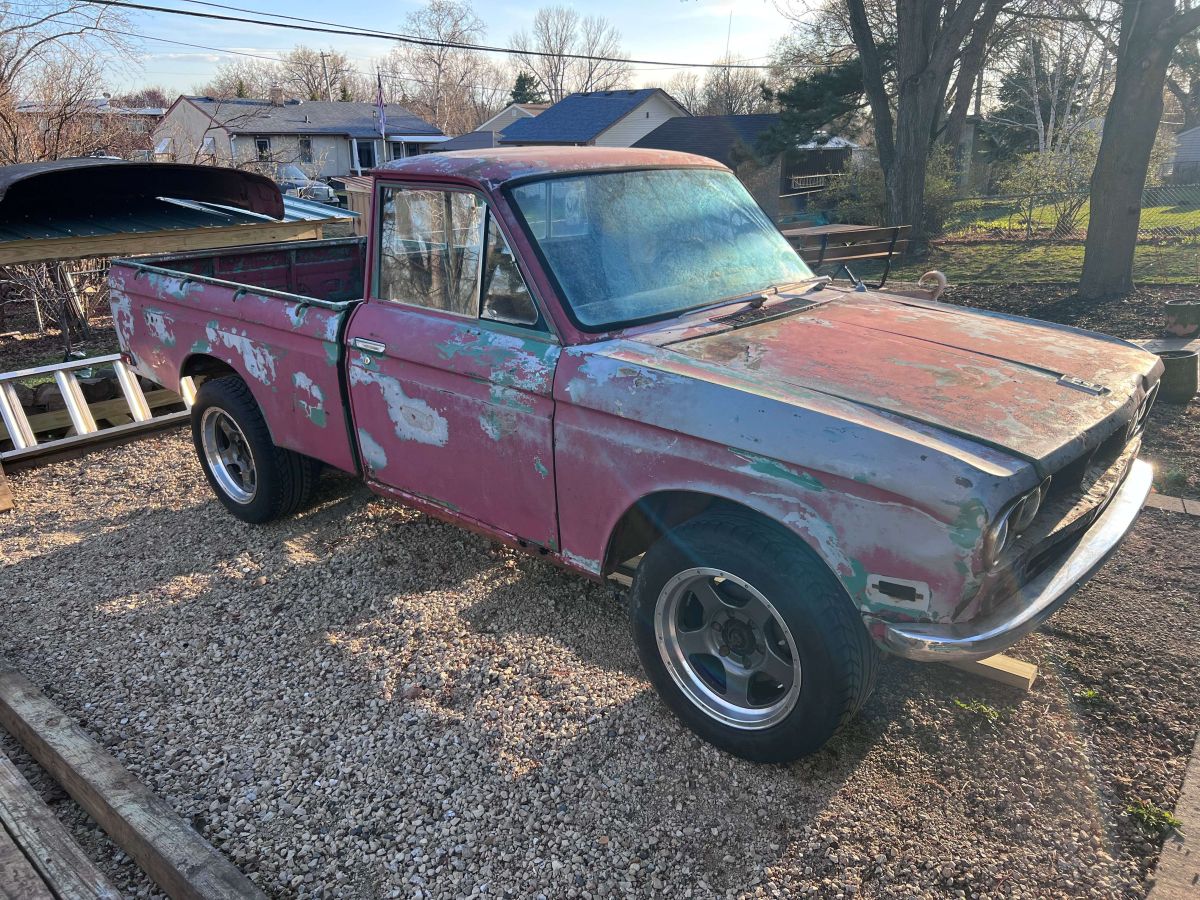

banzai510(hainz) Posted February 19 Report Posted February 19 that motor has a diffent fuel pump that standard 510/521/ Is this a L16 maybe a different motor installed? wheels look good. I would have filled the bed with nice soil an make a planter box of of the truck in front of house.(Ok just joking) 1 Quote
Carl Handratty Posted February 19 Author Report Posted February 19 1 minute ago, banzai510(hainz) said: that motor has a diffent fuel pump that standard 510/521/ Is this a L16 maybe a different motor installed? wheels look good. I would have filled the bed with nice soil an make a planter box of of the truck in front of house.(Ok just joking) Dang! Opportunity missed to have a rolling garden bed! Still time I guess! Can you imagine some 8' sweet corns in a perfect row back there? Haha perfect Midwest build. You know with the l87 head and the exhaust header, I'm wondering if they did some work on this thing at some point. It is a L16 on the tag by the dippy. Quote
Carl Handratty Posted February 19 Author Report Posted February 19 Some nice snowy pics of the Dats. Can see I got the flower bed shoveled out of the back. Only a couple pin holes near the passenger wheel well. I was really happy to see how solid the metal was. Quote
datzenmike Posted February 19 Report Posted February 19 I see you have the deluxe emergency brake there. I use... Quote
datzenmike Posted February 19 Report Posted February 19 When you pull the head, it may need work or replacement, that's the time to lift the header out and weld it up. Sand blast it and spray with header or high temperature paint to get a few more years out of it. Quote

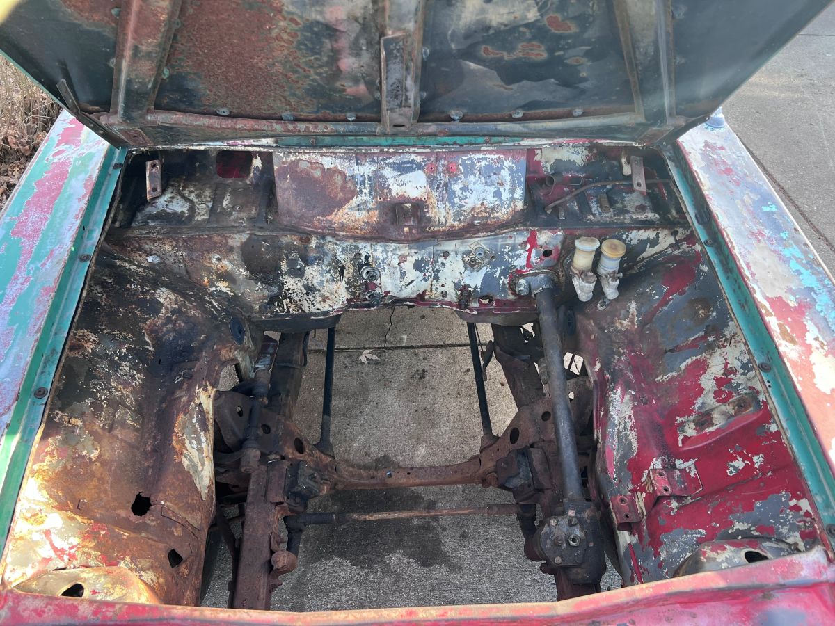

Carl Handratty Posted April 27 Author Report Posted April 27 Slow Spring in MN with with quite rainy and cold weather. I got the engine and trans removed so it was easier to push on the pad behind the garage. Sold the motor and transmission to a local guy with a 520 and 521. I'm not one keep a lot of excess in the garage so on to the next guy who could use it. Dats is always on my mind but I have a '54 Chevy 210 that a needed a new power steering rack and a '70 Honda CL100 that needed the fuel tank lined and I installed an electronic ignition in it so getting those ready for the season has been priority. On the plus side the wife said "it looks good back there like lawn art" so I'm taking that as a win and that she's ok with seeing outback for the foreseable future haha. The 3 year old loves climbing all over it and "fixing it" with sticks... 1 Quote
NC85ST Posted April 28 Report Posted April 28 Looks like you removed more than just the engine and transmission! What’s the plan for powering it? Quote
Carl Handratty Posted April 30 Author Report Posted April 30 On 4/28/2026 at 9:50 AM, NC85ST said: Looks like you removed more than just the engine and transmission! What’s the plan for powering it? Yeah...I plan to do a full restomod truck so Summit Racing will be in business for at least another year or two haha. Man, I really keep falling back onto a KA24E or KA24DE(T) swap but I am open to any other 4cyl that could be fun NA or Turbo, still trying to decide that too. I like the simplicity of a NA setup but I have never run a turbo so I kind of want to dabble. Other engine considerations were 22R, 22RE, SR20DET and if I really wanted to suffer a bmw engine. I love the idea of the "axis" truck build haha. Are you running the 1.6L in your 521? Quote
