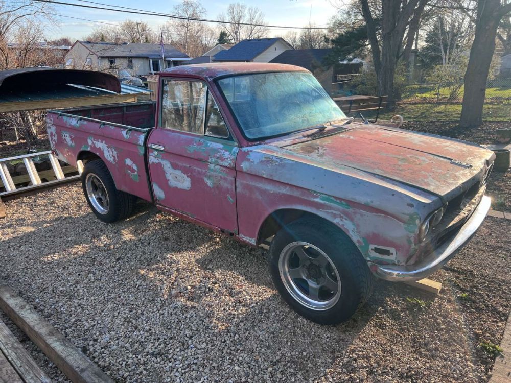

Carl Handratty Posted January 28 Report Share Posted January 28 Hey all, Welcome to my build thread. I just put $200 down on a $600 1971 Datsun 521. The Wisconsin plate on it says 1998. The motor is free, the glass is crack free, the doors close perfectly even with the roof damage from presumably a tree, zero through rust on the frame or truck bed. Floor pans at the crease to the firewall and the rockers have some holes. Hood is kinked. The grille was in the back of the pickup (whew!) The tail lights on the seat were a surprise to find after seeing the rears installed one smashed and the other missing. I bought new 15x8.5" wheels for it already to get it rolling onto the trailer. My plan is to get the OG motor running if it has compression otherwise KA swap it. I am planning on leaving the peeling red paint job and moss and lichen on there as long as possible 🙃 SWMPTHG plates might be ordered when titled 😁 Tell me what you see on this truck!!! I think the back window is aftermarket. I think the Carb is aftermaket (nikki?) I think it has a header on the exhaust manifold. The bench seat may or may not be original. The radio and glove box are missing as well at the ashtray lid. no key 🫣 Anyway, I know us goons like photos so. HERE YA GO. Also I tried for 20 mins to put photos on this thread so you didn't have to go to my google drive with the drop. If you can tell me how to get them on this thread I'll update it. https://drive.google.com/drive/folders/1oGe9HMhNkflRWjw9VrEB5ge8Iv8jviiB?usp=sharing 2 Quote Link to comment

Carl Handratty Posted January 28 Author Report Share Posted January 28 10 minutes ago, banzai510(hainz) said: I think the guy should have paid you to take it off his land. keep us posted wires cut, no fuse box??????? I guess your good with a FLUKE multimeter. I know 521s but this would be too much for me. HAHA. Yeah, well he did have 3 people offer up on the tailgate for a garage decor and a couple more who said they'll pay if he got a title. I'm...more robust you might say haha. And this is why I posted every photo I could haha. I didn't notice the fuse box was cut. Will likely just pull it all and do a painless kit. I like wiring. I also have experience with classics I rebuilt entirely a 51 Chevy Fleetline (slantback), 52 pontiac chieftain hardtop, and I currently own a 54 chevy 210. So I know what i'm getting into more or less. 🤪 Quote Link to comment

datzenmike Posted January 28 Report Share Posted January 28 Looks like a 620 steering wheel, the other one on the floor is probably from a 610? Carburetor is cheap knock off and from a different Datsun. The '71 didn't have a BCDD or an idle cut solenoid. Yes fuse box is gone. Fuel pump is not original but the spare tire is! Bridgstone 6:00 x 14 and 6 ply rating. If all four were original your kidneys would bleed from the rough ride. 111800 or maybe even 211800 miles on it. After market slider rear window. Seat looks very original condition. 1 Quote Link to comment
Carl Handratty Posted January 28 Author Report Share Posted January 28 Just now, datzenmike said: Looks like a 620 steering wheel, the other one on the floor is probably from a 610? Carburetor is cheap knock off and from a different Datsun. The '71 didn't have a BCDD or an idle cut solenoid. Yes fuse box is gone. Fuel pump is not original but the spare tire is! Bridgstone 6:00 x 14 and 6 ply rating. If all four were original your kidneys would bleed from the rough ride. 111800 or maybe even 211800 miles on it. After market slider rear window. Seat looks very original condition. I knew you’d be on here eventually Mike! Thanks for the knowledge as always! Why the heck would they cut out the fuse panel?? Ughh. That’s gonna make things more interesting. Quote Link to comment

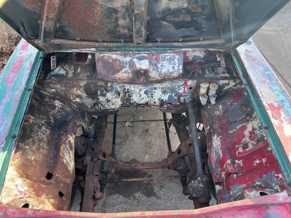

Carl Handratty Posted February 16 Author Report Share Posted February 16 Oh, I’ve got the truck back, took it apart and power washed it. I’ve just been deterred from getting posts up because I need to make an imgur accnt or whatever to add photos on here. Not used to that style of uploading compared to other forums. I’ll get pics up hopefully tomorrow. the Mosstun looks so much better after a couple hour bath 😆 Also, really considering using the original powerplant to get it back on the road even after 30 hours or research on 13b, ka24, sr and rb swaps. But I know a lot more about those engines now. Quote Link to comment
Carl Handratty Posted February 18 Author Report Share Posted February 18 Alright, I had to upload my iPhone HEIC pics to Google Drive, DL them, Upload those to a HEIC to JPEG site, DL them again as JPEG, Upload them to IMGUR then paste the link here. Am I missing something? What a PITA. Truck moving after 38 years parked. Only the back passenger tire was free. Once we got it home we banged on the drums until they came off but not without a lot of rage. Here it is after a painful trailering experience with 3 wheels locked up. Would have been impossible without the skid loader and forks. Some decades to remove. Finally scooped this out today. Was all a frozen ice block for the last two weeks but its been in the 40s here in MN the last 5 days. I think I'm going to keep the 1.6L or look for a 2.0L while I get the body ready. I had all these plans to replace it with a 2.4L but I kind of like the option of keeping it semi original. Driver floors need replacement. Driver door is likely a replacement. The inside is reddish orange unlike the rest of the green truck. power washed the truck, was hoping more red paint would be blown off. Power washed all of the grime off. cold compression numbers just turning it over. Haven't started the engine yet cuz the carb is thrashed and the plug wires are trash and broken. Not to mention my wiring harness is cut out. Cylinder 4 was super jumpy. Sometimes 20psi then the next time 40psi and so on. Either way, not super valuable numbers because the engines not warmed but there IS compression so that's hopeful. I'm going to rebuild it anyway. C2-3 I put oil in after the original test and they said more or less the same. C1 went from 0 to 20-25 PSI after a squirt of oil so that's better than stuck. Quote Link to comment
datzenmike Posted February 18 Report Share Posted February 18 Better check the engine ID. It's right behind the dip stick handle. Might be an L18. The head is totally wrong for the L16 but they were used on the L18 and L20B. This would also explain the clutch fan as no 521 came with one and the silver block paint. Those are terrible compression numbers. Did you get it with the carburetor off? Rainwater may have gotten in over the years and rusted the valves and seats. Quote Link to comment
Carl Handratty Posted February 18 Author Report Share Posted February 18 1 minute ago, datzenmike said: Better check the engine ID. It's right behind the dip stick handle. Might be an L18. The head is totally wrong for the L16 but they were used on the L18 and L20B. This would also explain the clutch fan as no 521 came with one. Those are terrible compression numbers. Did you get it with the carburetor off? Rainwater may have gotten in over the years and rusted the valves and seats. The little tag says L16. Yeah compression is abso f'd. The carb was on it but was off for testing and the intake looks obstruction free from what I can see. All the plugs were out to allow easier turn over. Who knows why it was parked in the first place. Figured it would need the full treatment. Quote Link to comment
