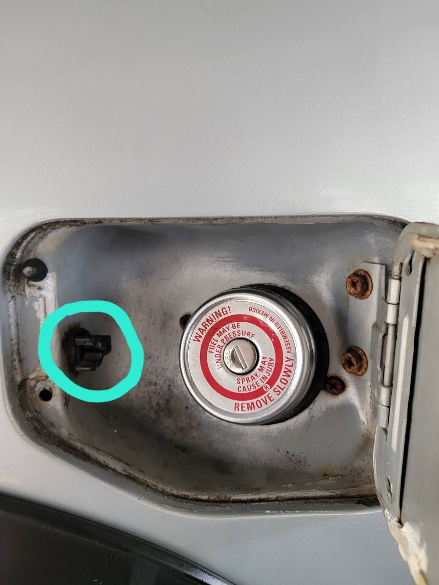

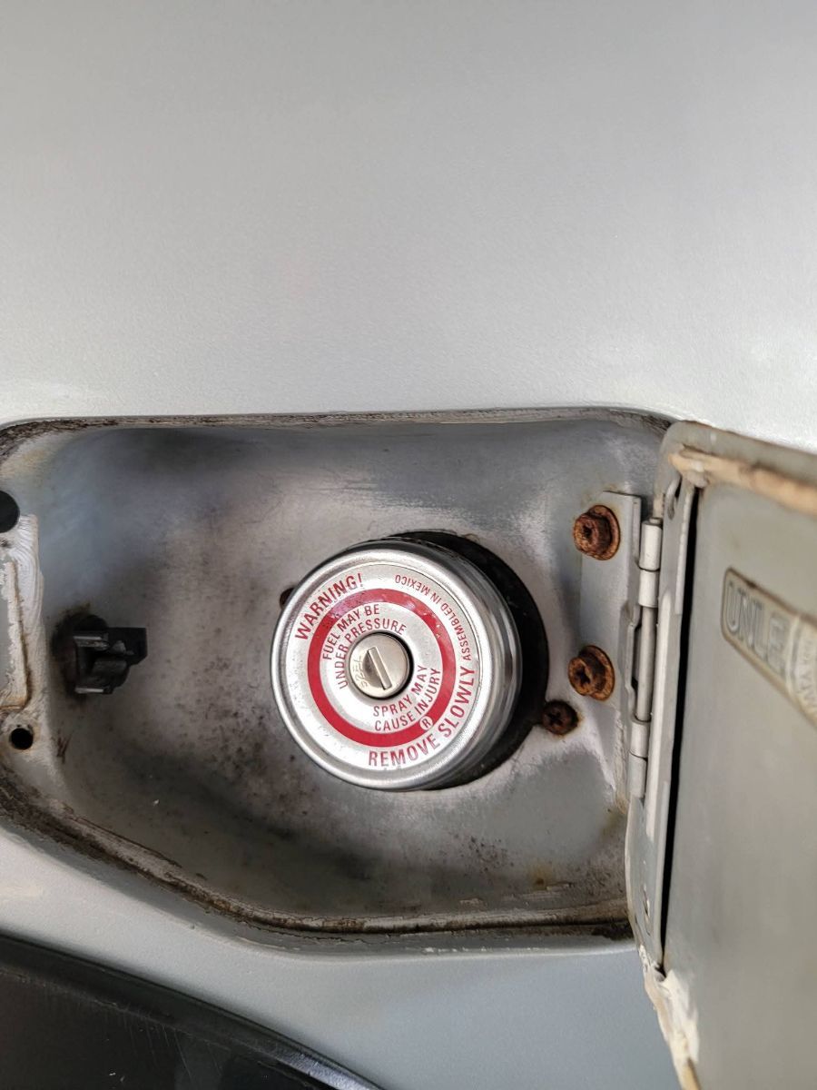

Thomas Perkins Posted January 2 Report Share Posted January 2 (edited) Happy Friday ya'll.I am looking for the black piece that is inside the fuel door that keeps the door shut.I want a spare.As you see in my picture.One of the Black rubber bumper is missing.Nissan still sells them.I just ordered 2 from a Nissan Dealer on Ebay.I looked on Nissan parts deal.com at the pictures and cant find that black piece with number.I did replace the piece that goes into it long ago and have a brand new Nissan one as a spare.So if anyone has the part number and name of it to that black plastic piece, let me know.What I have circled? Edited January 2 by Thomas Perkins Quote Link to comment
Thomas Perkins Posted January 2 Author Report Share Posted January 2 (edited) Looks similar to the hood prop clip.I will see if it is the same.No,It will not work. Edited January 2 by Thomas Perkins Quote Link to comment

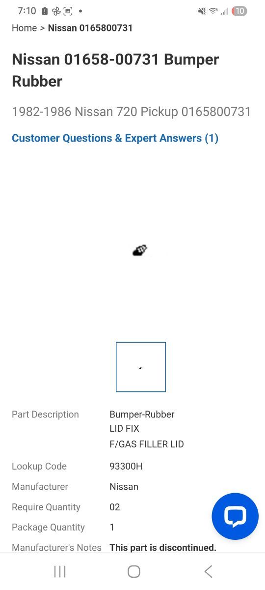

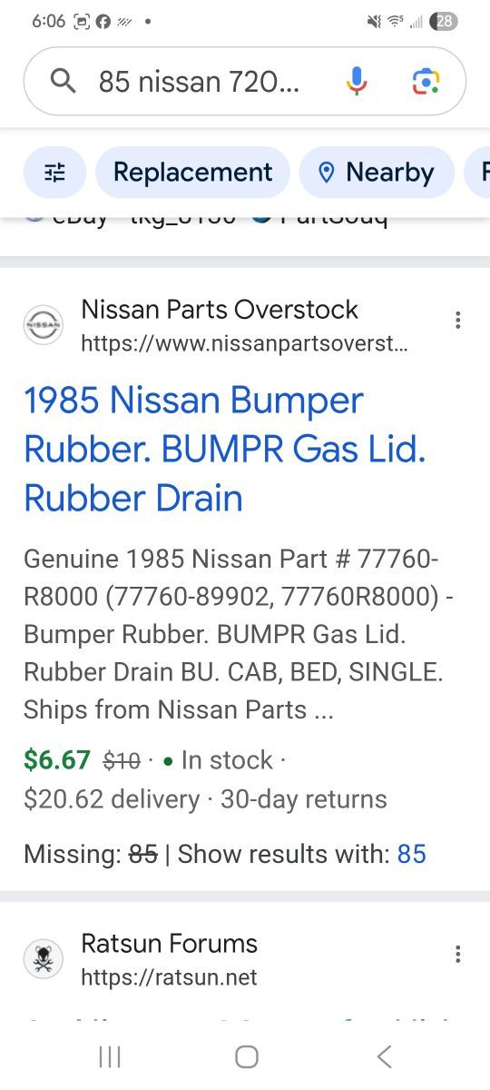

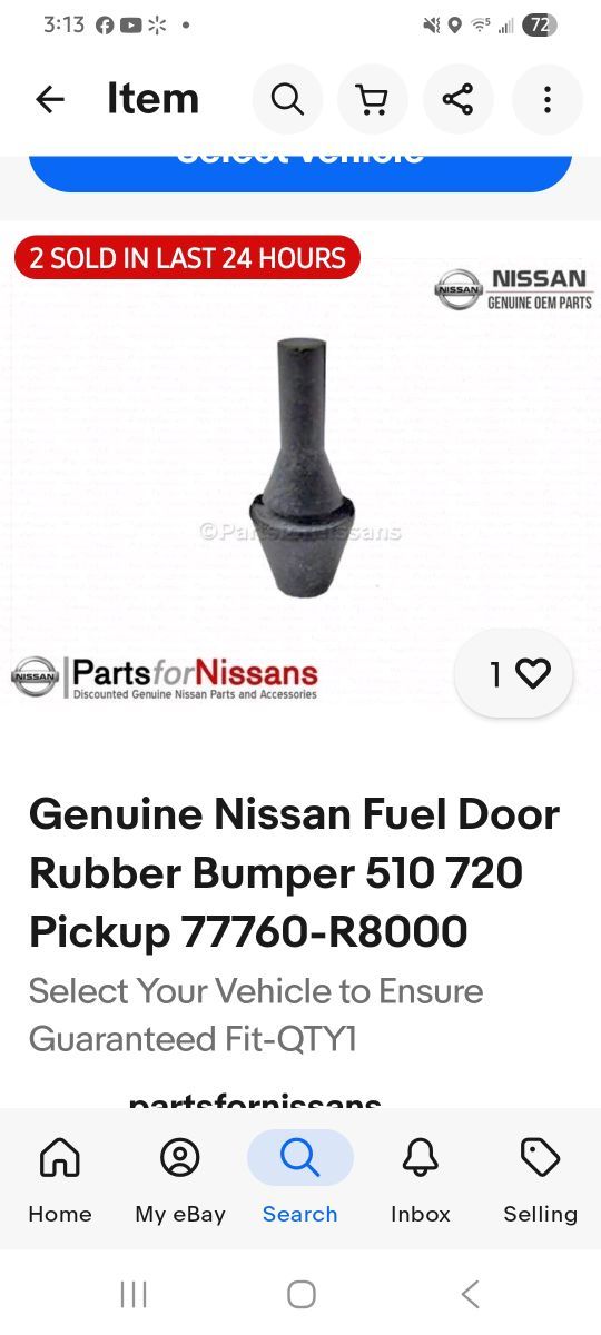

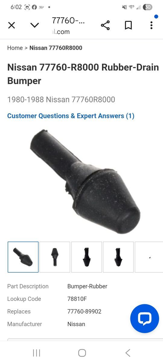

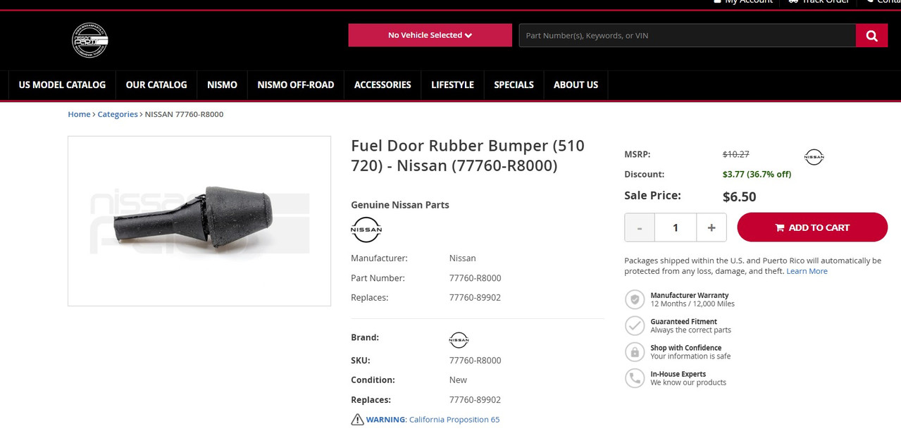

Thomas Perkins Posted January 2 Author Report Share Posted January 2 (edited) Nissan is very funny on there parts.They change the part numbers then they say they dont fit your year.The rubber bumper for the gas opening has changed to another part number and is listed just for 80-83.So if you go hunt for the 85 one.It is not listed.Some other sites that sell them say for 80-88.The Nissan site on Ebay that I just bought from had me send them my vin number to make sure they fit.They sent a message saying that the the old part number that is replaced by the new part number has been discontinued.I never found a part number for the 84-85 ones in the Nissan part deal.com.He asked if I wanted to cancel the order.I told him no.Lots of times, when I order parts from a Nissan part seller on Ebay and I give them my Nissan year and it may say not for my 720 and I ordered it and it is made for it.He said it was for a 85 Stanza.Nobody can find the black clip that holds the door shut.May be under 83.I will look.Here is the Nissan message...The part you ordered is incorrect for the VIN# provided, these are made for 1985 Stanza sedan and hatchback. The correct part # you need is discontinued. Please let us know if you want us to ship out the part you ordered. If not, please cancel the order and we will approve cancellation. Edited January 2 by Thomas Perkins Quote Link to comment
Thomas Perkins Posted January 3 Author Report Share Posted January 3 I dug deeper and I just canceled my order.Here is my part that has been discontinued.He was right. Quote Link to comment

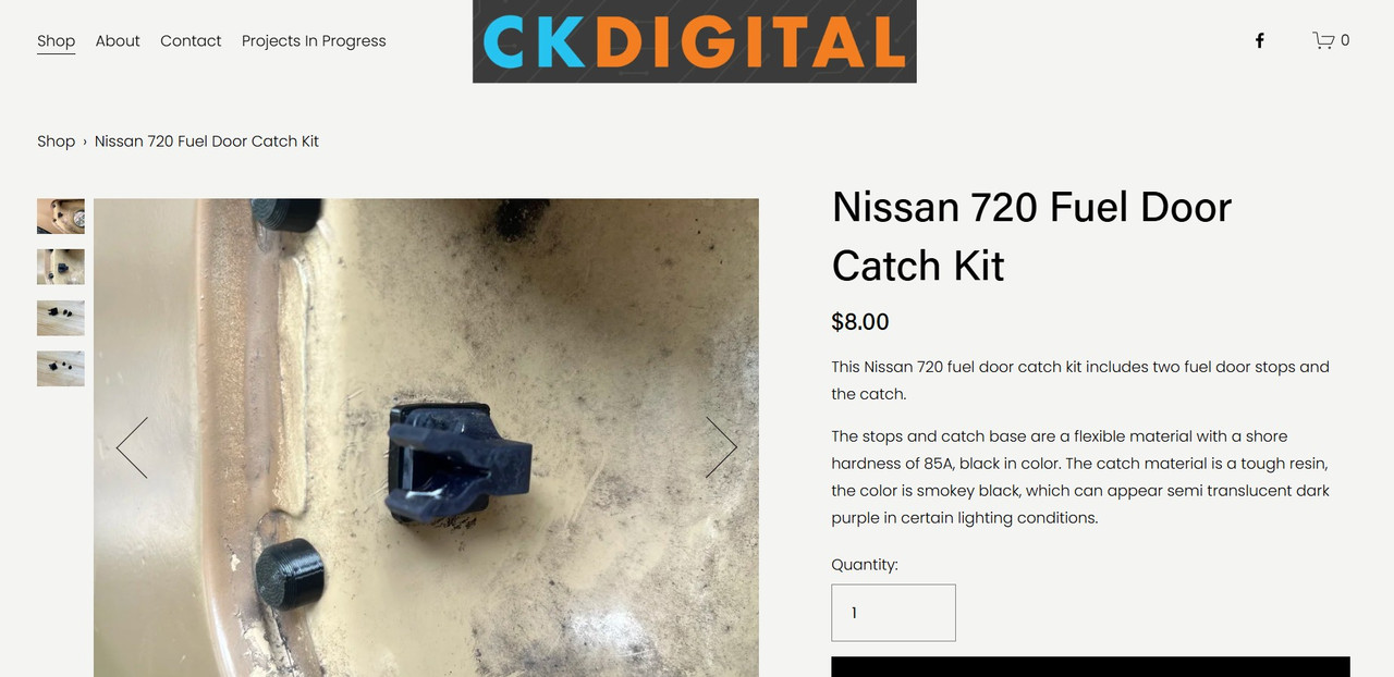

Hankford Posted January 3 Report Share Posted January 3 New here and assuming I shouldn't post links to outside websites. I believe this is generally what you want, although it's not Nissan. I used CK's hood prop for a while and thought it was great. Here's a source for a Nissan bumper. 3 Quote Link to comment

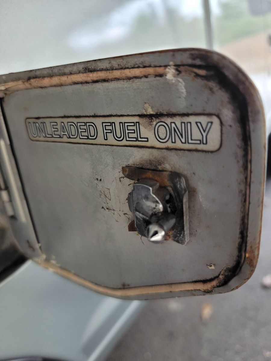

Thomas Perkins Posted January 4 Author Report Share Posted January 4 I had a friend riding with me years ago.I stopped to get some gas.He jumped out and decided to pump the gas.He broke the piece that goes into the black piece with the gas nozzel.It connects on the gas lid. with a metal clip holding it on.I was pissed but didn't say anything to him.So I bought 2 of them.I still have one in the Nissan box.Glad he didn't break the black piece. Quote Link to comment

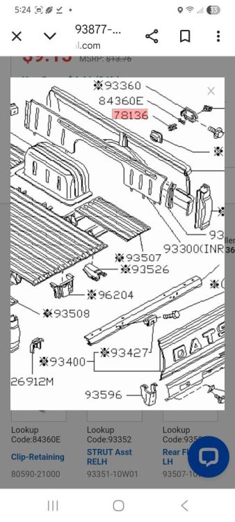

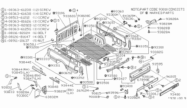

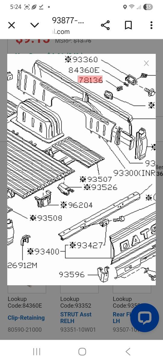

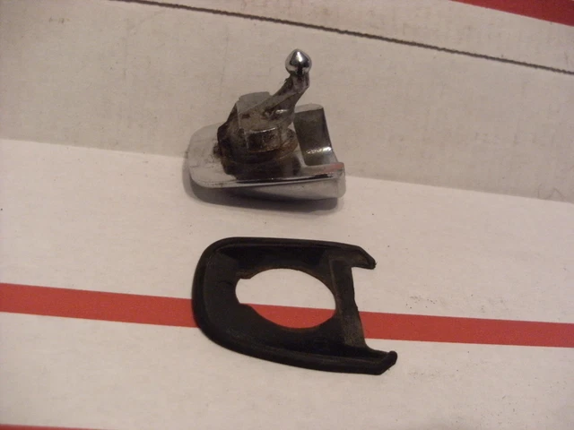

Thomas Perkins Posted January 4 Author Report Share Posted January 4 (edited) Here is the black plastic piece that I was looking for.Cant find it on there page with pictures.On the Nissan site it shows a part with 78136 but if you enter it nothing comes up.But here it is with the part number.Now I have a part number.Maybe a over seas Nissan site has them.Time to look. Edited January 4 by Thomas Perkins Quote Link to comment
Thomas Perkins Posted January 4 Author Report Share Posted January 4 Cant find.If you were to find it at a junk yard.You would need to get needle nose pliers and pinch it from the other side.From the back side so it wont break.Oh well.My look is over.At least I found the part number. Quote Link to comment

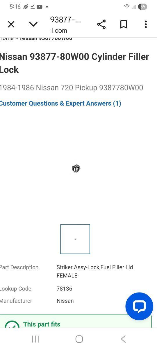

DwayneOxford Posted January 5 Report Share Posted January 5 1 hour ago, Thomas Perkins said: Cant find.If you were to find it at a junk yard.You would need to get needle nose pliers and pinch it from the other side.From the back side so it wont break.Oh well.My look is over.At least I found the part number. https://www.nispartsexpert.com/product/cylinder-filler-lock-nissan-93877-80w00-40379/ Quote Link to comment
datzenmike Posted January 5 Report Share Posted January 5 78136 is a 'reference number' used to find the part number location. Can't find it before '85? 93877-80W00 is STRIKER ASSY-LOCK, GAS FILLER, FEMALE. (I guess the plastic part) 78840-80W00 is the LOCK ASSY, FILLER LID, MALE. ( I guess the metal rod part that fits?) Quote Link to comment
