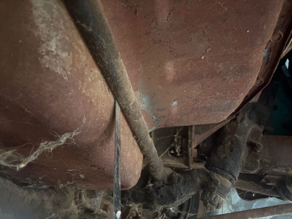

Benannah Posted December 4, 2025 Report Share Posted December 4, 2025 Hey all! For the last year and a half I have been the very proud owner of a 1983 Nissan 720 4X4 Truck. Over the past few months I have noticed that my rear seems to be sagging more and more. This is of course not a huge surprise give the age and the fact I have a fiberglass topper and a wooden bed drawer, but it is an inconvenience none the less. Today I went to look at the arc of my rear leafs only to find that they are now bent almost completely straight. I have been looking at ways to fix this issue, but have not come up with a ton. Please offer any and all advice you may have for dealing with this issue! Some things to consider: - I am on a tight budget of $250 as I am a college student - This fix must be something a friend and I could pull off in a weekend or maybe two - I would still like my truck to have near stock suspension travel as I enjoy light off-roading - Quality of ride isn't too awful (but I am not seeking perfection here) *Note - I am open to some wild ideas here as long as they will work! Some ideas I have tossed around so far include replacing the stock springs with those for a trailer (problem I ran into is none of them are long enough), buying shock/coil spring combos to replace my current shocks (unsure if this idea would even work, but I love the idea of it), or even sticking a cheap air suspension bag in parallel with each spring (unsure if it would give me enough suspension travel) Quote Link to comment
