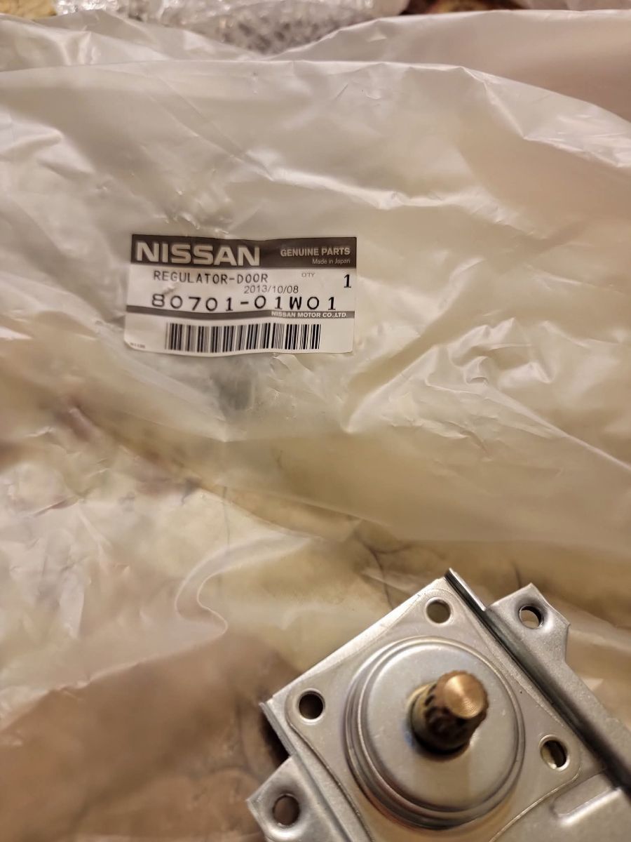

Thomas Perkins Posted November 22, 2025 Report Posted November 22, 2025 (edited) HI ya'll. I am in need a of a driver side window regulator.Mine is bad.When I go to roll up window,the handle will turn but window does not go up at times.I can roll up some, then grab window and pull all the way up to where it completely closes.I have found a brand new Nissan one from over seas at a great price.The Nissan one's were 127.00 when they had them in stock.I found one for 37.58 and 20.58 shipping.So I will order it.I have bought stuff from over seas Nissan dealers with no problem.This will be a first on this site.They have a good rating.I want a new one.So what is involved in removing old one and installing new one.I have took chances on buying parts over seas and and batting. 1000. Edited November 23, 2025 by Thomas Perkins 1 Quote

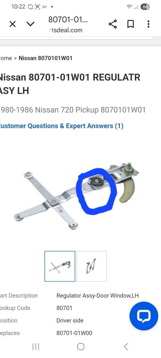

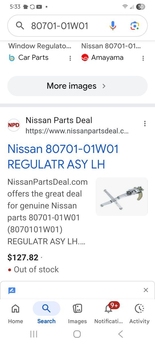

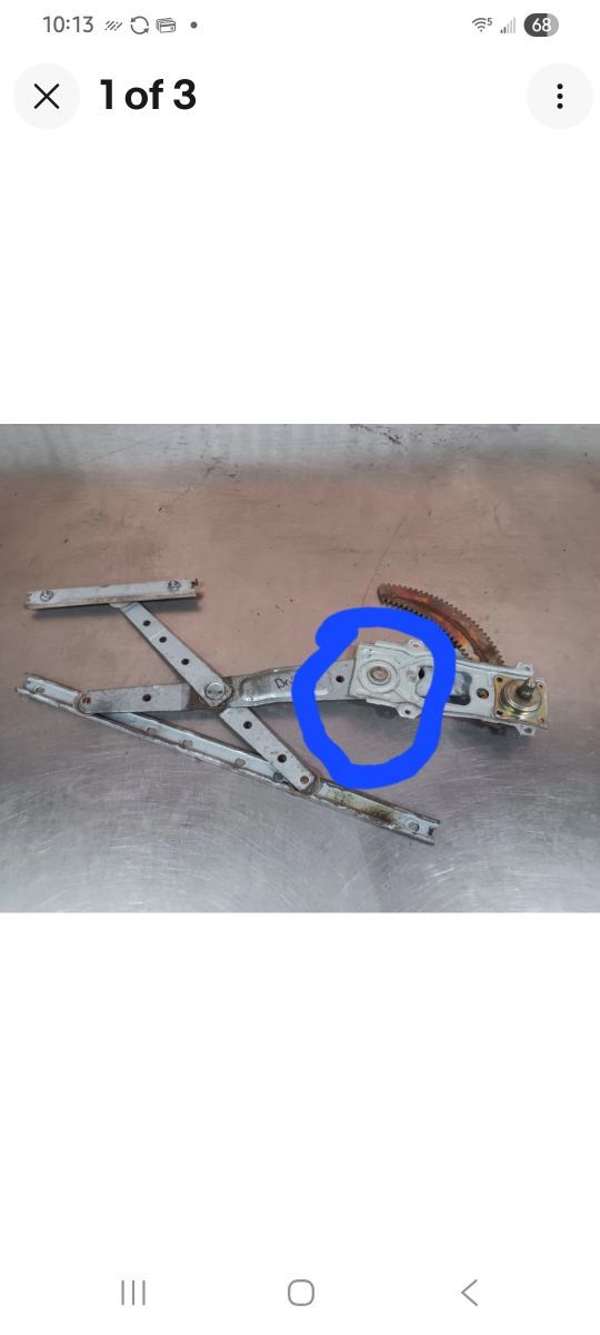

Thomas Perkins Posted November 26, 2025 Author Report Posted November 26, 2025 (edited) I have not heard from them.I guess they dont have any.Here is a used one that is on Ebay.It looks different than the one from Nissan parts deal.The round black part is not on the ebay one.What do you think?Does anyone have a picture of one? I can take the panel off and see but rather not.All the after market ones have the round black piece.Is it a spring.Got to be careful buying used parts.As is. Edited November 26, 2025 by Thomas Perkins Quote

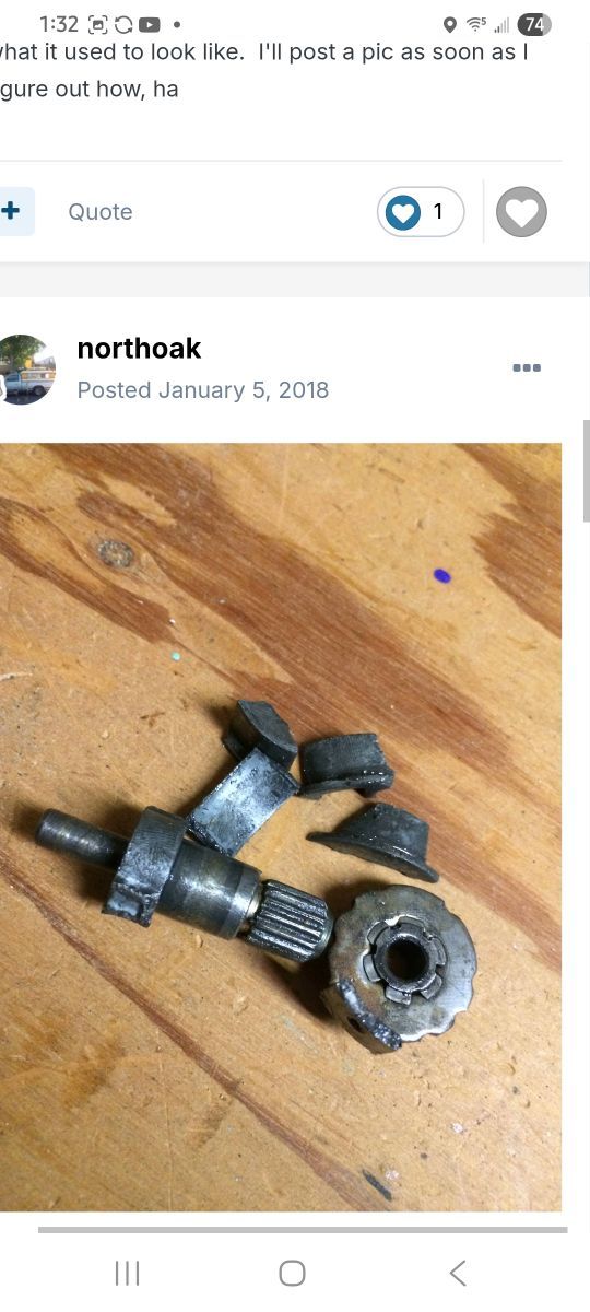

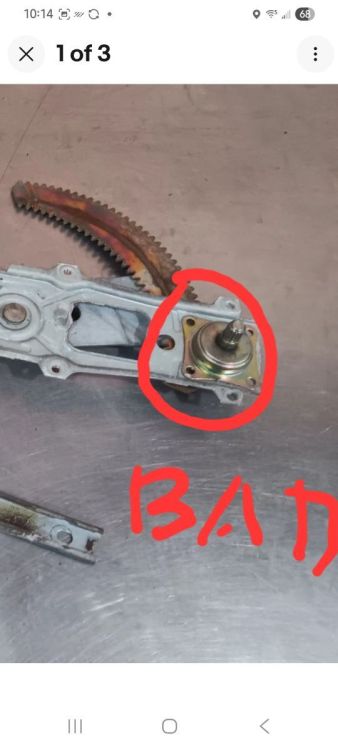

Thomas Perkins Posted November 26, 2025 Author Report Posted November 26, 2025 (edited) I believe the part that the door crank is attached to is bad.It is wobbly and not turning the gear teeth part properly.I have to jiggle door crank to get it to turn.But it will not connect good and roll window all the way up.So I grab the window and pull it up and it shuts completely.My Haynes manual shows how to replace.My FSM does not.Good to have both books. Edited November 26, 2025 by Thomas Perkins Quote

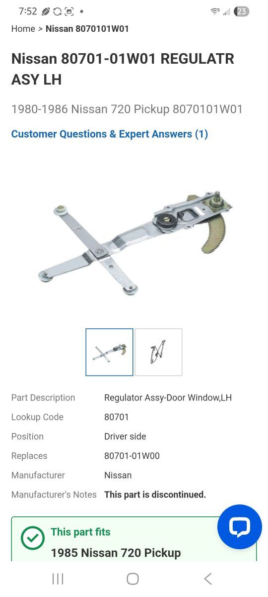

Thomas Perkins Posted November 27, 2025 Author Report Posted November 27, 2025 (edited) After looking at both Nissan window regulators.The new one on the Nissan site and a old one for sale on Ebay.I have also seen a few other used Nissan ones.The Nissan site has a upgraded part number for the regulators.Both sides.So the new ones has a black round spring tensioner on it.Also the after market ones do to.That is probably why mine went bad.So I will not get the used one on Ebay.I believe that spring is needed to make the mechanism work properly and keep it aligned with the part with the teeth in it.So I will throw the dice and get a new after market one.Nissan also should have seen how bad there carbs were and retooled them and made them better. Edited November 27, 2025 by Thomas Perkins Quote

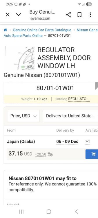

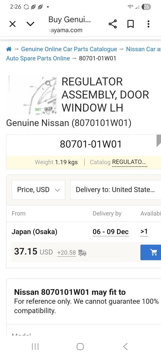

Thomas Perkins Posted November 27, 2025 Author Report Posted November 27, 2025 I just checked my email and the over seas company Amayama sent a email saying the Nissan left side window regulator is available.They jacked the shipping from 20.58 to 86.56 and duties fees from 20.58 to 15.06.Part was 37.15.Now it is 34.84 for a total of 136.46.First total was 78.23. Is 58.23 more.The new after market one on Ebay that is from Thailand is 75.76 total.A difference of 60.70.About a tank and half of gas.Gas is 2.49 a gallon here.So what should I do.If I get the after market one and it dont fit.I will be stuck paying for shipping it back.They said it will be here December 13.Has anyone bought from Amayama.I read there reviews and they are good. Quote
Thomas Perkins Posted November 27, 2025 Author Report Posted November 27, 2025 Here is the part that is bad.This is not it.I found this picture on this site. Quote

720_Jeff Posted December 3, 2025 Report Posted December 3, 2025 On 11/26/2025 at 9:34 PM, Thomas Perkins said: Has anyone bought from Amayama.I read there reviews and they are good. I've purchased plenty from Amayama. They are good. Meticulously packed, package always looks great. Of course, contents arrive in great condition as well. Prices are good, shipping is fair. I was thinking your original shipping estimate was far too low, given the size and weight of the fully packed item. Quote
Thomas Perkins Posted December 3, 2025 Author Report Posted December 3, 2025 (edited) I seen a Nissan site here that had the regulator at 127.00 when they had them in stock.That is how they operate.They will give you a price for the part and price for duties,taxes and fees, and shipping.That is just a estimate.Then they will look to see if they have the part.If they do,they will have it sent to them and send it to you.They told me that the part was found and was being sent to them.Then they will send to me.It is on the way.I have a tracking number.It is coming by Fed Ex I.The worst shipping company.They will damage it.They damaged my Nissan grill and my wife's rack and pinion.But Rock Auto Parts and a seller on Ebay sent replacement parts.My yard has a security gate.Cant get in.So they threw them over the fence.I seen them.I still have both damaged parts.They did not want them back.Both can be repaired. Edited December 3, 2025 by Thomas Perkins Quote

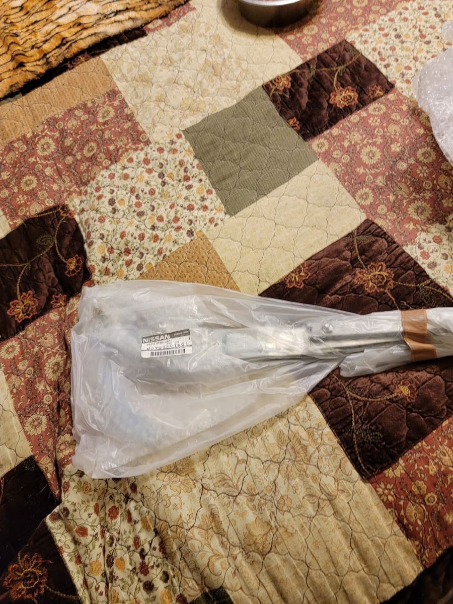

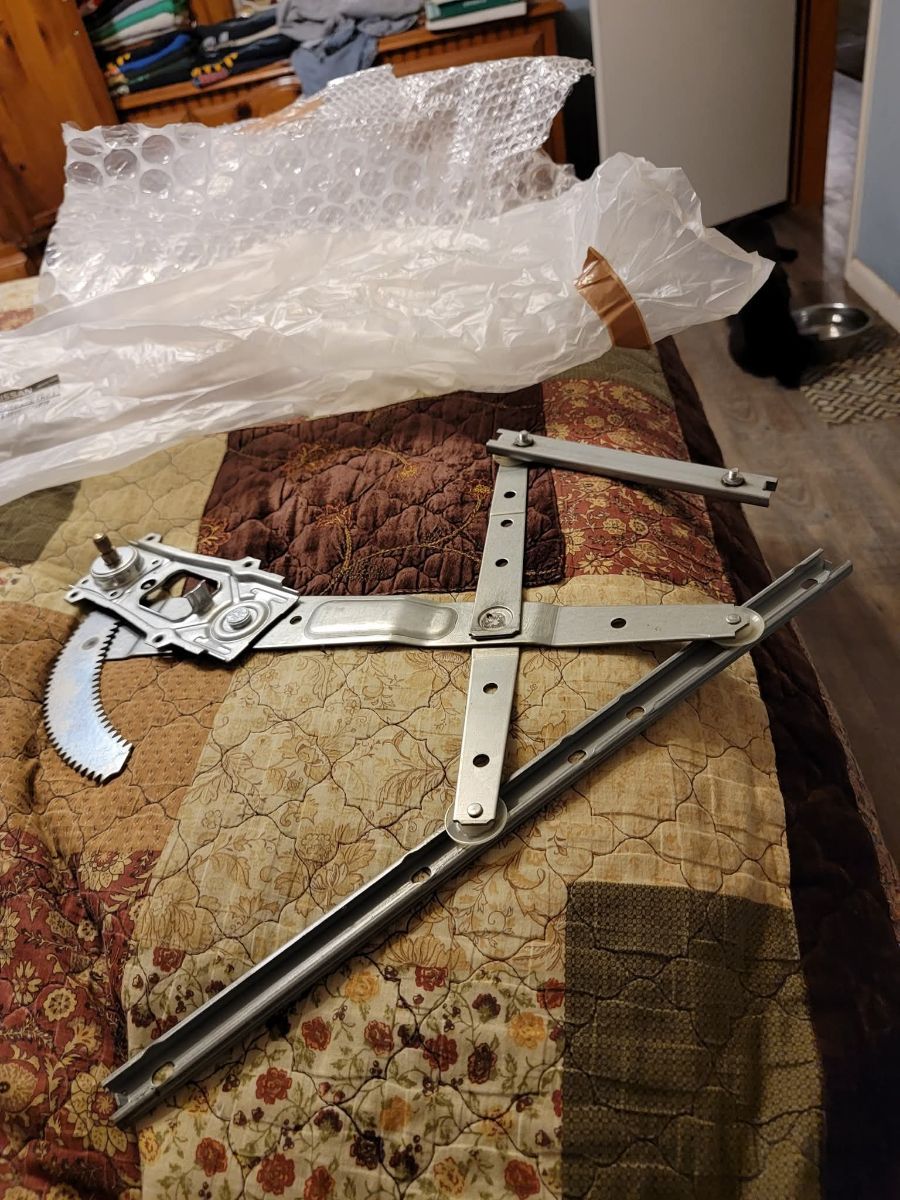

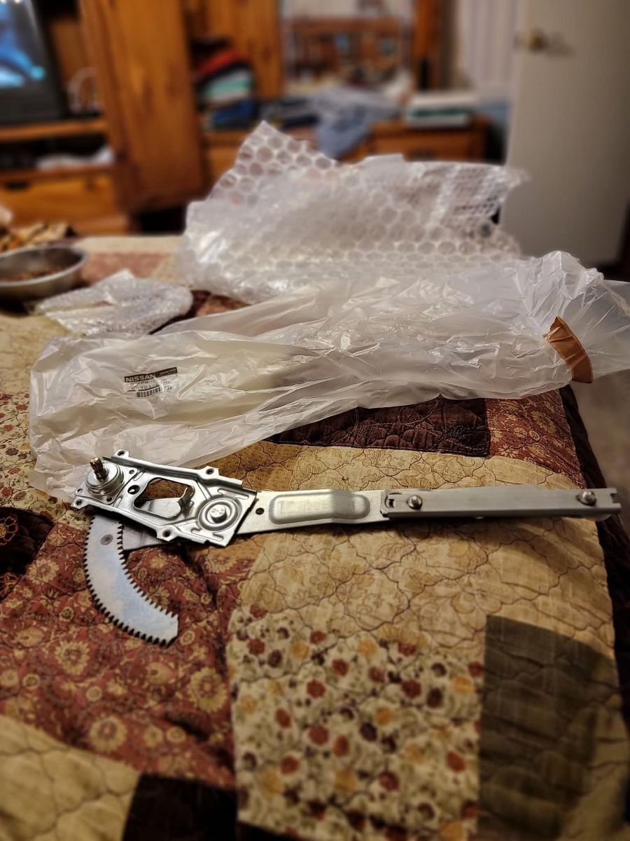

Thomas Perkins Posted December 8, 2025 Author Report Posted December 8, 2025 (edited) My driver side window regulator came in today.It is nice.When I get time,I will install it.When I get the old one out.I will show it next to the new one and what is wrong with it. Now when I go to turn the window crank, it just turns and window does not do anything unless I force the crank in and that may turn it a hair. Edited December 8, 2025 by Thomas Perkins Quote
Thomas Perkins Posted December 8, 2025 Author Report Posted December 8, 2025 (edited) I ordered a thermostat from Nissanpartsdeal.com.They took money out from pay pal and today they sent a text saying part is discontinued.I bought one back in Nov. 9 2024 from a Nissan Dealer on Ebay.So I guess they are available no more.Mine is good.I was just buying a spare.They show on there site that they have it.Never bought from them and never will cause of this.Liars. Edited December 8, 2025 by Thomas Perkins Quote

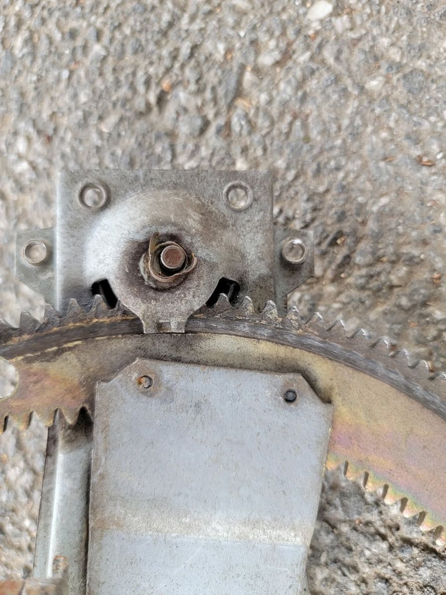

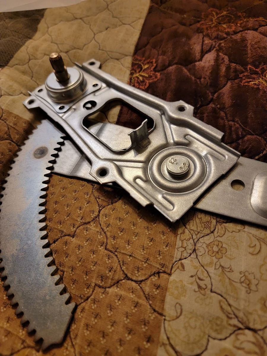

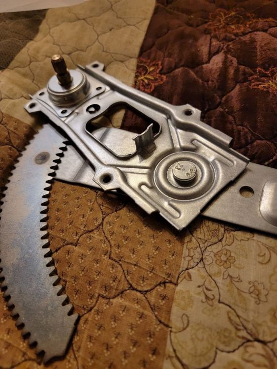

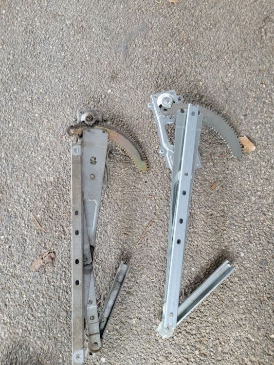

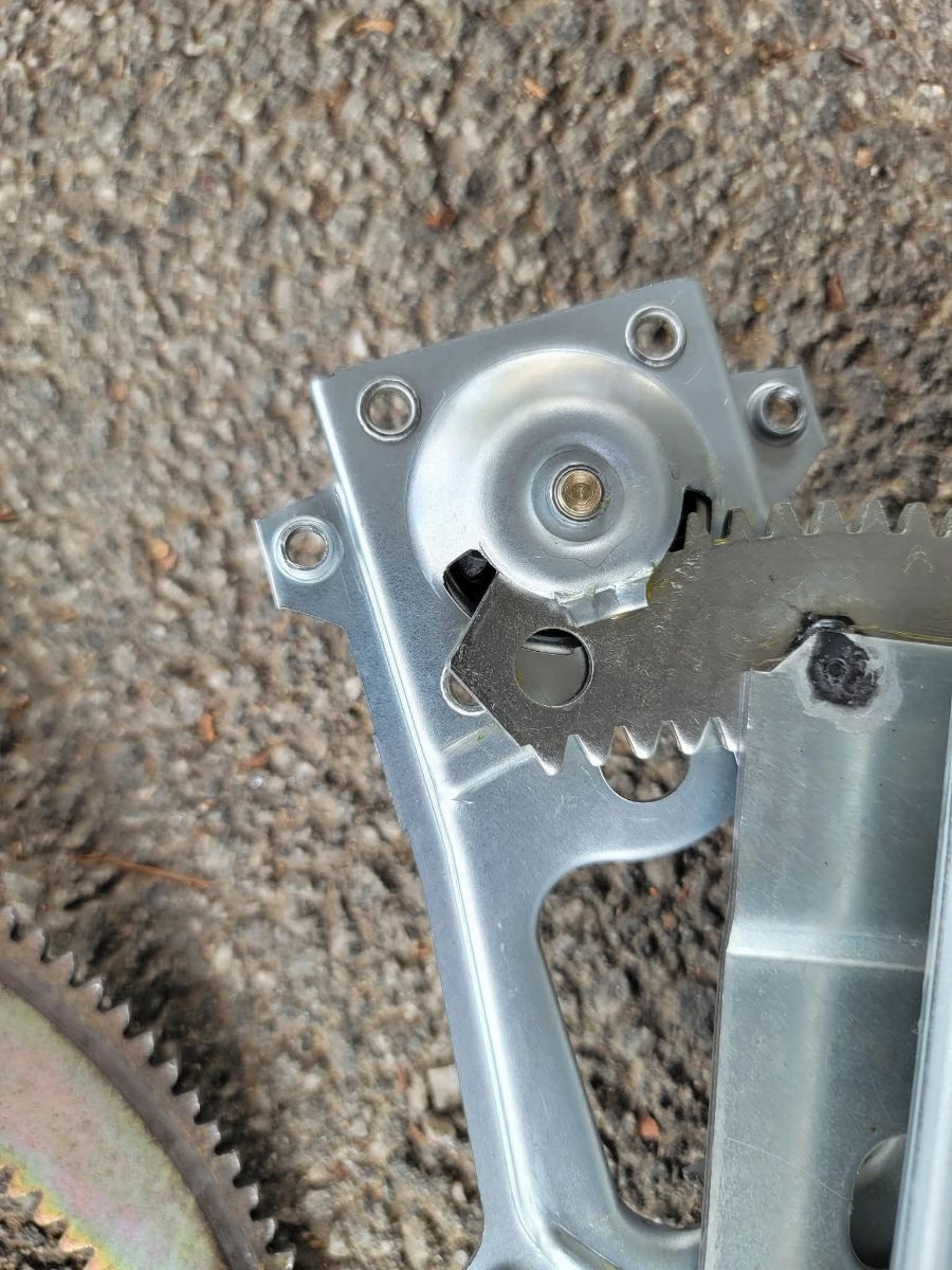

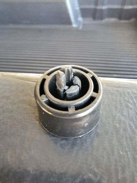

Thomas Perkins Posted December 13, 2025 Author Report Posted December 13, 2025 (edited) Happy Saturday ya'll.Nice weather here in Georgia.68 degrees.Here is my Driver side window regulator.Just as I suspected.The part that the window crank attaches to is wollered https://youtube.com/shorts/ytvA4KODpMI?si=36vS5xgybB8MwX68 Edited December 13, 2025 by Thomas Perkins Quote

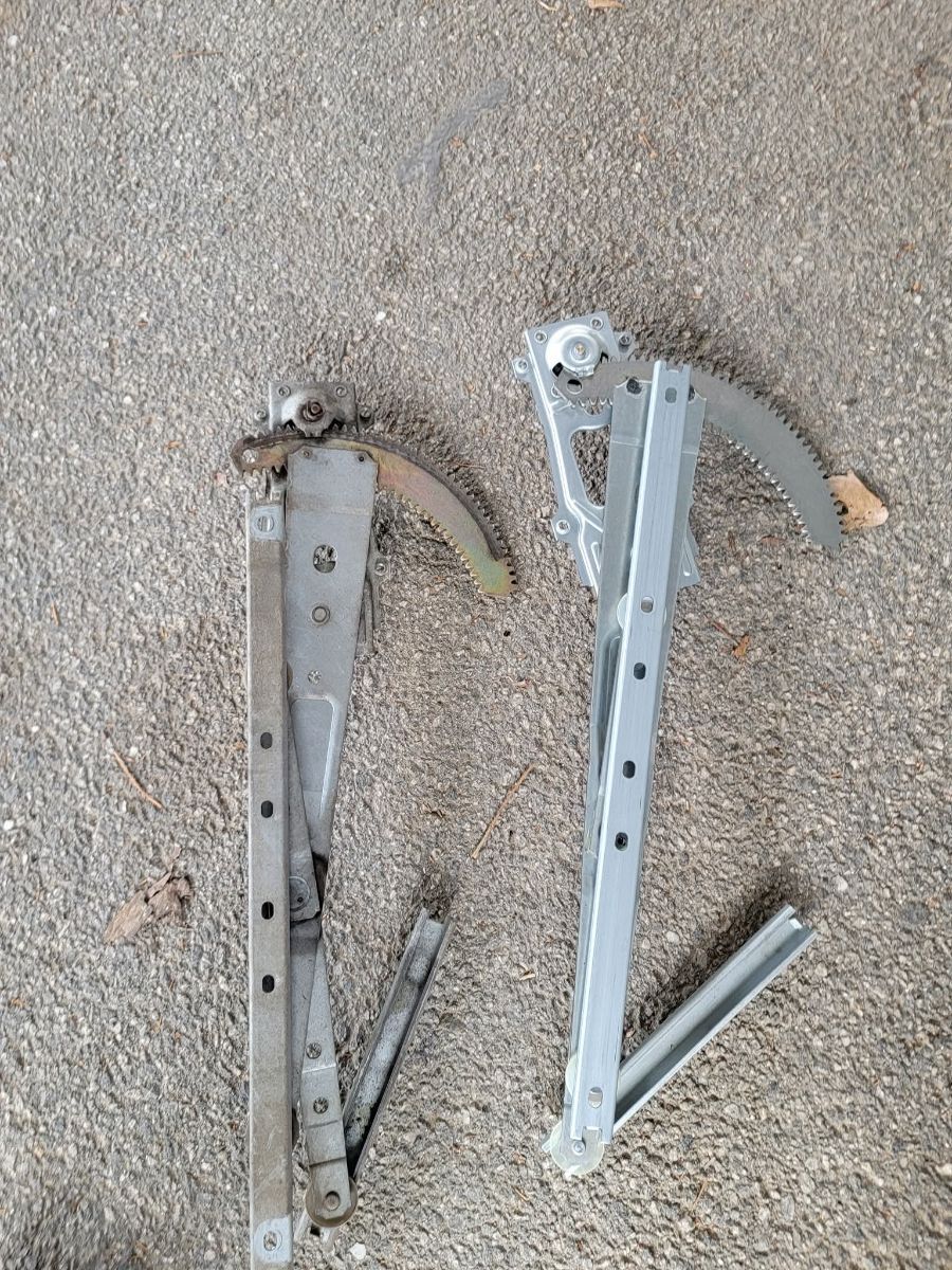

Thomas Perkins Posted December 13, 2025 Author Report Posted December 13, 2025 Here are the new and old driver side regulator.Both are Geniune Nissant parts. Quote
