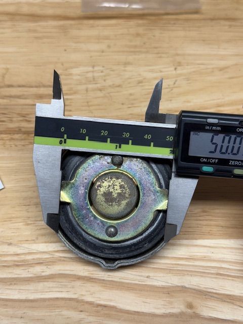

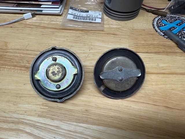

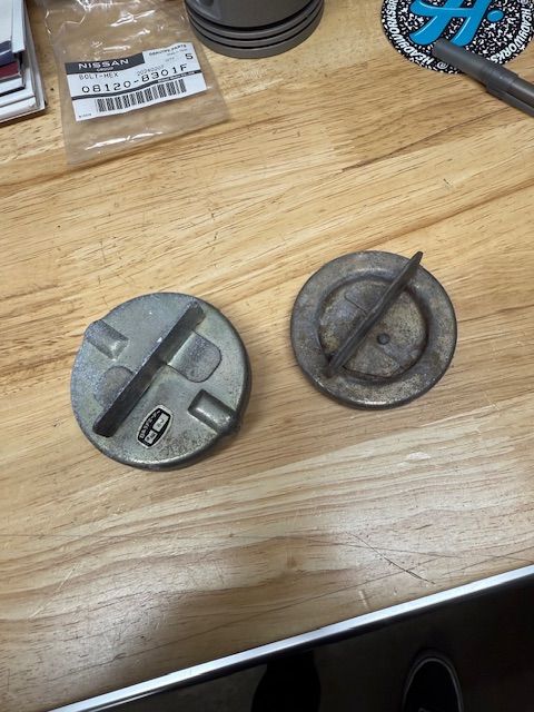

DARIN 510 Posted November 4, 2025 Report Posted November 4, 2025 Hey guys I had a question to see if anybody might know on here since online seems to only cover wagon gas caps. I have a friend with a 510 that he just restored and he has the typical gas leak issue from the cap. I know of this certain cap maybe it’s from a 610 I don’t know. But just looking for clarification and if anybody has any other fixes to this. This is the cap that I have on mine and never leaks. Quote

DARIN 510 Posted November 4, 2025 Author Report Posted November 4, 2025 Well he has a Stant cap now which fits like shit. But in the past I’ve had the same issue. You know the make a left hand turn and lose about a gallon? Loo Quote
DARIN 510 Posted November 4, 2025 Author Report Posted November 4, 2025 Mike. Do you know what this cap is from? Was I right about it being a 610 cap? I got this cap loose Quote
A-ko Posted November 4, 2025 Report Posted November 4, 2025 I had a loose fitting cap like this and i just took the gasket off another one and doubled it up. Fits tight now. Or just cut one out of an old innertube or something to stack on there. Easy fix. Quote
DARIN 510 Posted November 4, 2025 Author Report Posted November 4, 2025 I know Nissan sold the gasket, but I think it’s discontinued now. I think Z therapy sells an aftermarket version. Quote
MikeRL411 Posted November 4, 2025 Report Posted November 4, 2025 BMW 2000 caps usually work although usually available in chrome only. Quote
MikeRL411 Posted November 4, 2025 Report Posted November 4, 2025 1 hour ago, DARIN 510 said: 2002? You mean? Yes. Quote
