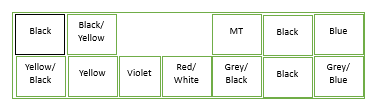

Anyone have the wiring diagram for a 2000/2001 Altima? Specifically looking for everything related to the front seats.
The seats I have are manual adjustments, but there is a large connector under the passenger side with 11 wires I want to know what was what. This is the connector and wire colors in it
I'm sure the passenger seat has an occupancy sensor + the seat belt buckle. Don't think it has airbags (no tag on the seat fabric) and aso pretty sure that heated seats were not an option in '01 so why so many wires?
  • Replies 1
Fingerd it out. Surprisingly the passenger seat was fitted with some kind of hydraulic occupancy sensor - once I cut the tube off it dribbled whatever that viscous fluid was. Non-toxic I trust... as for the # of wires, several were blanked on the other side of the connector - I suspect this was advance wiring for heated seat pads, but only on the passenger side - no such wires on drivers side so something else. The bulk of the wires were all related to the occupancy sensor with only 2 being for the seatbelt. Knowing what wasn't needed or possibly repurposed I dispensed with it all. Whew. Don't like random leftover wires hanging around.
