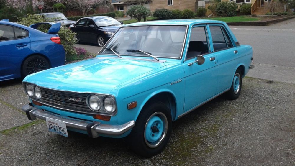

I just got a 69 datsun 510 but it was missing a trunk and fuel door lock. I ordered the below set from Ebay.
https://www.ebay.com/itm/302927400153
Unfortunately, these locks have 4 notches on the lock cylinder but my car only has cutouts for 3.
Am I missing something or is there specific lock set I should be looking for?
TIA
