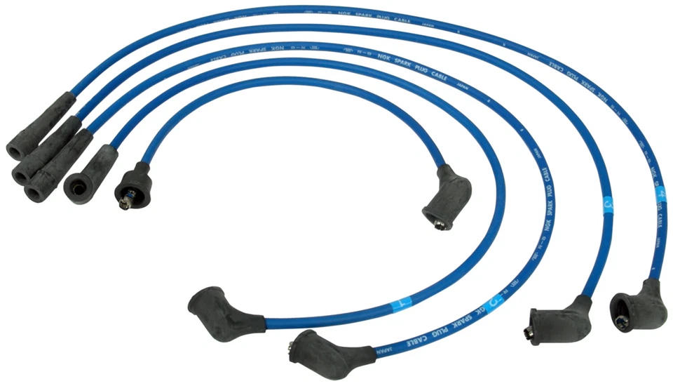

banzai510(hainz) Posted October 30, 2025 Report Share Posted October 30, 2025 (edited) After bragging I was running old plugs .My 521 acted like my 2 stroke Yamaha RD350 fouling a plug. I said shit maybe a valve getting tight. then saw a plug with lots a caked on carbon on ground strap. so a order a double set of Denso 3057s then later I found some NGK thailand in a stash(stock number 4922). Seems like the lower end plugs that arent sold much anymore are from Thailand now so Im going to stick with Denso since my Toyota has them. https://www.ebay.com/itm/297567216437 and get this for the L series is you can find cheaper NGK wire sets. they have gone up I remember but good price get 2 sets. UPDATE NOV 2 these are now made in CHINA and I only received 4 out of 8 so I delelcted the ebay link Edited November 2, 2025 by banzai510(hainz) Quote Link to comment
ggzilla Posted October 30, 2025 Author Report Share Posted October 30, 2025 Nice plug wires. What I like about them: * good 7mm silicone wires will handle high-energy electronic ignition like the matchbox distributor * (hopefully) correct lengths for L16/L18/L20B, although some complain they are too short for the factory routing clips * wires are numbered 1,2,3,4 $27 with free shipping. Beats the Autozone price of $44 for the same NGK 8106 Quote Link to comment
datzenmike Posted October 30, 2025 Report Share Posted October 30, 2025 I pulled a set off an L28 and ran the longest around the front of the valve cover, rather than over it. If you pull them once a year and wipe them down with WD-40 to clean and remove any oil and dirt they will look good, be good and last pretty much forever. Quote Link to comment
