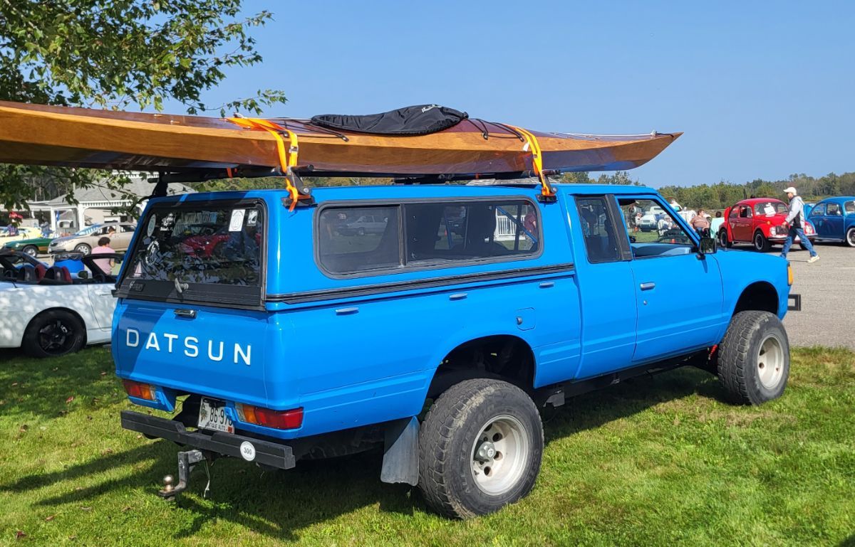

My plan is to take off the fenders and doors, spray the insides of them with canned primer, and paint the outsides of the truck with epoxy tractor paint. I was inspired by this video:
In the one-year update he shows that the car got wrecked and the paint completely held on, didn't scratch or chip. If I coat my truck evenly it should be polishable but still hold up well against chipping. My plan is Ford Blue with white lettering on all the Datsun emblems.
White on blue!20231001_125344.thumb.jpg.337df2ec6f336e7dc569d877f650f5c6.jpg
