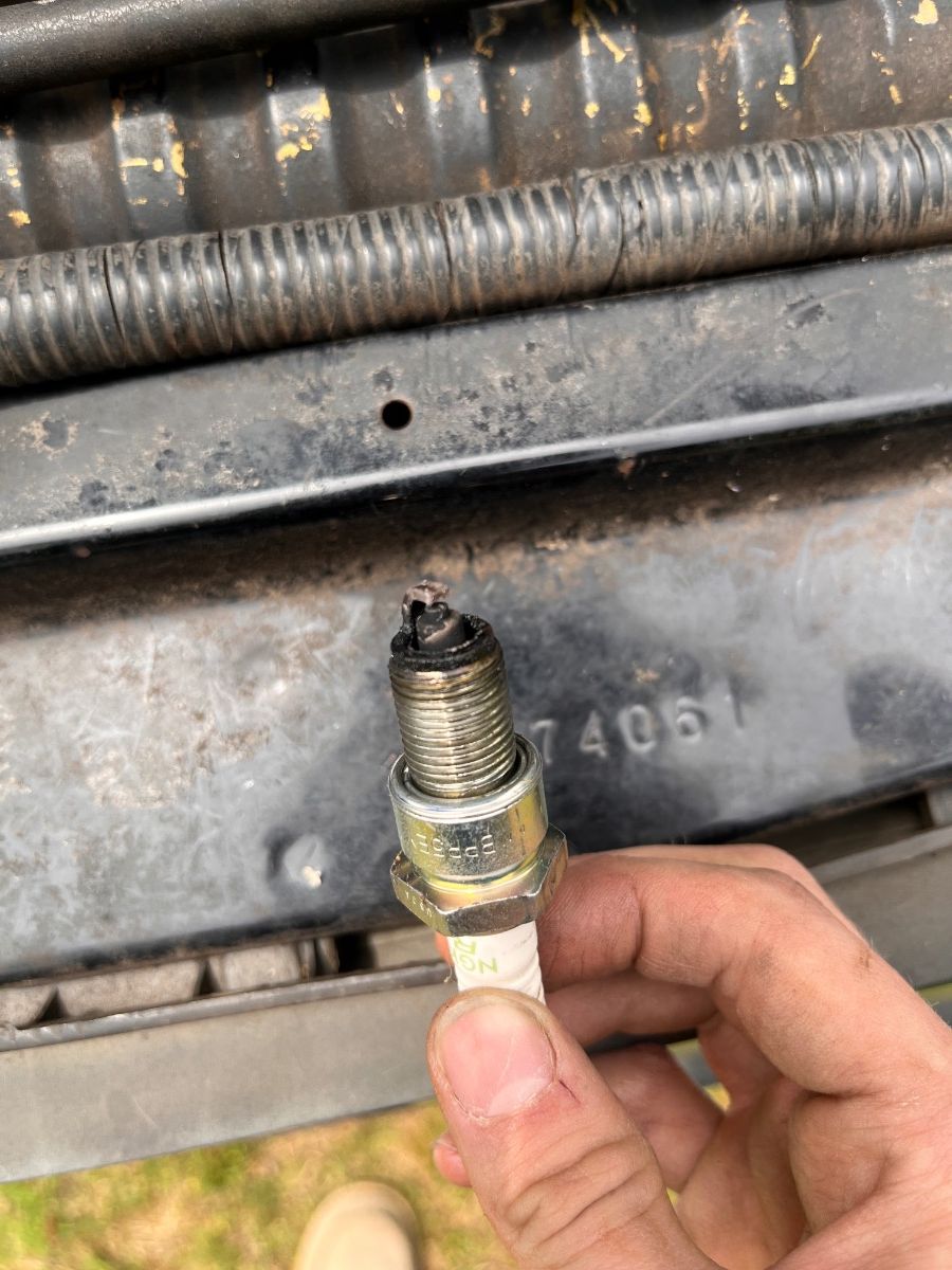

TinKanTosser Posted May 9 Author Report Share Posted May 9 Compression is still good, now consistent since I've done the head gasket: 170, 172, 170, 172. All plugs are damp with oil, some spots have a cracked hazy film: Quote Link to comment
datzenmike Posted May 10 Report Share Posted May 10 Drive it. They are self cleaning but may foul on the way home. Take for a romp and check them. If dirty at home you may be running slightly rich. 1 Quote Link to comment
