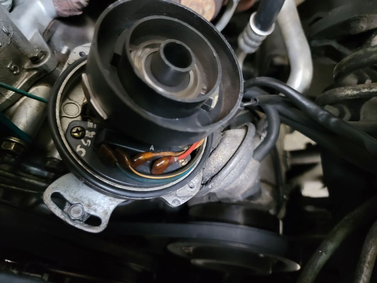

Thomas Perkins Posted October 22, 2025 Report Share Posted October 22, 2025 (edited) You need to remove that broken bolt and put a new one in it.You see where the worn part is.After getting a new bolt in, turn distributor and align it up to the worn mark.Might get lucky and hit the timing mark on the head.My bolt is pretty much centered.Never in 31 years of owning my truck has my timing jumped.Get a set of easy out and new NGK spark plugs and wires.Wires have cylinder numbers on them and get a new distributor cap and rotor from Auto Zone ,comes with a lifetime warranty.What I use.They are good.Harbor Freight has good timing lights for 35 bucks.Easy way to align up time marks is,put in 2nd gear and pull truck and marks will align up.Works for me, even can push back wards.Never had to time it, my vacuum line came off,I thought timing was off.I never ever lossened the 2 screws.Here is my distributor with cap off.Set bolt is in middle. Edited October 22, 2025 by Thomas Perkins 1 Quote Link to comment
datzenmike Posted October 22, 2025 Report Share Posted October 22, 2025 If the 'button' is falling out it's done. Get a new distributor cap. There is no time for replacing the wires, it's done by looks. If they look bad they most certainly are. Good insulation in the wires and cap/rotor ensure that the spark has only one possible path to ground and that's the spark plug. There is no vacuum on the vacuum advance to the distributor at idle so putting finger over hose end will do nothing. Quote Link to comment
TinKanTosser Posted October 23, 2025 Author Report Share Posted October 23, 2025 I'm a consistent screw-up with drilling and easy-outs. Drilled the hole slightly off center and then broke off the extractor in it, now I can't drill through the extractor and it's too dark out. Surprised the Nissan bolt was soft to drill through while the extractor is as tough as a Toyota bolt. If I hadn't tried to use the extractor I could have just drilled the hole until empty and gotten a bolt with a nut tonight, now it's too late. I didn't think anything of the button falling out because it was only held in by the spring being wrapped around it. The cap seems like new but I can go ahead and get another one and new plugs. Can anyone answer why they have separate NGK parts numbers for intake and exhaust spark plugs? Some other makers listed on RockAuto do but a lot don't, and I suspect it doesn't matter very much. Ordered new plug wires already with my parts order arriving tomorrow, the ones coming from the coils don't look great so maybe that's a clue. Tomorrow I'll work on drilling out the bolt + extractor and replacing it. 59 minutes ago, datzenmike said: There is no vacuum on the vacuum advance to the distributor at idle so putting finger over hose end will do nothing. I meant the open port on the manifold on the VSV or whatever it's called here. In the last few frames you can see me cover it but what happened afterward is the idle stayed the same and kept going up and down at the same rate. I have a cap set to cap it off (until I follow a diagram and get the vacuum routed) but didn't notice the open port until yesterday. Quote Link to comment
Rustbin Posted October 23, 2025 Report Share Posted October 23, 2025 The intake and exhaust have different heat range ratings. Lots of penetrating oil helps loosen busted bolts, I try to drill them out till I'm near the threads then use a punch or something similar to knock the remaining bits towards the center of the hole to bust them out, then finish up by chasing the threads with the correct size tap. 1 Quote Link to comment
NC85ST Posted October 23, 2025 Report Share Posted October 23, 2025 To drill out that bolt, remove the distributor and then remove the distributor mount. It only has 2 bolts, then put it in vise to drill out the bolt. Also, without that bolt, your distributor won’t stay in time and the engine will die or run very, very badly. P.S. Don’t snap the distributor mount bolts. If they don’t want to come out easily, leave them alone. 1 Quote Link to comment
