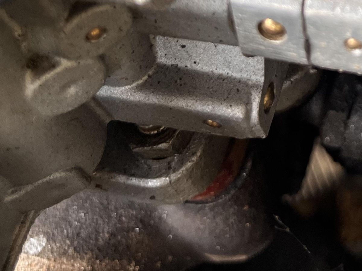

ggzilla Posted October 19, 2025 Report Share Posted October 19, 2025 48 minutes ago, TinKanTosser said: No extra torque, just fuel efficiency from the Weber? Also, the crack-looking thing is just a casting mark and there's one just like it on the other side, checked today. no extra fuel efficiency, it will be a bit worse The Weber is jetted richer than the Hitachi, so it will run good, a bit smoother at times. Or, you could jet the Hitachi richer. If your Hitachi is worn out then the Weber will be big improvement, but so will a rebuilt Hitachi 2 Quote Link to comment

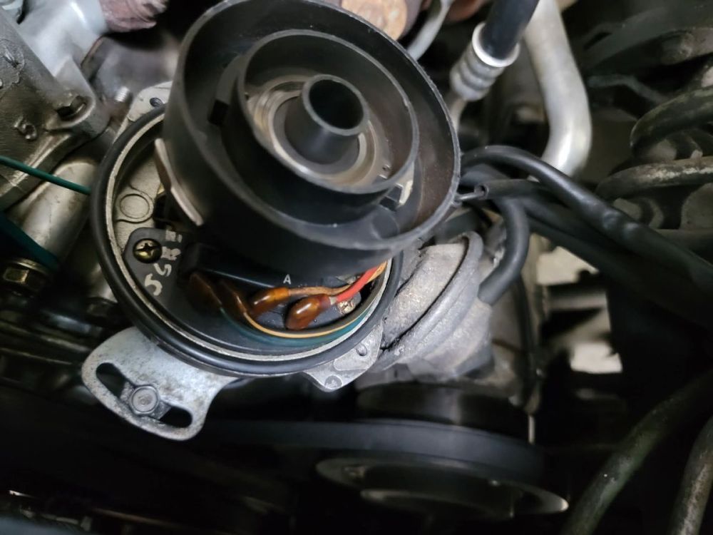

TinKanTosser Posted October 22, 2025 Author Report Share Posted October 22, 2025 I'm an ADHD idiot, the cap is original and numbered but I didn't see because of low light and initially trying to leave the plug wires in place. It was wired right in the first place, I didn't realise I needed to look at the thing cockeyed to follow the diagram. I was wracking my brain trying to figure out where each wire goes last night before I decided to try rewiring it wrong 🫠 So this morning I wired it right again and tried rotating the distributor to about the midpoint, that should usually be a good base to start from, and it fired more eagerly but still sounded out of time and I didn't want to keep pushing it for fear of messing it up. Won't let me embed an mp4 as an image so here's a link: https://i.imgur.com/bUnMTzL.mp4 1 hour ago, NC85ST said: One great thing about these Nissans, the distributor only fits one way. You can pull the distributor out and you don’t have to worry about it being a tooth off when you put it back. You only worry about being a tooth off when you pull the oil pump. Which bolt is broken? I didn't expect that. I spent a lot of time messing with a 22RE worrying about the distributor gear before I got a timing light. Broken bolt is here: Should be fine, seems like Quote Link to comment
TinKanTosser Posted October 22, 2025 Author Report Share Posted October 22, 2025 I was in a rush to check my wires and post the above this morning before going on a trip, but just now I got back and the truck actually ran on its own for the first time -- I let off the pedal expecting it to go dead but it actually kept going, with the idle drifting up and down. Imgur cut the video off at a minute but when I covered the open vac port with my finger it made no difference to the idle, and then a short bit later it went dead on its own. I know I need my carb wires hooked up but right now I'm concerned about how it's not firing right. The way it shakes makes it seem like one or two cylinders are entirely not firing -- spark test comes next I guess https://i.imgur.com/G45l1XV.mp4 Quote Link to comment

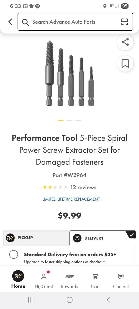

Thomas Perkins Posted October 22, 2025 Report Share Posted October 22, 2025 You need to remove that broken bolt and put a new one in it.You see where the worn part is.After getting a new bolt in, turn distributor and align it up to the worn mark.Might get lucky and hit the timing mark on the head.My bolt is pretty much centered.Never in 31 years of owning my truck has my timing jumped.Advance has these cheap. Quote Link to comment
TinKanTosser Posted October 22, 2025 Author Report Share Posted October 22, 2025 8 minutes ago, Thomas Perkins said: You need to remove that broken bolt and put a new one in it.You see where the worn part is.After getting a new bolt in, turn distributor and align it up to the worn mark.Might get lucky and hit the timing mark on the head.My bolt is pretty much centered.Never in 31 years of owning my truck has my timing jumped.Advance has these cheap. So you think one bolt holding it on could be causing it not to spark on one side of the rotation? Also forgot to mention it only ran on its own this time after I sprayed everything down with contact cleaner. The burnt contacts I mentioned are the four on the ring on the rotor around the rotor button. Also my rotor button fell out when I took the cap off last night, I tried to jam it back into the spring but it's crooked. Don't know what to do about that or if it affects anything. Quote Link to comment
banzai510(hainz) Posted October 22, 2025 Report Share Posted October 22, 2025 (edited) 8 minutes ago, TinKanTosser said: my rotor button fell out thats something meaningful. called get another cap thats junk 8 minutes ago, TinKanTosser said: one bolt holding it on the timing slots its only one bolt.but if has 2 get 2 bout highly dought thats your proplem to hold the mount it 2 bolts . ez to get another metric bolt. make sure the wires are correct fire order if this a 2wire per cylinder head. Edited October 22, 2025 by banzai510(hainz) Quote Link to comment
