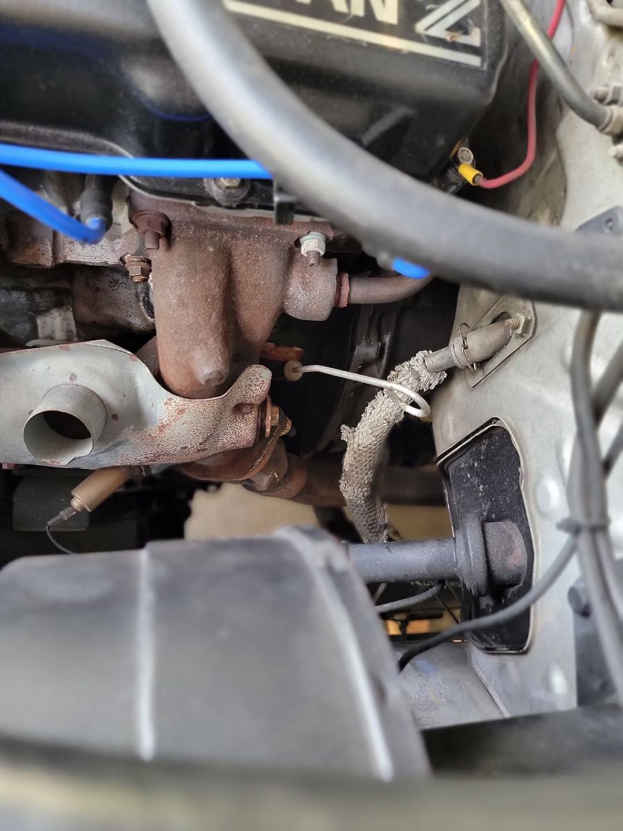

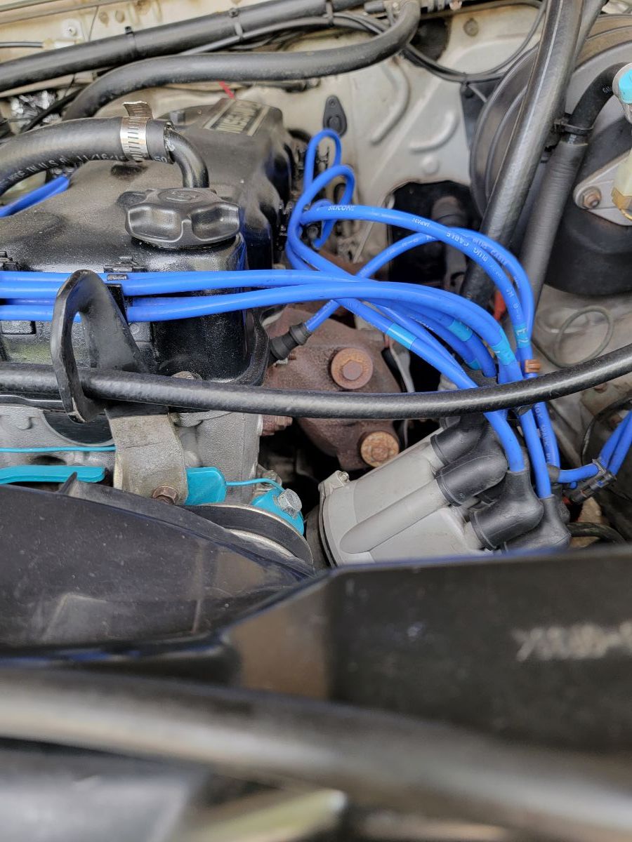

85 720 king cab 4x2 Posted October 2 Report Share Posted October 2 What can I do with the AIS system on my 84 Nissan 4 x 4 trying to put a Weber carb on here do I have to get another manifold that has no ports in it or what can I do with these two tubes and imports that go into the air filter, and Help would be greatly appreciated Quote Link to comment

85 720 king cab 4x2 Posted October 4 Author Report Share Posted October 4 So I picked up an 84 Nissan 720 4 x 4 and from the carburetor air filter it’s got in the ASI system on it and I’m trying to put a Weber on it. How hard would it be? How much difference would it make if I just got a new exhaust side manifold without it?? and then put the Weber carb on to a regular manifold without the ASI the tubes coming out? Would this be a dumb idea? Should I just keep the stock carburetor that’s on there and go with that I’ve never seen anything like this some kind of clueless when it comes to the system any help would be greatly appreciated. Quote Link to comment
datzenmike Posted October 4 Report Share Posted October 4 These two post are similar so I merged them rather than repeating my answer. Yes you can run without the AIS. This system is absolutely benign in operation and is down stream of the engine so working or not has no effect on the engine, well other than not providing added air so the catalytic converter can operate properly. Quote Link to comment

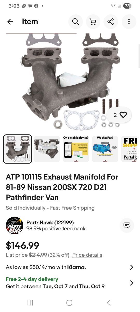

Thomas Perkins Posted October 4 Report Share Posted October 4 (edited) Yeah.Also too much stuff connected to it that can go bad and nowhere to find replacement parts.Plus not any good.Plus so easy to replace spark plugs with a Weber.But,they are for die hard old school Nissan people.Here is a exhaust manifold.Like mine. Edited October 4 by Thomas Perkins Quote Link to comment
