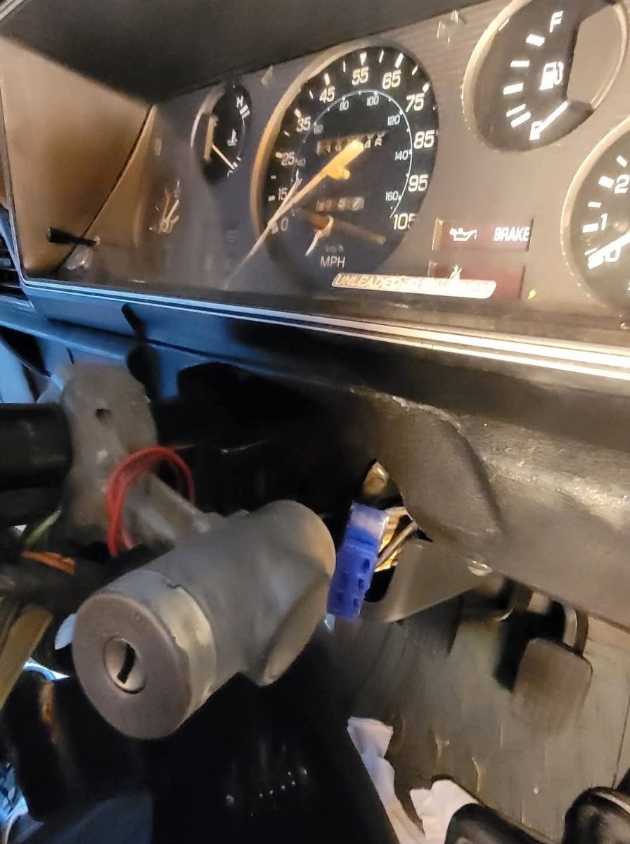

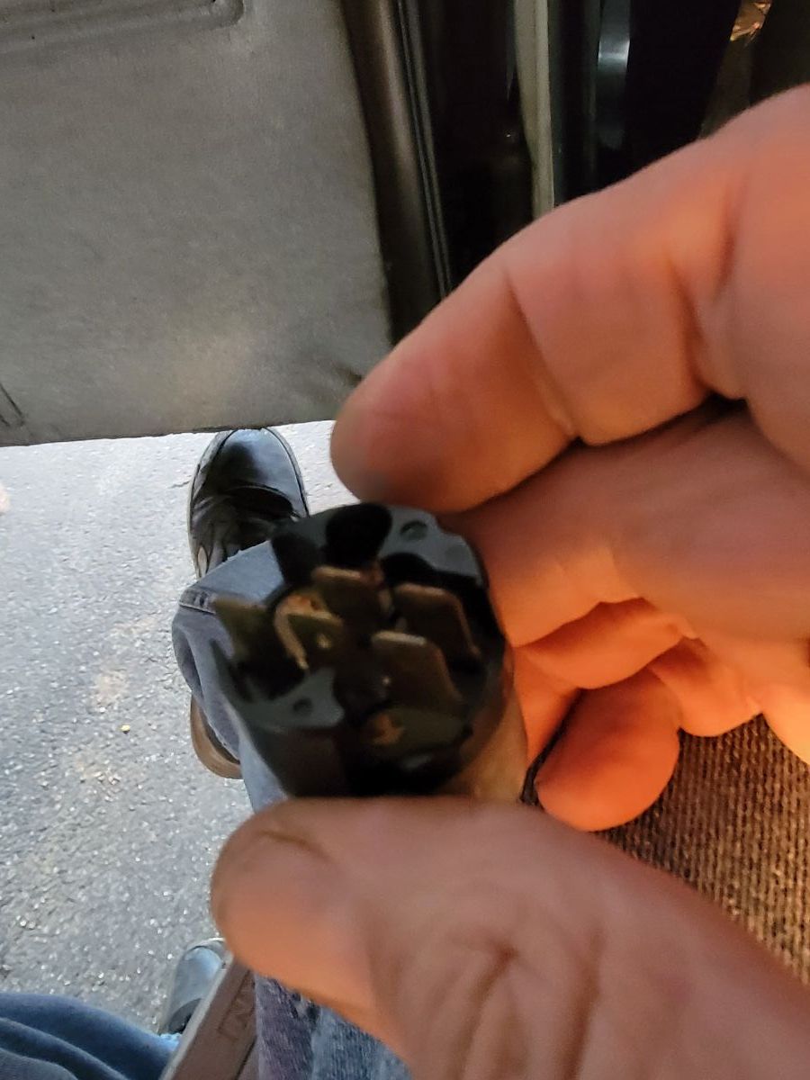

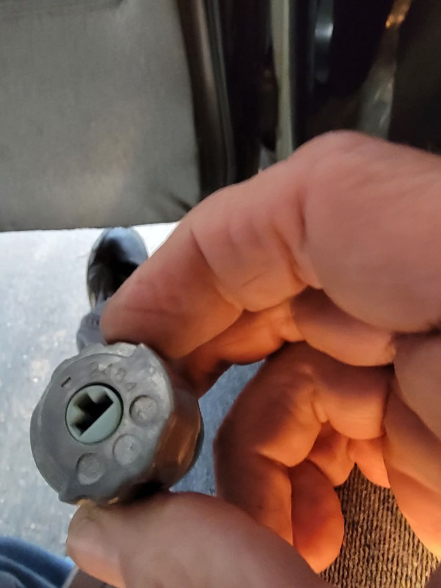

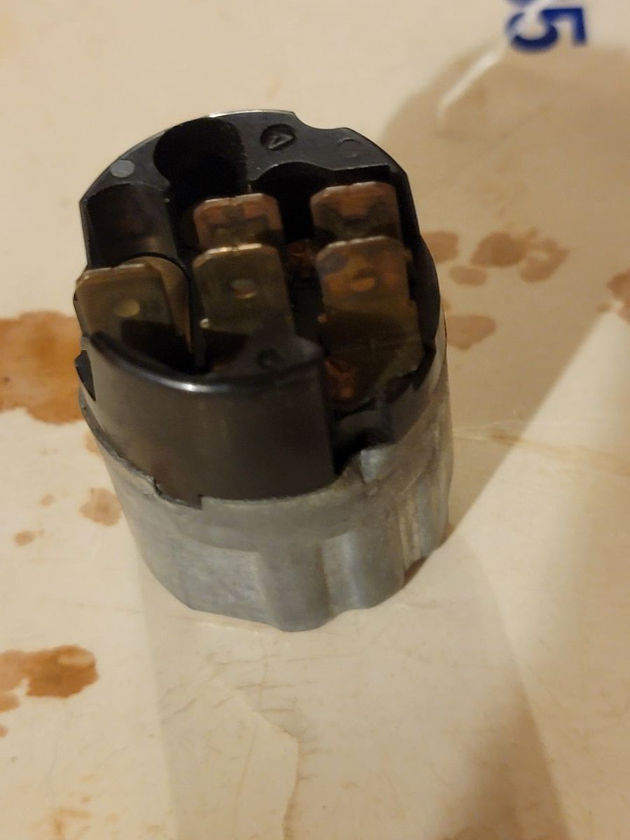

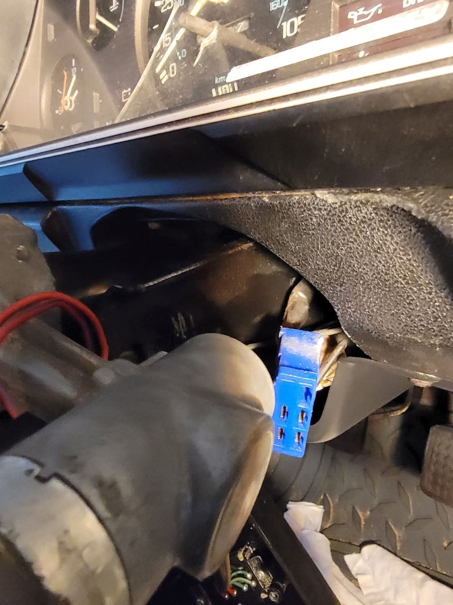

Thomas Perkins Posted October 3, 2025 Report Share Posted October 3, 2025 (edited) Something else made my Nissan not start not too long ago.It would start,then it would not.I would take the second fuse out and put it back in and it would start.Then it would not start.So that fuse thing was not the problem.Everything was new battery,starter,alternator,fusible link.clean ground wires.So only thing left was the igntion switch.I removed it and the 5 connectors were real dirty.I took a piece of sand paper and cleaned them.Then,I got a little bitty screw driver and scrapped the inside of the blue female connector.Then it started up and problem solved.AutoZone had one in stock,almost bought it.May not be your problem but,it maybe.See how dirty it was,not getting a good connection.It came real clean.It is a bitch to get that little phillips head screw off.My speedometer cable was leaking oil at one time,could of gotten on the igntion switch and caused this.Oil also got on my emergency brake wire and caused the brake light on the dash not come on.Close to where oil leaks,it was leaking real bad at one time,all behind my cluster and floor board.What else could of caused this? Edited October 3, 2025 by Thomas Perkins Quote Link to comment
