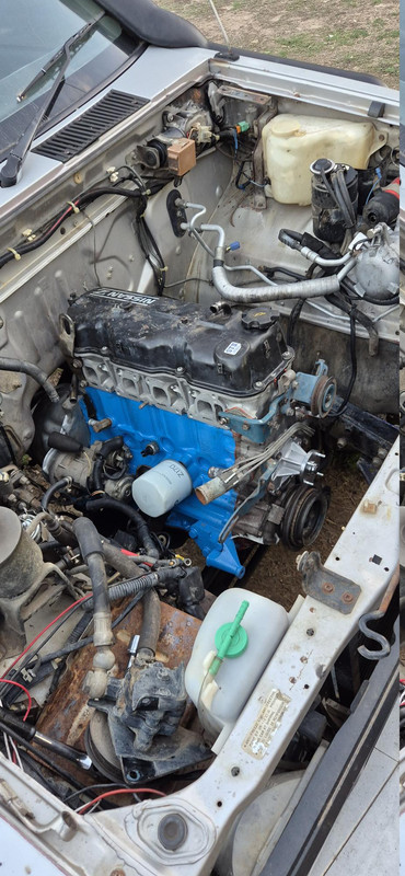

So, I pulled the original engine out from under my workbench
It had bad rings/ring lands on #3 but the bores all cleaned up nicely with a hone.
Just waiting for bits now.

Finally freed up some cash and ordered the rest of the engine parts for this this morning.
Pistons
Rings
Bearings
KA Oil Pump
New Clutch for good measure
Gaskets
Timing set, dual row with tensioners/guides
Assy Lube
Plastigage
Plus I have a reco head here on the shelf.
Itching to get onto it.
Been waaaaaaaaaaay too long and I miss driving this thing.
