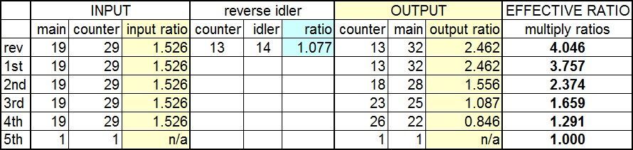

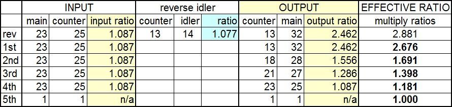

ggzilla Posted September 17, 2025 Report Share Posted September 17, 2025 (edited) Excellent info, @datzenmike I never understood wide vs close ratio until i did the math on the gears. Wide-ratio and close ratio have the same gears 1-4, but the input gears differ The math I did was for the Datsun 1200. 3rd gear does differ, but 1st, 2nd and 4th gears (the actual physical gears) are the same in a close-ratio box as you can see for the close-ratio box, the overall ratios are closer together, and much higher gearing. First gear in a close ratio box is almost like taking off in 2nd gear This higher gearing makes a close-ratio box not very good for a street car or a truck, but when paired with steep differential gears, it makes for quickest acceleration as the engine RPMs don't drop as much when you shift up to the next gear Edited September 17, 2025 by ggzilla Quote Link to comment

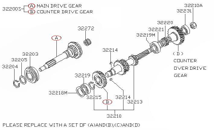

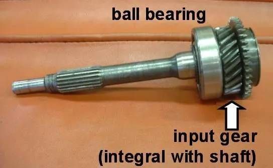

ggzilla Posted September 18, 2025 Report Share Posted September 18, 2025 The gear on the input shaft meshes with the gear on the cluster shaft, neither are replaceable gears. It's good to know the 1991 300ZX trans has the same input gears as the 1983 Z24 transmission Quote Link to comment
datzenmike Posted September 19, 2025 Report Share Posted September 19, 2025 The counter shaft driven gear is removable. You could replace it but I think sold as a set. Quote Link to comment
ggzilla Posted September 19, 2025 Report Share Posted September 19, 2025 thanks for pointing that out. This makes it different than the smaller Nissan 5-speeds, and much more swappable 6 hours ago, Mr.Disprosium said: you could theoretically change the ratio if you replaced both gears, which I did 58 minutes ago, datzenmike said: The counter shaft driven gear is removable. You could replace it but I think sold as a set. I too see in the Nissan parts catalog it indicates the input counter gear is included when you buy a counter shaft ... but also is sold as "Set Gear Drive" For the 1983 720 there were two different sets: * 32200-E9055 Set Gear Drive * 32200-E9551 Set Gear Drive Exactly what ratios these are, is not stated But for counter gear assembly, there is only "14T" * 32210-E9810 Counter Gear Assy The 71C out of a D21 also has two sets Quote Link to comment
Mr.Disprosium Posted September 19, 2025 Author Report Share Posted September 19, 2025 7 hours ago, ggzilla said: The gear on the input shaft meshes with the gear on the cluster shaft, neither are replaceable gears. It's good to know the 1991 300ZX trans has the same input gears as the 1983 Z24 transmission It is not the 300zx trans(rs5r30a) that has the same gears, it is the fs5w71c that has slightly wider input gears that will in the fs5w71b. The 91 300zx transmission is almost entirely different, much bigger gears and parts that definitely won't fit in the fs5w71b/c trannys, different case, different design. Bigger output shaft. I used an adapter plate and custom driveshaft to swap it onto my ka, also it has much longer gear ratios, 80mph at 3100 rpms vs 3800 rpms, but that trans ended up being bad, and I broke it further trying to fix it so I fixed my original transmission until I can afford another 300zx trans. 1 Quote Link to comment
