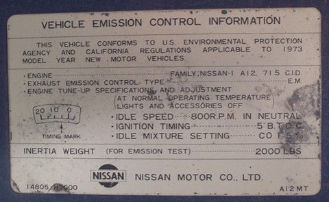

* Tune-up sticker

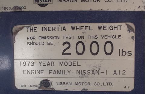

* Dyno sticker

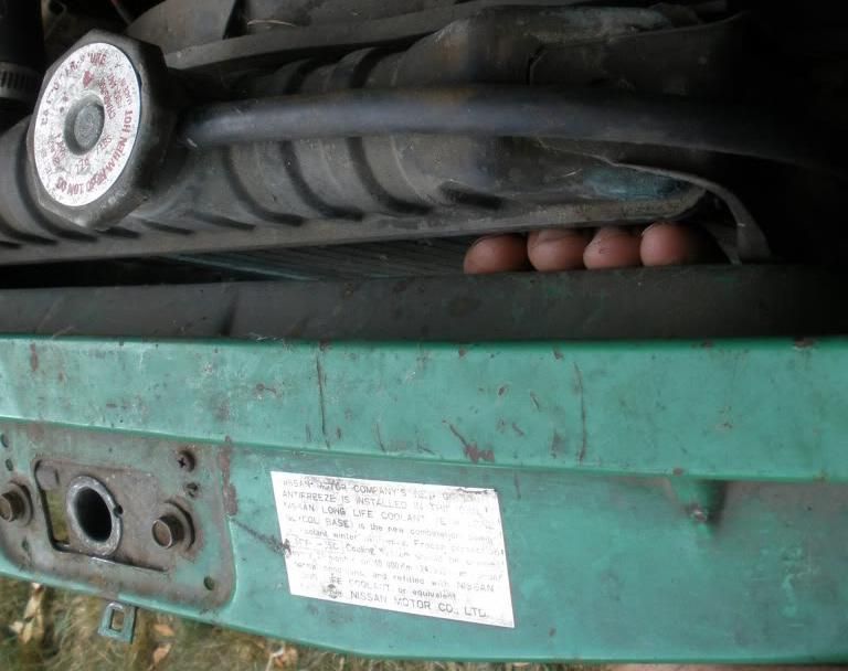

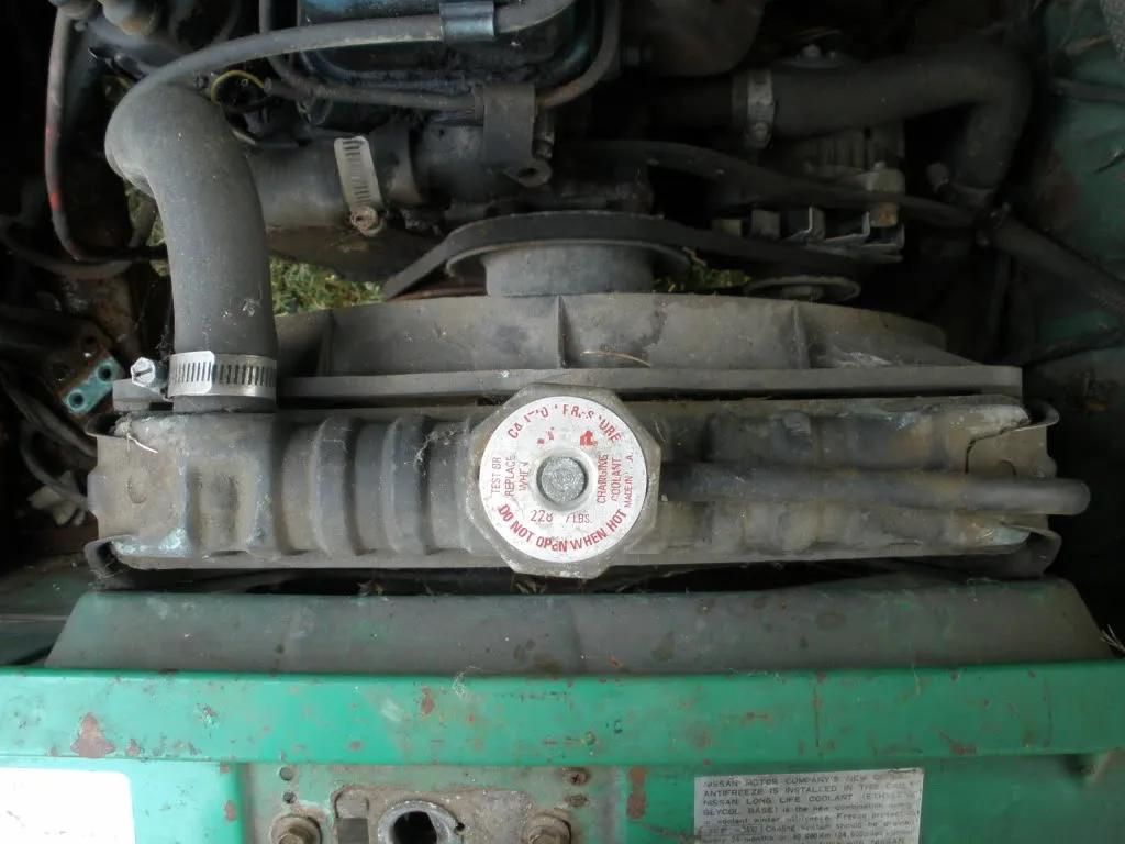

Coolant information sticker
Tune-up specifications to ensure low emissions varies by year
Dyno sticker has the loading information for the wheel dyno. Varies by year

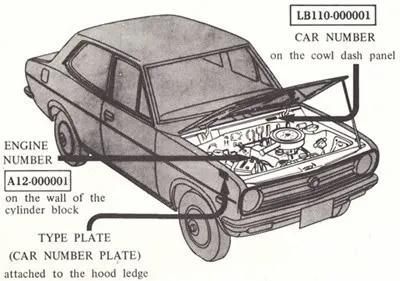

Not like the riveted metal Car Number Plate, like this 1971 plate

Datsun 1200 USA ( I think it says DATSUN, but it's partially worn off). Yes, that is my hand
NISSAN MOTOR COMPANY'S NEW COOLANT
ANTIFREEZE IS INSTALLED IN THIS CAR.
NISSAN LONG LIFE COOLANT (ETHYLENE
GLYCOL BASE) is the new combination summ-
er coolant winter antifreeze. Freeze protection
_______________
[ 31 F - 35 C ] Cooling system should be drained
every 24 months or 40,000Km (24,000 miles) under
normal conditions, and refilled with NISSAN
LONG LIFE COOLANT or equivalent.
DATSUN NISSAN MOTOR CO., LTD.
