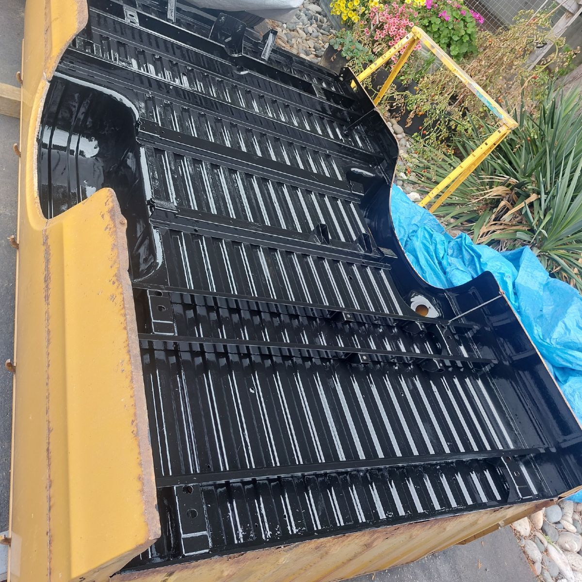

GRJones Posted September 11, 2025 Author Report Share Posted September 11, 2025 Really didn't want to strip off all the rubberized coating on my back. 1 Quote Link to comment
ggzilla Posted September 11, 2025 Report Share Posted September 11, 2025 yea the rubberized coating protects the bed, so best to leave it be 1 Quote Link to comment
GRJones Posted September 11, 2025 Author Report Share Posted September 11, 2025 I'm planning on recoating it. Just worried about hidden rust. 😬 Quote Link to comment

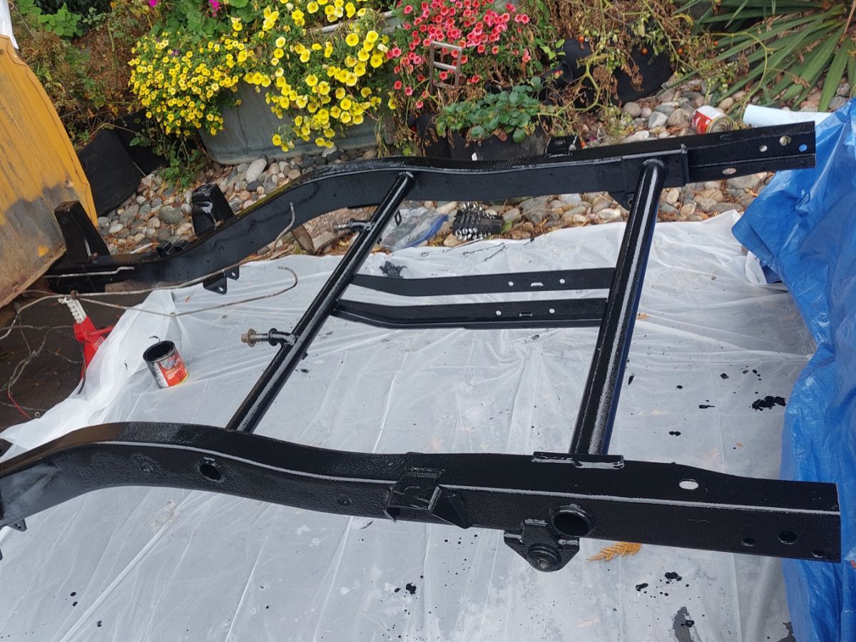

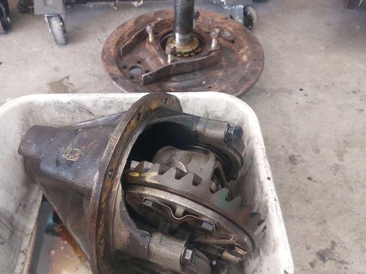

GRJones Posted October 6, 2025 Author Report Share Posted October 6, 2025 Rear frame stripped and painted. Getting a friend to press out the axle bearings. There was a small amount of water in the diff but is in great shape. 4 Quote Link to comment
ggzilla Posted November 1, 2025 Report Share Posted November 1, 2025 that 3rd member looks brand new and the frame restoration looks better than new. Good on ya 1 Quote Link to comment
