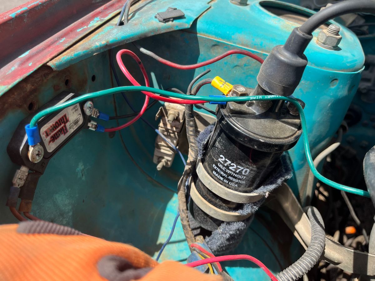

ggzilla Posted August 18, 2025 Report Posted August 18, 2025 1 hour ago, Dirtyowlnumber4 said: the engine is cutting out under load. It is preventing the car from racing. ... magnetic pickup conversion Is it a Pertronix Ignitor conversion? That unit is not rated for a high energy spark, so if you removed the resistor, try it with the resistor back in place. Often works OK without a resistor but Pertronix won't guarantee it. The Pertronix II is high energy Quote
banzai510(hainz) Posted August 18, 2025 Report Posted August 18, 2025 (edited) looking at the tach it seems your loosing electrical power. a pertronix needs a ballast resistor as a stock point coil needs a ballast and gets HOT. can you feel the coil if HOT to the touch thats a issue unless you .film / photos of what you have. I have Pertronix over 20yrs never had a issue and I run the ballast resisitor. You you running a Nissan EI dist make sure to use the EI coil. but you can still use the stock point coil but needs a ballast. to me something is breaking down electrically goin by the tach cause if a fuel issue the rpms would still read. If this is a in series POWER tach try with out . But most I think a parrellel power. Edited August 18, 2025 by banzai510(hainz) Quote
ggzilla Posted August 18, 2025 Report Posted August 18, 2025 Yes, that is an aftermarket tachometer, so it will undoubtedly be hooked to the coil negative. For stock Datsun tach, USA B210 used the same wiring. RHD B210 as similar to the B110 wiring which connected to IGN + wire in dash Easy enough to test if the tach is causing the issue, just temporarily disconnect tach wire from coil and then see if the cutting out goes away Quote

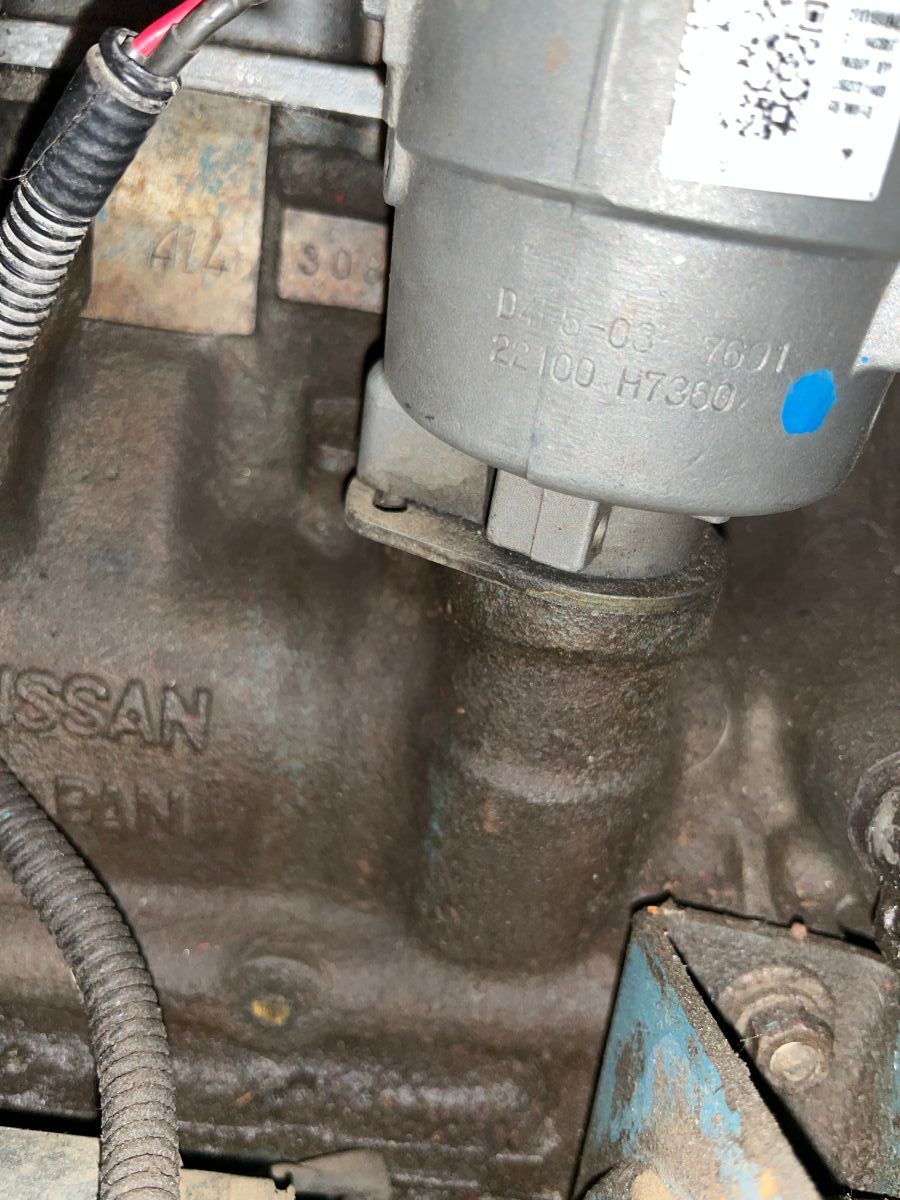

ggzilla Posted September 27, 2025 Report Posted September 27, 2025 Your coil needs no resistor. And neither does the GM EI module. If you have the high-energy spark plugs, they won't correctly work at high speed with the resistor in place I think it's very unlikely the distributor is bad. But you can look at it carefully. What is the number stamped on the side of the distributor, D4K or D4F? Quote
Dirtyowlnumber4 Posted September 27, 2025 Author Report Posted September 27, 2025 I've got crappy copper plugs in there I think. Don't think it's the distributor either but I figured I'll just keep throwing things at it. Not sure if I've mentioned it but I've thrown a couple other coils on it to try out, and I've revved it as hard as it'll go for a while and felt the coil and module afterward - they are not getting hot. The number very faint but it appears to read D4F Quote
datzenmike Posted September 27, 2025 Report Posted September 27, 2025 You video is definitely the ignition cutting out as indicated by the tach also cutting out. Get another HEI module, Chinese after market ones are crap. Get rid of the ballast resistor it reduces coil output. Ignore the coil resistance below. The B terminal MUST be 12v so if the power goes through the ballast first this is the problem. The ballast drops the power to the coil by half and that reduces coil output. 22100-H7360 is a '78 210 and on A14 matchbox distributor for manual federal/California emissions. Quote

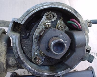

ggzilla Posted September 27, 2025 Report Posted September 27, 2025 D4F is the "remote ignitor" electronic ignition distributor used on 1978 B210 and earlier california B210 D4F Testing: * If you can wiggle the shaft side-to-side, and the gap between a tooth and the pickup visibly gets wider and narrower, than yes, replace the distributor * turn the rotor (or shaft) back and forth. There should be a little tension. If there is none, the mechanical advance spring is broken and timing will be erratic and pinging at random. Just swap in another spring from any B210 distributor, points or electronic Other than that, these are very reliable distributors Quote

datzenmike Posted September 28, 2025 Report Posted September 28, 2025 What did I say? matchbox.... it was the remote ignitor. D4F5-03 was only '78 on manual federal emissions and after '74 on manual California emissions. Quote
Dirtyowlnumber4 Posted October 1, 2025 Author Report Posted October 1, 2025 Ignition module was replaced when I replaced all the ignition stuff awhile back, its a pertronix one now. Have tried it with the ballast on the positive, its off now. Also measured the voltae going to the coil to make sure it wasn't dropping and it seems fine. Did try it with the tach disconnected also tried bypassing the ignition switch and wiring and hooked the coil straight up to the battery did the checks on the distributor, it seems fine. heres better video of it trying to hold around 3500 rpms Quote
datzenmike Posted October 1, 2025 Report Posted October 1, 2025 Not sure if the Pertronix can handle a points coil without the ballast. Actually the points coil will overheat without the ballast connected to drop the voltage. It will work but will over heat. If you have the Matchbox coil it won't over heat but the Pertronix may not last passing that heavy current load. Hainz will know. Quote
ggzilla Posted October 1, 2025 Report Posted October 1, 2025 Pertronix Ignitor II is designed to handle high-energy coil But the much more common Pertronix Ignitor I is not. A lot of guys run hot coils with it and it works for them, but Pertronix won't guarantee it Have you tried disconnecting the tachometer from the coil? Quote
datzenmike Posted October 2, 2025 Report Posted October 2, 2025 The ignition is definitely cutting out in the video. Try making a jumper and run 12v directly from the battery to the coil + side. This will eliminate anything to do with the ignition switch and wiring. Make sure the distributor is well grounded. Everything goes through the distributor to ground. Quote
banzai510(hainz) Posted October 2, 2025 Report Posted October 2, 2025 On 10/1/2025 at 8:39 AM, Dirtyowlnumber4 said: Have tried it with the ballast on the positive, its off now. Also measured the voltae going to the coil to make sure it wasn't dropping and it seems fine. Did try it with the tach disconnected also tried bypassing the ignition switch and wiring and hooked the coil straight up to the battery did the checks on the distributor, it seems fine. sounds like he tried it all. shit I would put a point distributor in there and try that for trouble shooting. Quote

ggzilla Posted October 7, 2025 Report Posted October 7, 2025 On 10/2/2025 at 7:04 PM, Dirtyowlnumber4 said: does anyone know how to adjust the internals on these EI distributors? there is an adjustment between the ignitor and the pickup, and there is a brush underneath that hits the distributor shaft. That brush wasn't hitting the shaft when this dizzy came in the mail so I kinda just moved it inboard but I really don't know what I'm doing. I can't think of a brush. Do you have a picture? The D4F remote ignitor distributor has one adjustment, the air-gap, between the "teeth" of the rotor and the electronic pickup. The ignitor is under the dash inside the car, or you can use a GM ignitor Before or after installation, set the Air Gap to .2 to .4 mm/8-16 thousands inch (smaller than a points gap). At tune-up intervals, check the condition: * Air Gap * Vacuum Advance module (does it leak air)? Push the rod with a screw driver, put your finger on the port and see if it holds a vacuum * Bearing plate? Move smoothly? These usually have the good all-metal ball bearing plate, unlike the matchbox with its plastic plate * Inspect Cap & Rotor, wash if dirty. Replace if burn marks found in cap. Quote
