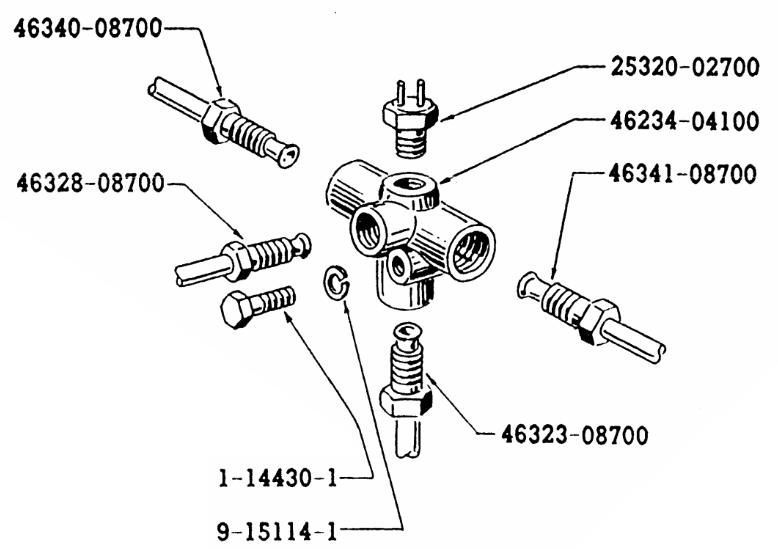

ggzilla Posted August 20, 2025 Report Share Posted August 20, 2025 The 320 splitter is 5-way, the fifth connection is pipe threads for the brake light switch (switch 25320-02700) I would try to tap the brake line port, but I don't think there is enough meat to go up a size bigger. Nissan 46234-04100 CONNECTOR-5 WAY 1 Quote Link to comment

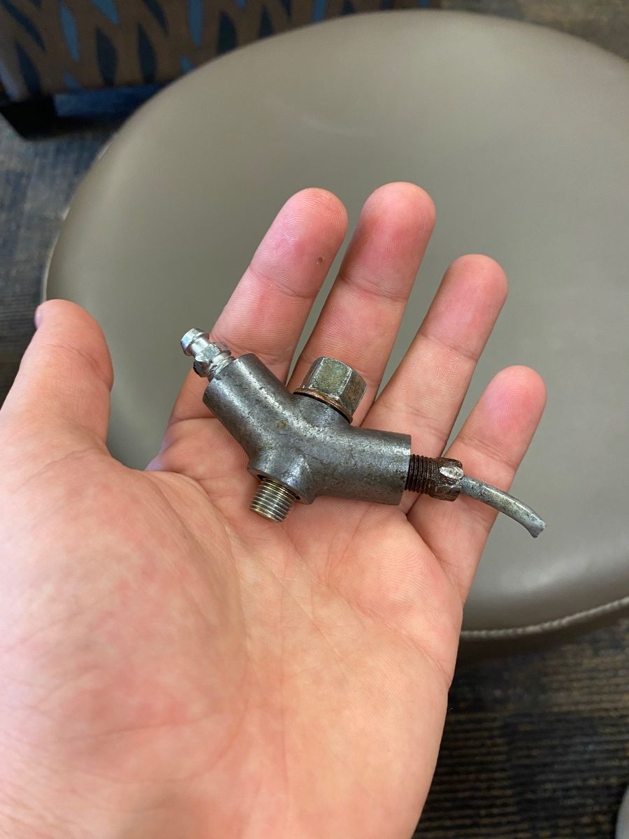

Crusty320 Posted August 28, 2025 Author Report Share Posted August 28, 2025 Good news,I was able to tap it bigger and get it on tight. Bad news I need a new one of theseI’ve replaced one of them already a while ago but I have no clue where I got it or even what to call this.I’ve checked rockauto and didn’t see anything. I believe they are interchangeable up to the 620 but have no clue where to get them. 1 Quote Link to comment
datzenmike Posted August 28, 2025 Report Share Posted August 28, 2025 Looks identical to the 521 and the 620 rear. Quote Link to comment

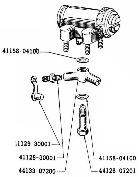

ggzilla Posted August 28, 2025 Report Share Posted August 28, 2025 That is a rear wheel cylinder bleeder or as Datsun calls it a "connector" (the bleeder is on one end) 1 hour ago, Crusty320 said: I need a new one of theseI’ve replaced one of them already a while ago but I have no clue where I got it or even what to call this.I’ve checked rockauto and didn’t see anything. I believe they are interchangeable up to the 620 but have no clue where to get them. Nissan 44133-07200 CONNECTOR with 41128-30001 BLEEDER SCREW Quote Link to comment

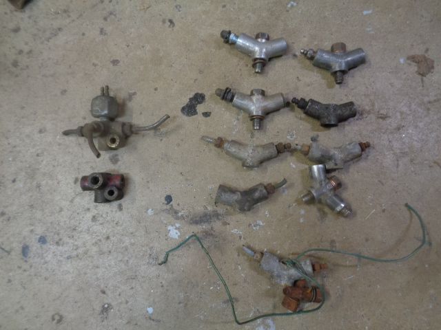

wayno Posted August 28, 2025 Report Share Posted August 28, 2025 I have a few of these around, but they are not new looking. 1 Quote Link to comment

wayno Posted August 31, 2025 Report Share Posted August 31, 2025 I told the author of this thread I would post this photo because I do not know how to post them using URL. 2 Quote Link to comment

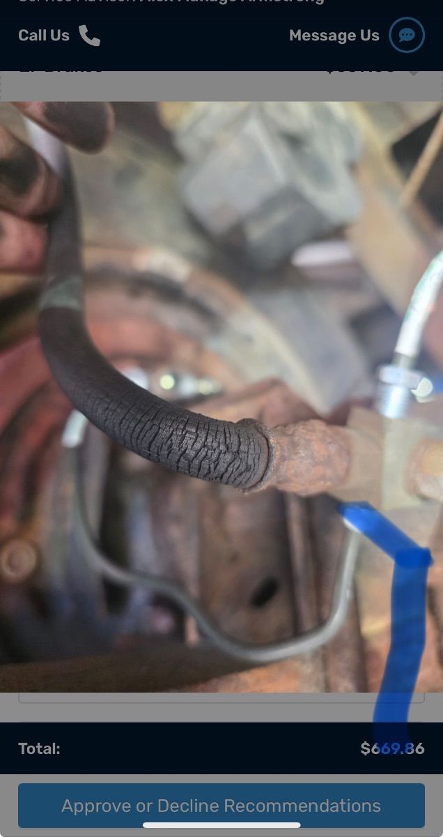

Crusty320 Posted September 30, 2025 Author Report Share Posted September 30, 2025 Just to be a specific I’m looking for the soft lines like this. Im going to ask around locally but I doubt I will find something Quote Link to comment
ggzilla Posted September 30, 2025 Report Share Posted September 30, 2025 Those are called "brake hoses" The lines are generic nicupro alloy lines,, but the hoses are specific to a vehicle. That being said, you can use new a hose from a different vehicle if it is approximately the same length with the same fittings, perhaps 3/8 inch taper thread or whatever the 320 uses Quote Link to comment
Slow Loris Posted October 1, 2025 Report Share Posted October 1, 2025 Pretty sure I got my 521 brake hoses down at Napa, nowhere special. Assuming they are same threading, also probably similar lengths? Quote Link to comment
bilzbobaggins Posted October 1, 2025 Report Share Posted October 1, 2025 Yeah. Shoud be sae threads. Id bet 521 ones would fly. Quote Link to comment
