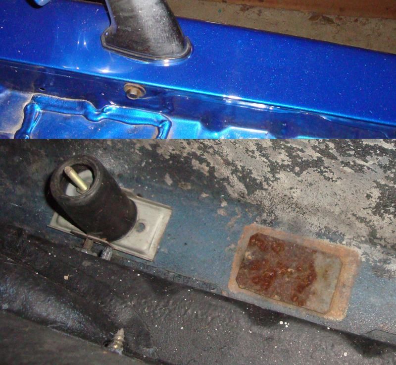

Can't say for sure on the 1200, but the 510 has indentations on the upper frame rail where the mirrors go.  I had a rhd 1200 that had the "flag" fender mirrors, and I can't imagine those fitting without those indentations.
I forgot to mention that you can reach up under the fender and feel along the frame rail for the indent.  I can't remember if it was visible or not from underneath.  It's been a while.

Thanks for the reply. I will get the wheels off and check.

you can see the mounting spot by looking up through the wheel well at the underside of the fender
From the Factory Diagram - 817 mm forward from door edge
Tech Wiki - Mirrors : Datsun 1200 Club
Some choose to mount them farther back on the fender
On my Tokyo-modded 1200 they were 90mm back from the factory spot (724mm from rear edge of fender)
