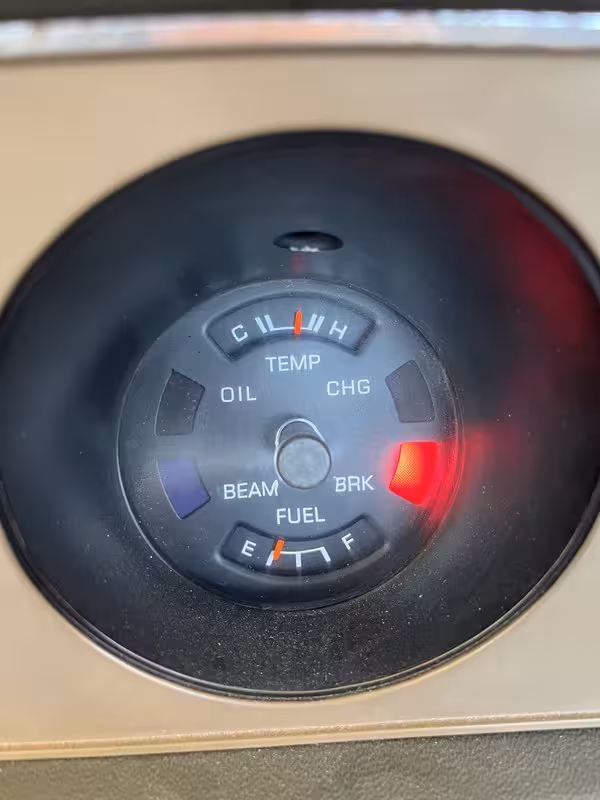

Chance Posted August 8, 2025 Author Report Posted August 8, 2025 1 hour ago, NC85ST said: If you’re still having the issue described in the beginning, running hot, whats a normal range for the gauge to be in mine gets to like 75% then stays there. Quote

datzenmike Posted August 8, 2025 Report Posted August 8, 2025 Mine ran just above 1/2. Maybe a needle width below yours but just barely noticeable that it was above 1/2. Quote

ggzilla Posted August 9, 2025 Report Posted August 9, 2025 According to Datsun owner's manual: "the engine will run satisfactorily when the pointer is at any position in the middle range." However, if the temperature is smack in the middle in winter, and only goes higher on hot days, it means the cooling system is not keeping up. The factory radiator was just big enough when new. The A/C equipped rigs had a bigger radiator. Better to fix it when you have a chance (with a bigger radiator), it will only get worse 7 hours ago, Chance said: whats a normal range for the gauge to be in mine gets to like 75% then stays there. Quote
NC85ST Posted August 9, 2025 Report Posted August 9, 2025 Is this truck fairly new to you? The only way to really know what the engine temp is, is to have a mechanical gauge. If the temp stays where you’re showing, even when pulling a hill, I wouldn’t worry about it. If it starts going up every time you’re putting more of a load on the engine, then you need to think about upgrading the cooling system. You’re brave to drive that truck in a 110 degree heat. I wouldn’t even leave the house. Quote
datzenmike Posted August 9, 2025 Report Posted August 9, 2025 This is fine. If 110 out, then it's expected to be slightly higher. If the cooling system is working you should be able to drive in 110 heat. An infra red hand gun will also lay it what the temperature really is when idling. Just 'shoot' the thermostat cover. However in extreme heat I would pay more attention to the cooling system, same as in extreme cold. Anything wrong, fix right away. Always run 50/50 distilled water and anti freeze. Fan belt tensioned and inspect for damage Fan shroud ON the vehicle. It increases fan efficiency. Radiator clear of obstructions to air flow. Also inspect the inside for 'kettle scale'. Not a problem if you use distilled water. Inspect hoses and clamps. Look for soft hoses. Hoses rot out from the inside our, look fine on outside. Buy the special rad cap and install a coolant recovery bottle. Wrecking yards are full of these containers that might fit your truck. Collects any coolant expelled in the heat and when cooling down it returns it to the cooling system. Inspect the clutch fan for excessive slip. More slip = less air through the radiator. Quote
