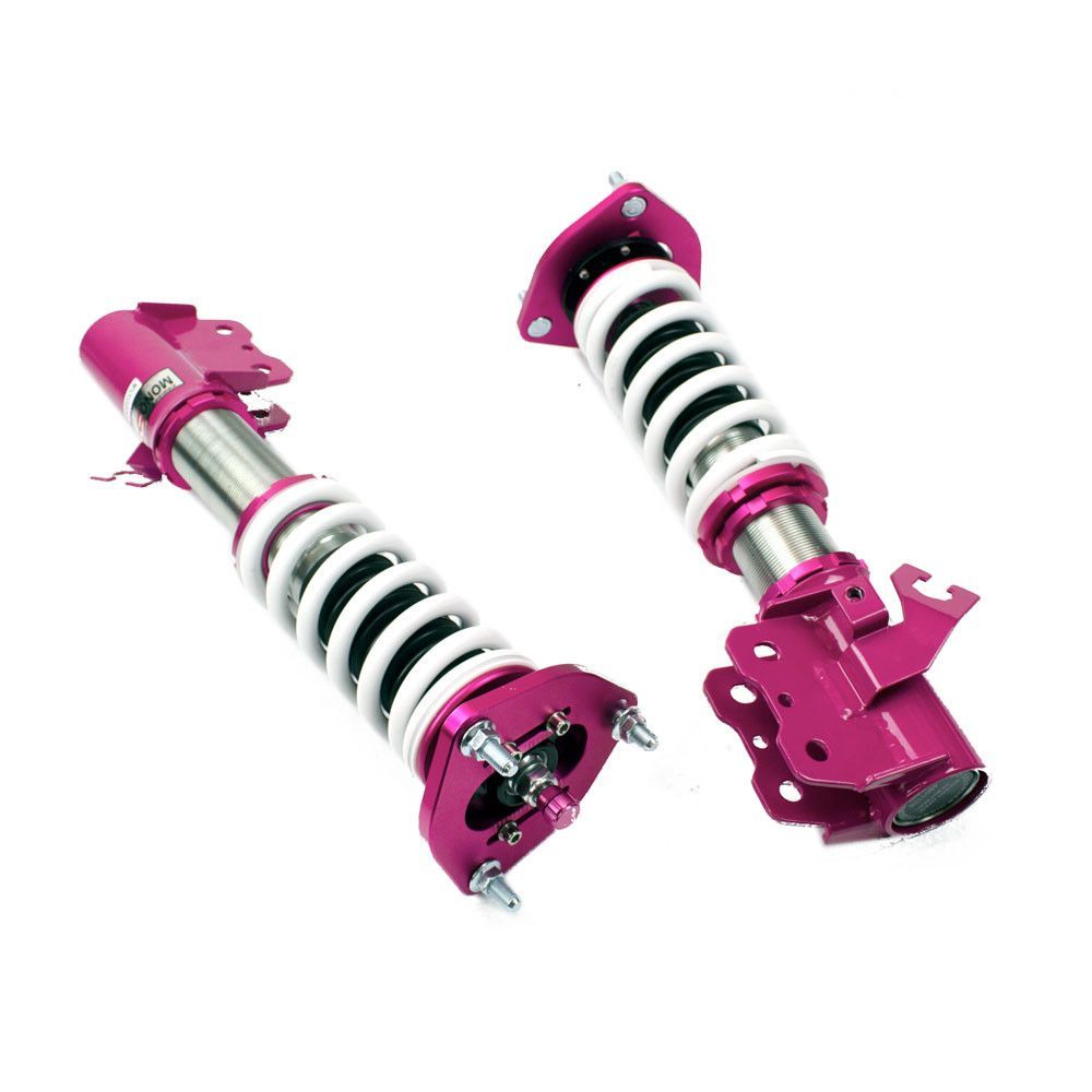

ggzilla Posted July 25, 2025 Report Share Posted July 25, 2025 If these are "coilovers" (actually they are new strut assemblies with springs), then no they won't fit the 510, as @fiveoneO said the lower mount won't bolt to the 510 Godspeed MonoSS Coilovers for S13 240SX Quote Link to comment

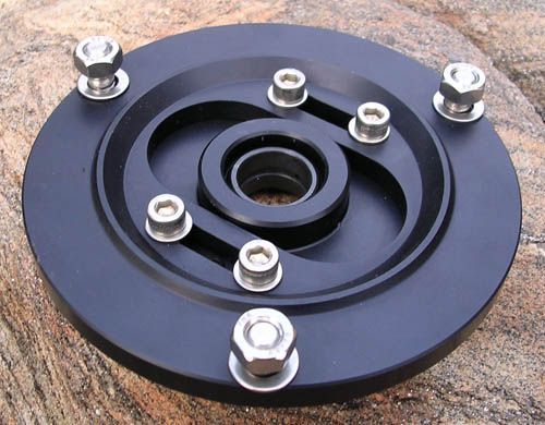

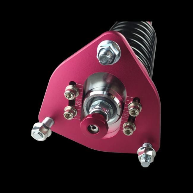

ggzilla Posted July 25, 2025 Report Share Posted July 25, 2025 This coilover kit for 240SX will fit the 510 struts and the 200SX struts Will that disc-shaped top hat work with the struts? Dunno, but it's not adjustable for camber or caster Adjustable top hats for 510 look like this: 3-bolt mount camber-adjustable top plate. The stock 510 top plate is not adjustable Quote Link to comment
datzenmike Posted July 25, 2025 Report Share Posted July 25, 2025 The 710 top hat is off set sightly. By turning it you can select more or less camber. I guess caster would also be changed. Quote Link to comment

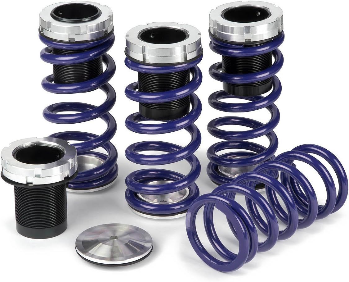

datzenmike Posted November 22, 2025 Report Share Posted November 22, 2025 The original poster came back the next day and never returned. For way less that $30 you can make the stock strut adjustable for height and stiffen the spring. Quote Link to comment
