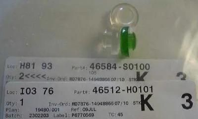

As we are walking away we notice that the brake-lights are on.
The brake pedal stopper has probably broken, it's the most common cause of brake lights always on
The pedal doesn't pop up, there is a spring on the pedal to keep it up
There is usually a rubber bumper that the brake light switch is adjusted against. They are glued on or for what ever reason has fallen off and the pedal no longer opens the brake light circuit. Scotch tape some pennies on the pedal for now.
Not a short, all wires are protected by fuses, a short would blow a fuse. What you have is a draw, something using power like the interior light on. The spark when disconnecting the battery cable is obviously because the brake lights are on.

 Take note of the canister labels and go to a wrecking yard and get any other one that matches.
I have used a nickel with electrical tape, and another time a quarter with duct tape
1986 Hardbody uses the green one. It snaps into the hole on the brake pedal. It was originally designed for 1969 Datsun 1000. The clear one is less expensive and fits the same hole
Green: Nissan 46512-H0101
Well, I went out and looked.  You are all right, the bumper is missing.

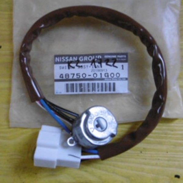

Mike, I don't think that will do anything for me.  The problem is not reduced voltage (I think, I didn't measure it, I just saw my test-light flash, brightly).  But an intermittent flow of amperage.
On 7/23/2025 at 2:19 PM, Stinky said:
When you turn the key to "Start," the wire to the solenoid makes my test-light flash for an instant.  Most of the time, it won't even click the starter as it is that fast.  What might cause that?  Gunked up Ignition Switch?
When we jump the solenoid, it cranks fine
I've seen this more than once with a Nissan. Jiggle the key, and it cranks fine, but turn it all the way clockwise and it don't crank. Turn it just back from all the way and it cranks. If this happens with your rig, the ignition switch is bad. It unbolts from the back of the key cylinder
In this case, a relay won't fix the problem
1986 D21 IGNITION SWITCH
Jumping the solenoid (jamming a screw driver beween the large and small terminals) bypasses the IGN switch. The starter solenoid is an electro-mechanical relay. Adding another relay might help if the contacts inside the ignition switch are gunked up, but doesn't totally resolve the problem, rather it bypasses it at the cost of adding more parts and wiring
