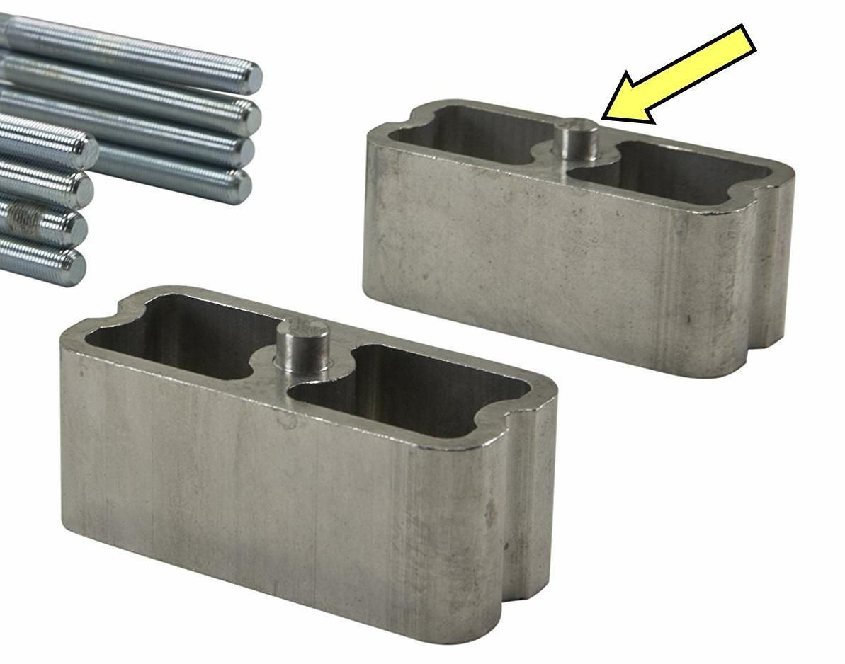

banzai510(hainz) Posted July 30, 2025 Author Report Posted July 30, 2025 Well I swapped the Japan made rear wheel cylinder in after replacing the Parking brake cables that were broken for years. I was short about 1.5 inches so I made a plate and put 2 bolts thru them and now they seem to work( a small turn buckle was still too long). On final inspection I notice my Belltech lowering blocks were off like a 1/4 on rear driver side. I said fuck Im tired of crawling around around. Said Fuck it I ordered another set of 3in 2deg Belltech part# 6202 blocks. While waiting for those I took the blocks off to find the pass side stub was sheared off and the driver side almost sheared off. So on 521s always do a inspection of these parks and grease the Kingpins and driveline Quote
ggzilla Posted July 30, 2025 Report Posted July 30, 2025 Do you mean this pin was sheared off? I wonder if the locating pin is replaceable, but how would you get it out? Quote
banzai510(hainz) Posted July 30, 2025 Author Report Posted July 30, 2025 yes it was sheared off the other was just hanging on like a hacksaw was cutting it. guess axle was moving around and stressing the pin. Instructions say 80pounds for torq on the bolts/nuts(should always ck these every year anyway. doesnt seem the pins are steel but cast. I have to look again before I throw them away I bought new blocks fits perfect now. Quote
